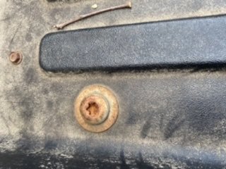

    I have a bed mat and rarely see mine. However, I will say this. The real culprit is not what you see...but rather what you don't.
    If you haven't done this....do it. Get a torx bit and remove them one by one and apply some grease or antiseize. If you have an older one and live in an environment with lots of salt use it may be too late

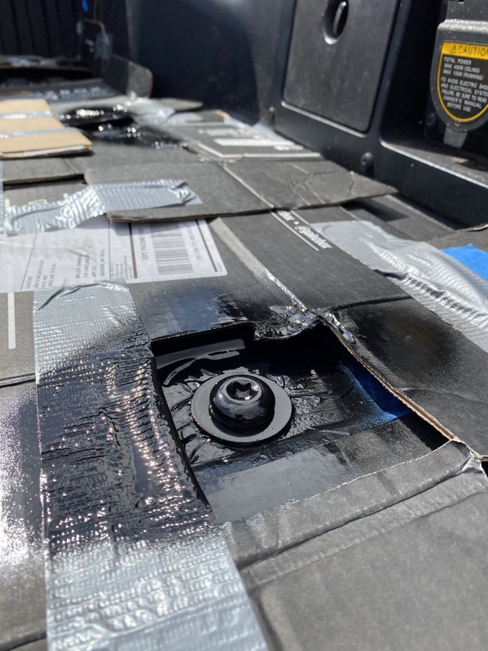

    Hey OP and other guys doing this. When u clean them up with the brush do you use wd40 or anything on it to help with the clean up or just straight dry brush? Looks like a good weekend job

    Paint will not stick and fish eye if there is any WD40 or similar lubricant used on them. Hit them with a wire brush and some type of degreaser and let it dry, that’s all you’ll need before paint.

    Like gunk brand engine degreaser ? Does the paint need to be enamel like the products the OP posted in his picture ? Want to get the right kind and don’t know much about paint and metal. Will prob also throw a bed mat over the job soon lol

    You will only need degreaser if you wipe them with some type of lubricant or they had contact with something. If not just scuffing then and wiping them with a clean rag or blowing them off should be fine. Enamel will work fine. Anything that will adhere to metal.

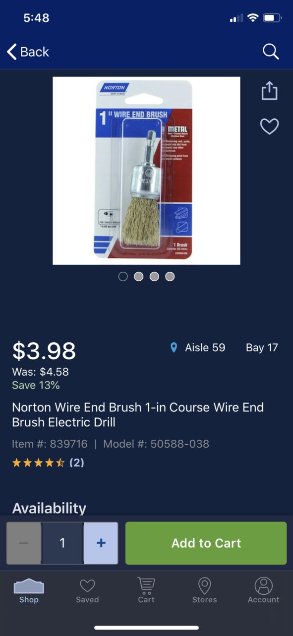

    At Lowe’s and trying to find the 3m coarse sponge for metal and can’t for the life of me find it. Asked an associate who was kind of a dick lol. Anyone have a link or any tips on where to find ?

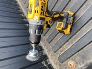

    Use the app to try and search for it. Make sure you turn on so it’s only searching for stuff that’s in stock at your local store. If you find it and click it it will show you what aisle and bin it’s located in
    Something like this wire brush will work good. You can attach it to a battery drill and have the scuffed you in a few minutes. Take note of how it shows you the aisle and location. Your store will vary so check the app and see what they have and where it’s located

    Yeah I’ve got a full wire brush kit and the attachments for my drill just thought he said that coarse sponge did a better job for him. Hell I bought a bed mat last night also with a super deal so I just wanna touch these daddies up slightly before I cover them up for good haha. Figure it’ll be a little fun weekend project if the rain can hold off haha

    How long do u guys wait in between coats on this ?

    And how long before doing the clear over the black? And in between clears? Thanks
