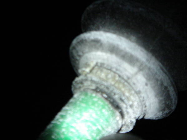

    Here are pics of mine. I am running OME 881 with bilstein 5100's at middle setting. I went from 34.75" to 37.5" on drivers side, passenger side was about 35.25" now it is about 38". Its only a week old, so don't know how much more it will settle. I had some grease coming out of the inner/upper cv boot on passenger side. The mechanic told me that there was to much grease in there and with the change in the angle he thinks it is just forcing out the extra grease. There doesn't seem to be an excessive amount, so I am will wait and see. The noise and vibration they said was from the front end being out of alignment which I knew was a little out of alignment before the install. Here are my pictures of the CV's
    Passenger Side
    Passenger Side Inner / Upper Boot
    Drivers Side
    Drivers Side Inner / Upper Boot
