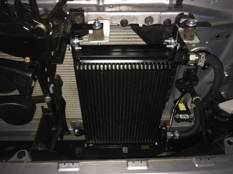

    I pull a 4500 lb travel trailer with my Tacoma. I also have a scan guage. I installed a Derale 52506 and got a solid 30 degree drop in transmission temperature. I pulled my camper 100 miles last week in 100 degree outside temp through some steep hills and my temp never got over 168. Before It would reach 210 sometimes in heavy stop and go traffic. The derale stacked plate Derale 52506 has a cooling rating of 46,000 btu's per hour, the highest cooling rating you can get to fit in the available space you have. All I had to do to make room for it was move the horns to the center brace and did not have to change the wiring.IMG_2853.jpg

    I put the Durale 52506 in my 2015 ACOR today. Haven't hooked the trailer up yet, but it seems to run a pretty steady 135-145 on my Ultra Gauge running around town in 80 degree weather. It would frequently creep up to 200 before at a stop light, somebody should come up with a bullet proof setup for electric fans. The install looks pretty identical to Scottfarm's, took a couple of hours, and most of that was trying to decide what I wanted the brackets to look like. I ended up using a little more than a quart of new fluid, had to open the 2nd bottle (buy 2!) and put another 6 or 8 pumps in out of that one. The hot exhaust piping is a bit of a bear, but other than with the right tools it's easy.
