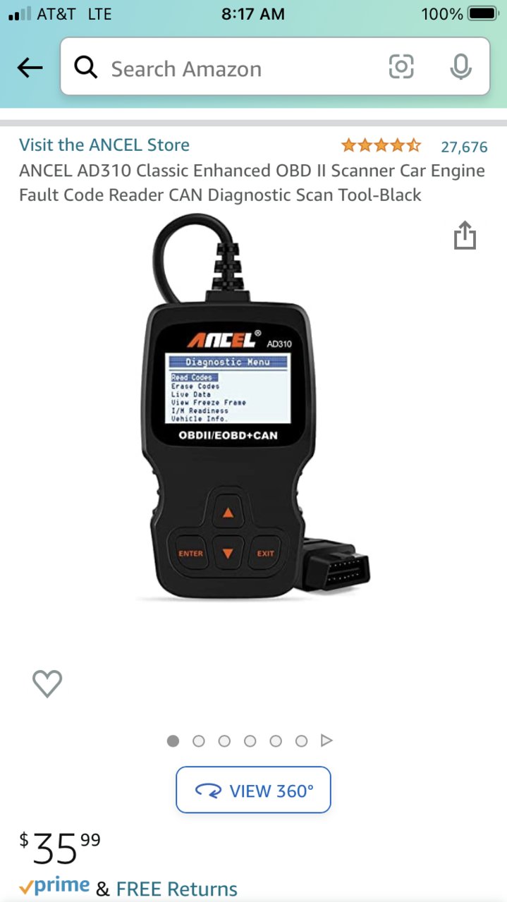

    What are you using to scan for codes ?

    This is what I’ve used, and before I got it 2 different advance autos scanned and got the same code.
    I will say it misses much less frequently now after the new sensors, made a pull to redline last night with no hiccups. Before this it would miss probably 8 times out of 10 at WOT above 3500
