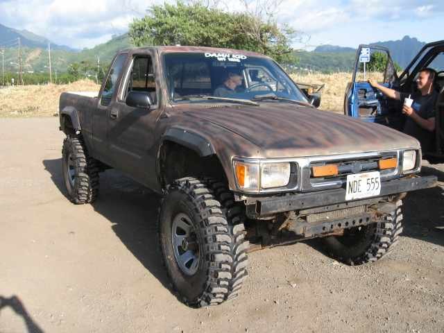

    A lot of the height depends on the wheel width. Look at the charts on the tire mfg page and it will list what width rim they used to measure. If you use a narrower rim than listed it will be taller than listed, wider shorter.
    Here is an extreme example.
    287953d1171465108-skinny-bogger-small102_365e9f4c3be3dfc3b318cbba65b7fcd8c16ce418.jpg

    I just threw up a little in my mouth.
    I am hoowever impressed that they got those tires mounted and the bead to seat. That couldn't have been easy

    Was thinking the same thing myself. To each his own but I think it looks ridiculous. I would expect it wouldn't take much to blow a tire off the bead wheeling.

    Hawaiians man...

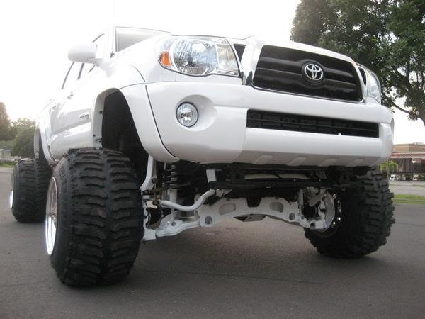

    So thats why maybe ibe been hearing such different numbers on tires... is the white taco on new style of LT? :) cant make up my mind on tires, when steared 90% or to lock how much clearance do you still need about for the give in the suspension bushing?

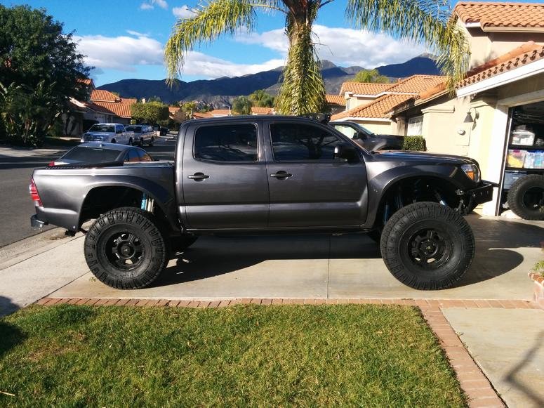

    I'll let you know how tall my 37's (Super Swamper Vortracs) are later today when I get them installed (w/ pics). They claim a true 37".

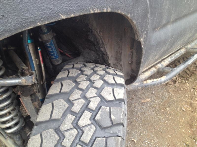

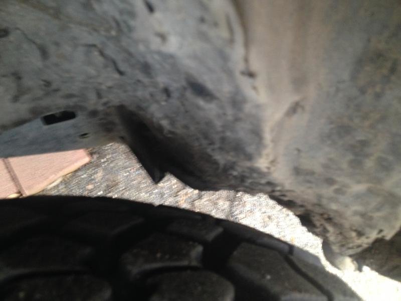

    Cool... can you snap a pic of the tire turned into the cab mount??? Ive only gotten one post on here, not sure if there arent too many guys on 37's or nobody wants to share their secrets :/
    I have my chop done as good as its possible considenring I turned the rubber mount mounting bolts but i still dont think i have enough on the mount. I have about 3" in the firewall after i chopped it back but the mount is what limits it still

    Here are some pics. Obviously, I'm wider than you, but it might help. I also don't have steering stops like stock, so I can turn much tighter than you, and you also don't have tubing welded all over the frame but you get the idea.
    F7DC9009-1CAB-4740-8619-A98ADEA9631A_zps_d0804af64d42b4fa1644a0b582c41e46554434f2.jpg
    9AD25AF8-679B-459A-AAF1-819E0AA5608F_zps_9e53ac57655917bc48f47d3d5ee9d2f9263270d7.jpg
    9FC70861-9B8F-4112-87D7-BB79853E2C13_zps_e61eccabc4a512b06e95aa48e9e8e1384f66d2c3.jpg

    IMG_20150131_152005.jpg 37's are on... I'll give u some pix of what I chopped tomorrow.
