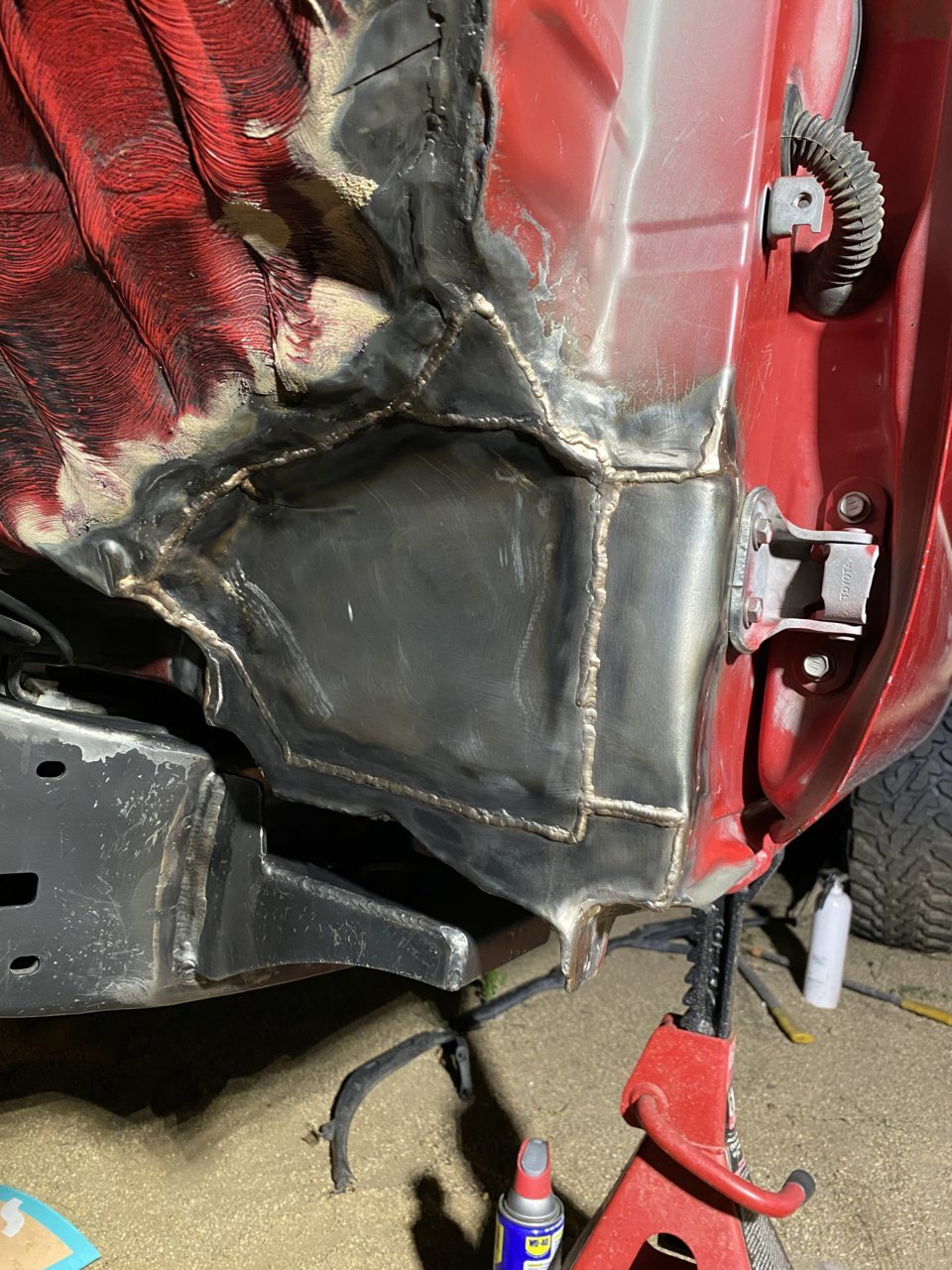

    Finally done with welding.

    that’s all it took to not rub?

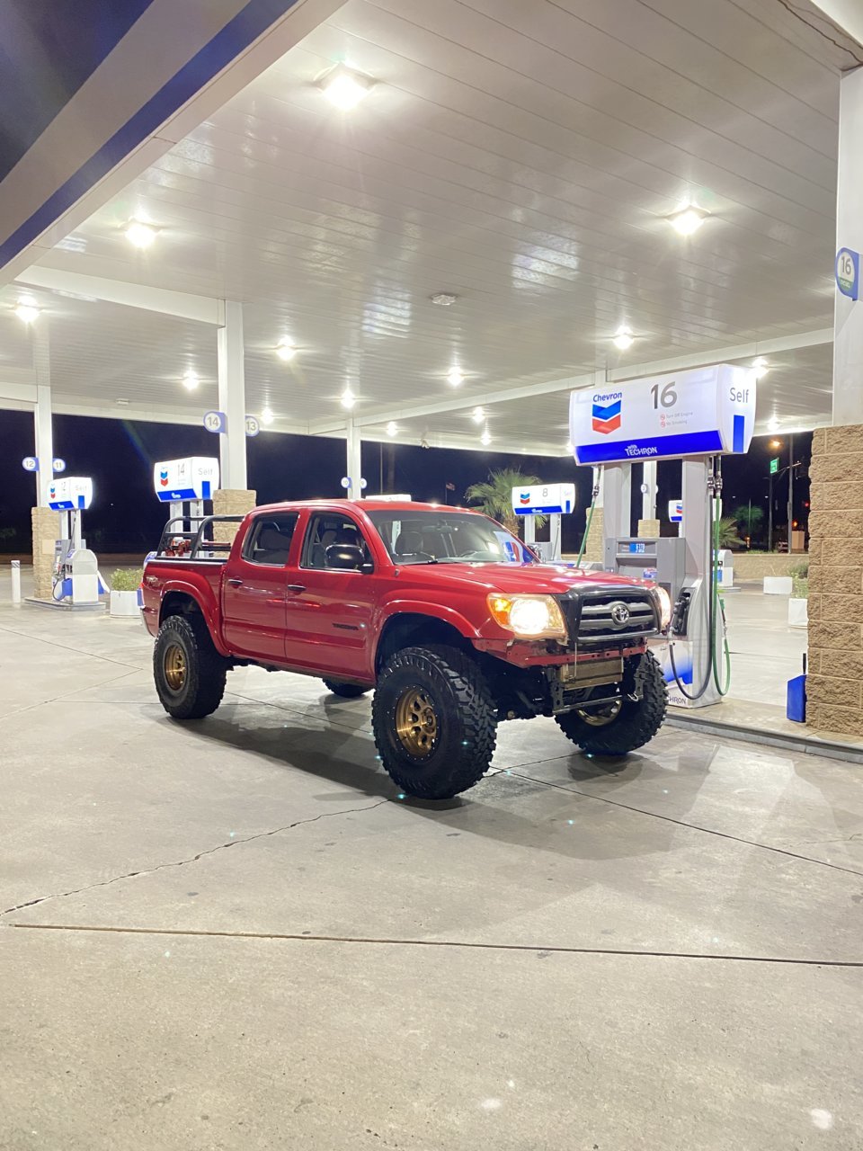

    Jun 17, 2017
    #221753
    207
    Phoenix,AZ
    2005 Radiant Red Tacoma Sport

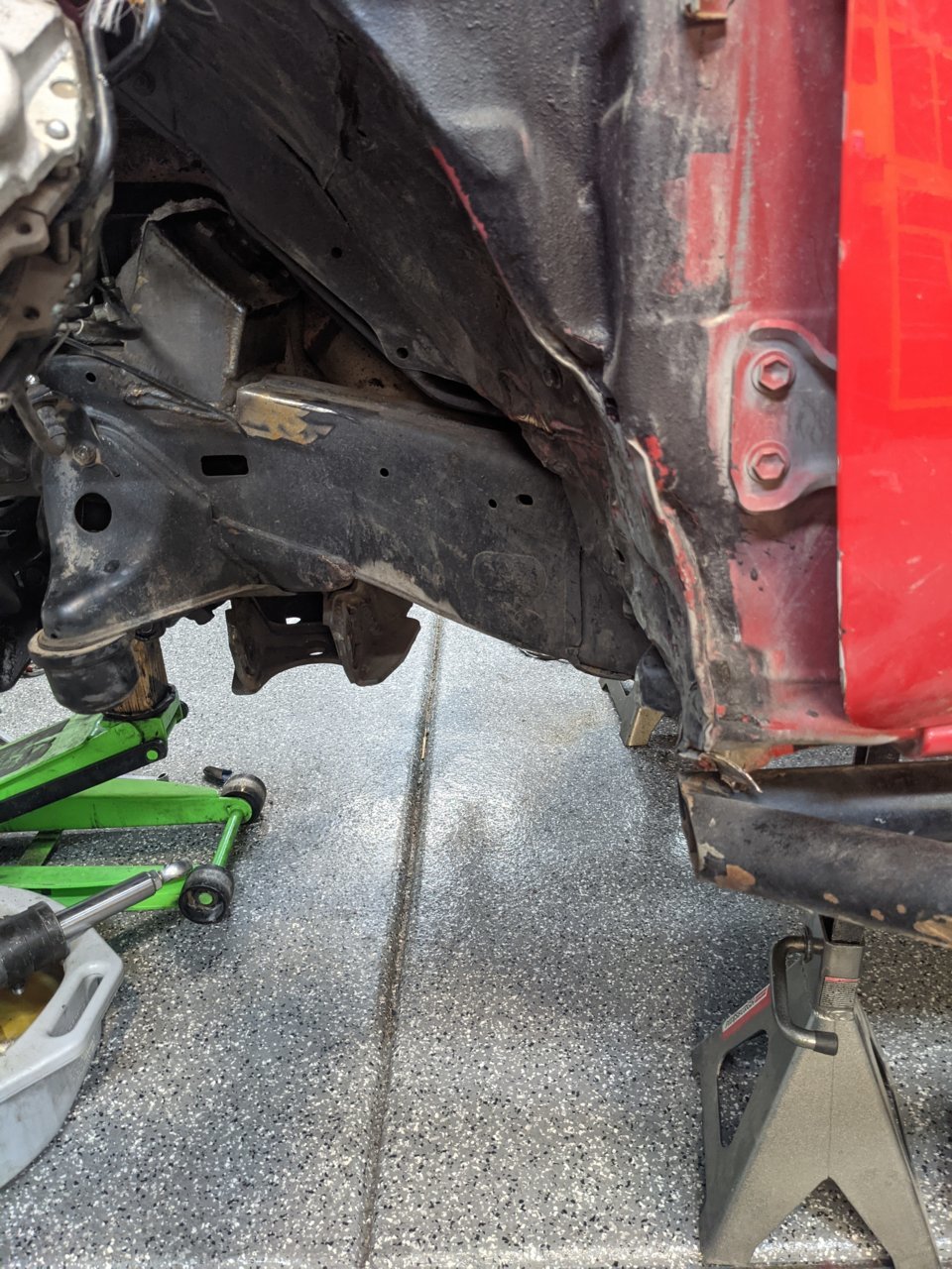

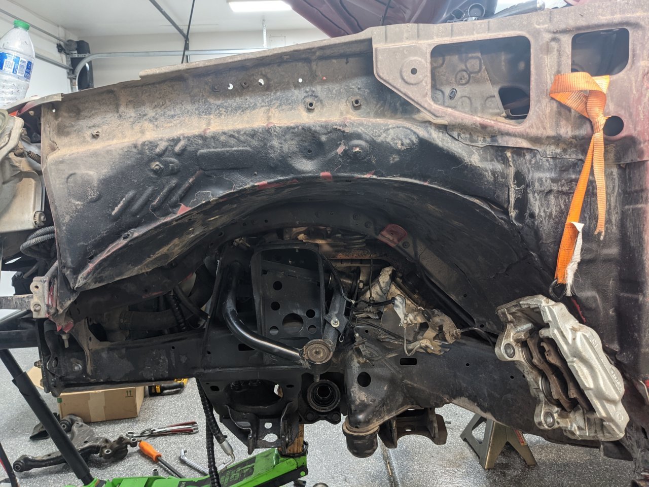

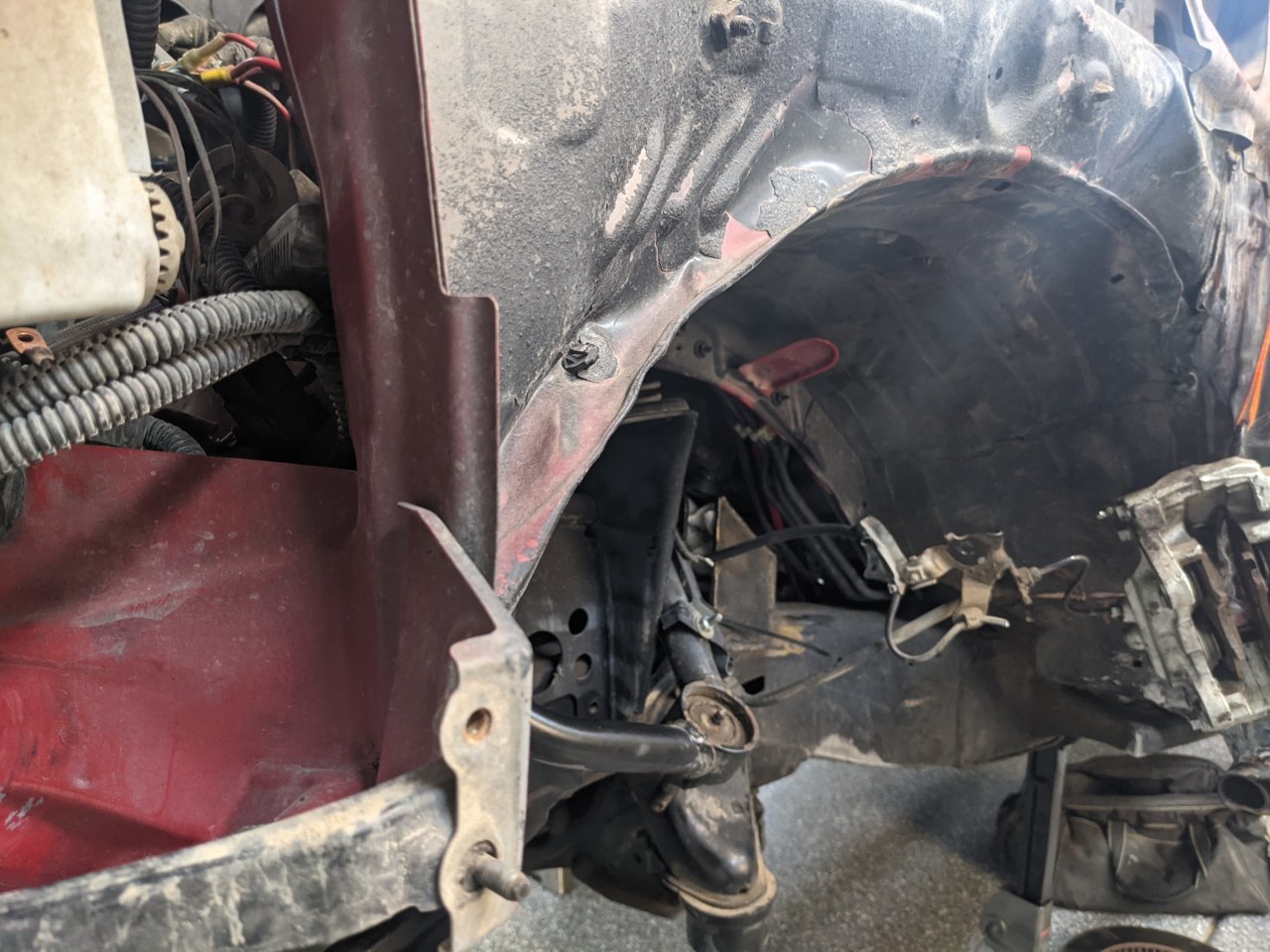

    Heres a few pictures of what it took me to fit 37s with all the stock sheet metal. This is factory width, -38 17x9 beadlocks on bfg 37 krawlers. Alot of hammering, and it still rubs.

    Was anything cut out or was this just hammered

    Cab mount was cut out and relocated. Sheet metal was just hammered.

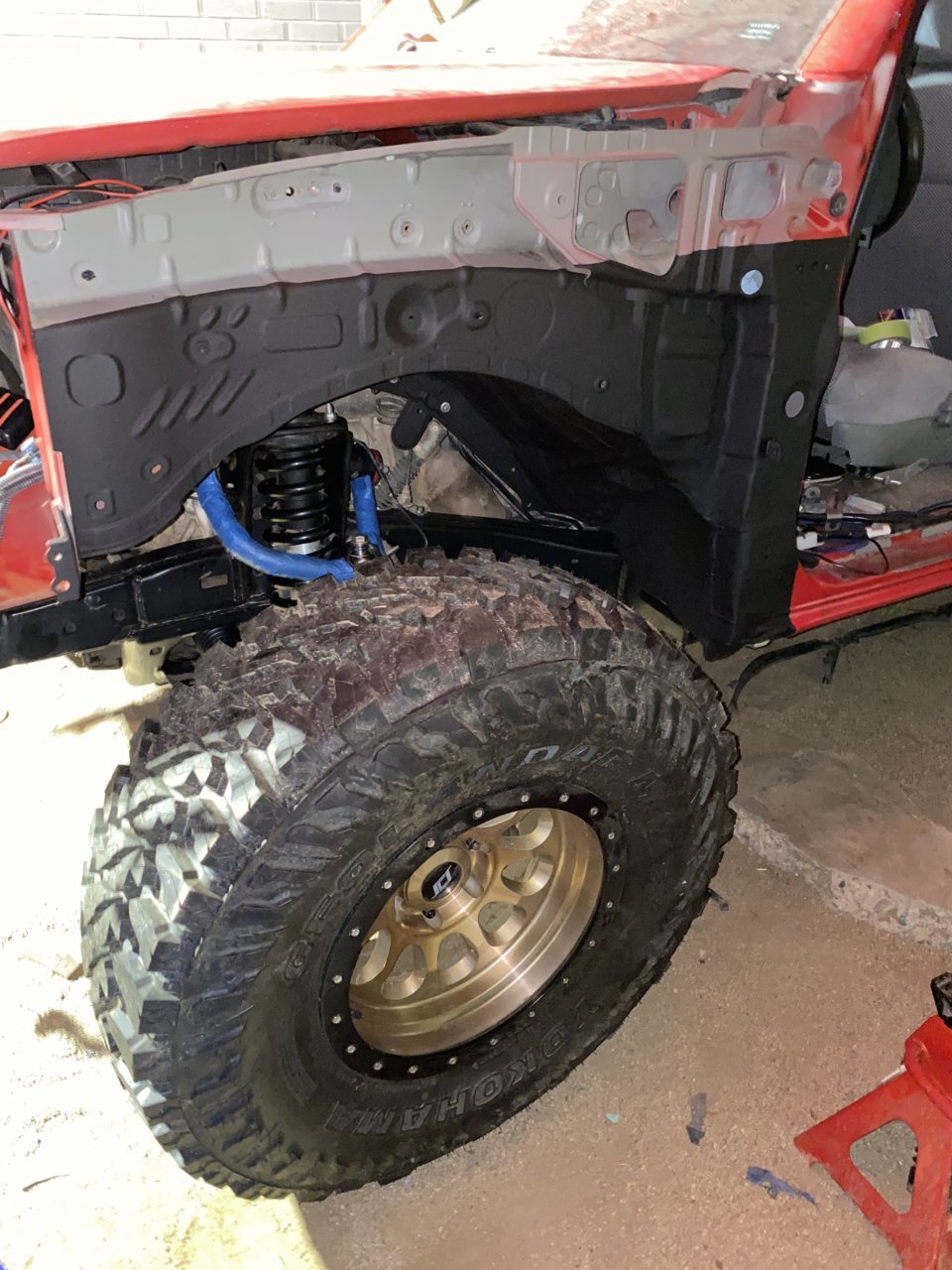

    Here is mine. My goal is to have no rubbing with my 35s.

    looks like you getting ready for 40's
