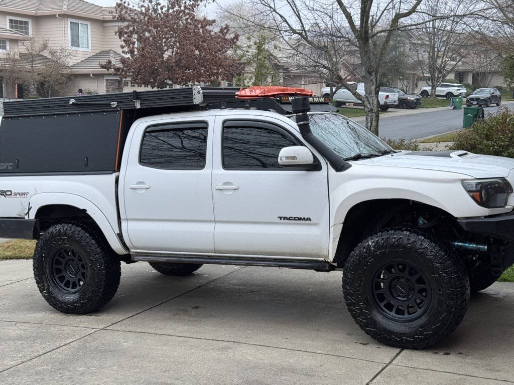

    Going to be buying a set of 37s next and have a wheel question…
    for context, I’m currently running a 3.5” long travel up front, JD fab pivot kit set all the way forward and I’ve heavily tubbed… if that won’t fit, nothing will.
    My current wheels are 16” SCS F5s with 3.5”/-25 backspacing/offset. I’m looking at going to new 17” wheels, either method beadgrips, or icon rebound pros, but both only come with 0mm offset options.
    For this of you with 37s on the truck, did you need the backspacing? I’m hesitant to run spacers. Let me know what you think.

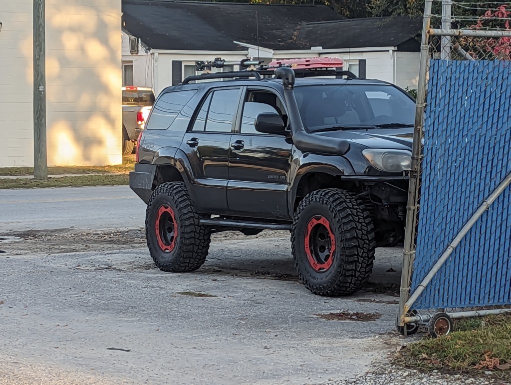

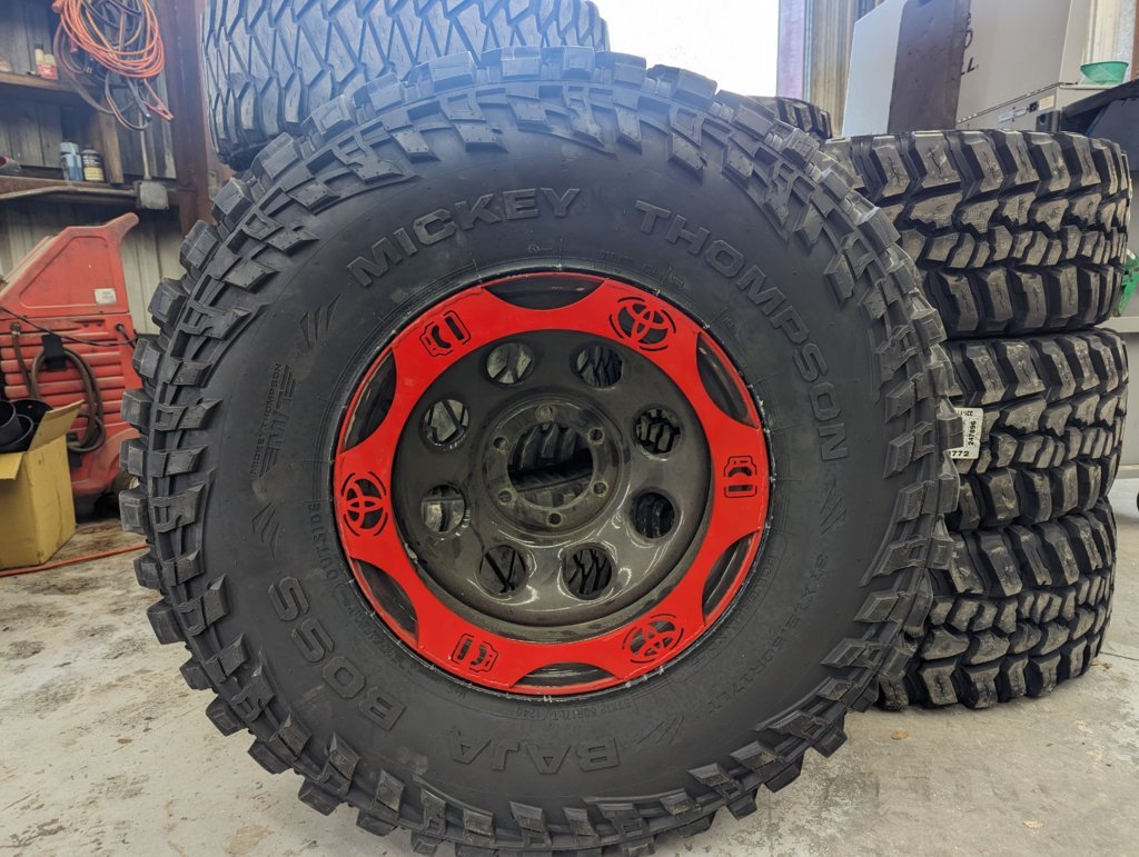

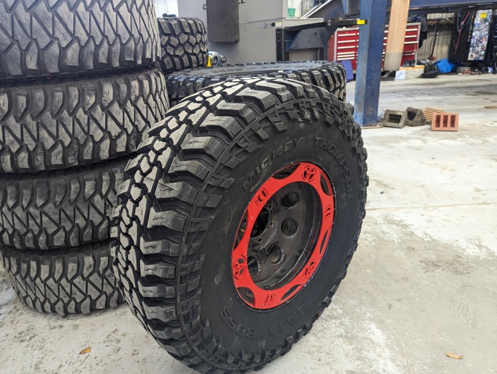

    Also if anyone is interested and local to south Carolina. I'm selling my Mickey Thompson Baja bosses mounted on 17x9 pro Comp steel rims with weld on Rock rings Toyota Chevy bolt pattern. They have less the 300 miles on them $1800 PXL_20231106_122244218.jpg PXL_20231106_122250715.jpg PXL_20231120_123336991.jpg

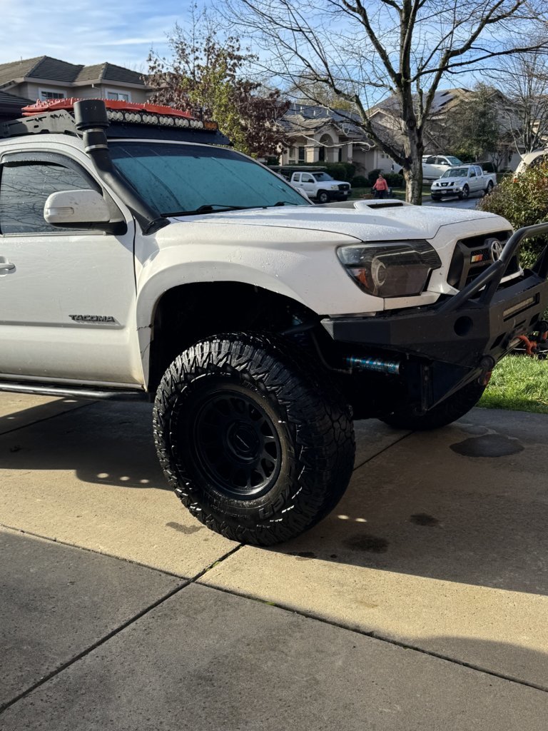

    Got everything bolted up today with the 37s, still learning how to walk since I'm clearly packing so much heat down there now. :rofl:
    Went from SCS F5s with 3.5" BS/-38mm offset to Method's with 0mm offset. I was surprised they fit with no rubbing and no wheel spacers, still deciding if I want to run wheel spacers to get close to where the tires were before the wheel change, so I have some suspension cycling to do.

    Once you start cycling the suspension, the one thing I will say and I have noticed on others with the 37s is you probably have to do a cab mount relocation and a mini firewall tub . And that's all needed for articulation while you are turning your wheels. I know I'm the OPs truck That's what he had to do to get full articulation. He also getting 1 in body length and had the trim fenders front and rear

    Luckily that’s all already done. Body mount relocate, front is also moved forward an inch with JD fab lower arm pivot replacement, and tubbed out at the firewall and inner fender.

    Good to know, I have the same SCS wheels and I’m afraid with that much offset it’ll make clearing 37s even more difficult. Glad to know +0 offset still clears UCA and frame. Running spacers/offset will make wheel have more radius arc.
