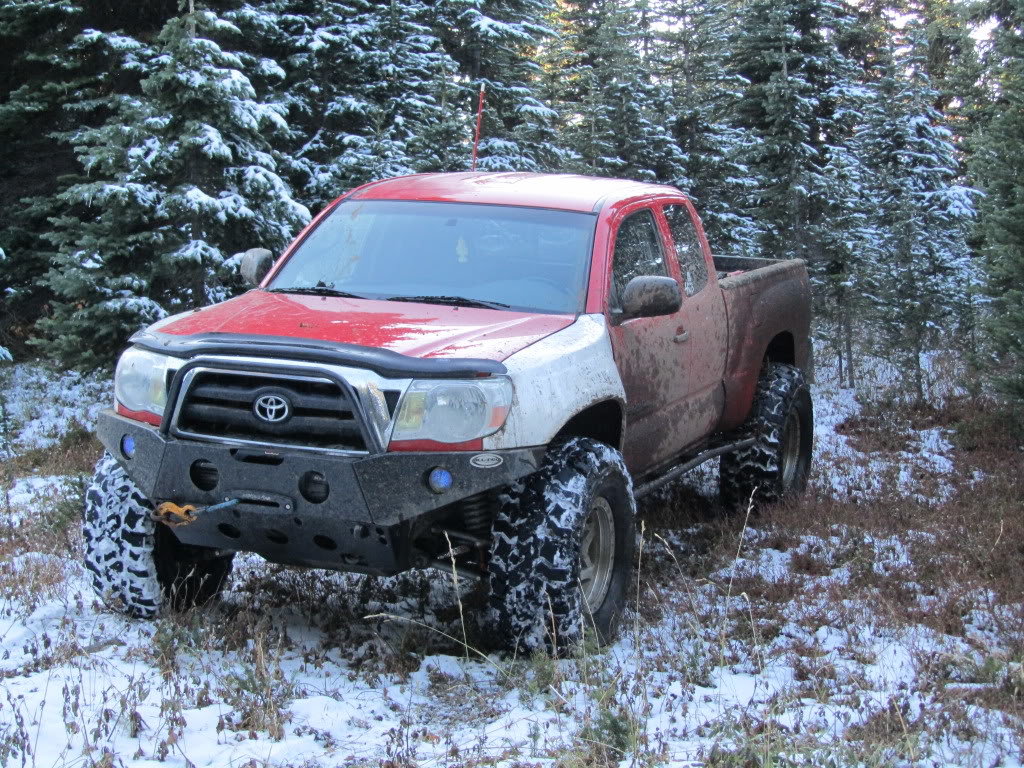

    Thanks for the pix.. obviously your truck is set up with LT and got alot going on! Its hard to tell. What do u have +2? What offset you have? I cant tell if you have the stock body mount

    Great pic :thumbsup:

    +3.5" TC LT with 3.5" BS wheels. Also .5" spacers, so effectively 3" backspacing. In a lot of ways they would be easier to fit on a stock truck. The extra width makes the tire swing in a wide arc when you turn. (Edit: Stock body mount, chopped up)

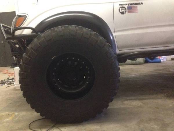

    Dang 37s w.ould look sexy... :drool: [​IMG]

    Lucky.... These make my 33" km2s look so lame

    Man youre wide! you have +3.5 lt plus 3 backspace. Im gonna see monday finally if I can fit the 37 km2's I ordered. I have 1.5 spacers and 4.5?? I think backspace wheel

    I think it is around 90" wide outside of tire to outside of tire. I don't know what stock is to compare.

    Dat body/bumper flex doe

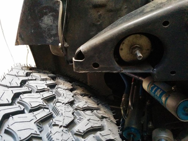

    IMG_20150201_094915.jpgIMG_20150201_094900.jpg...it clears at full lock. Only problem I might have is rubbing where my fiberglass connects to the wheel well near the front bumper due to the gobs of up travel I have. Overall not bad for a true 37 inch tall tire.

    Great pictures.. what offset you running? Running LT?
