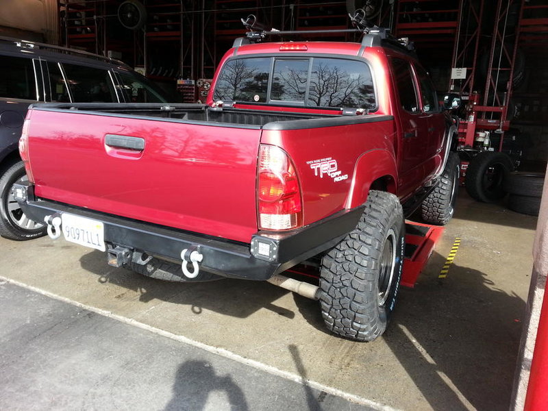

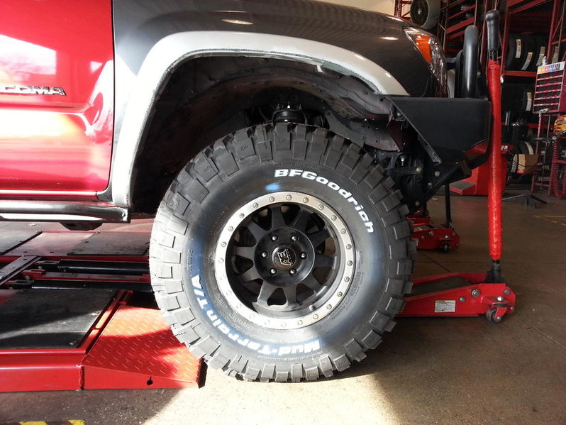

    Im so excided, Im getting my 37" bfg km2's put on, I habe a lot more room than I expected @ 3" front and 2" rear lift

    I have about 90% steer till I massage the body mount a little more :)

    Looks good clupi. Might wanna relocate the spare and cut the tailpipe back if you wheel it though. Just saying, nice looking rig man.

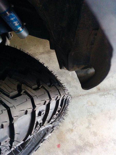

    + a tubbed firewall?
    Edit: sharing a photo hope that's cool

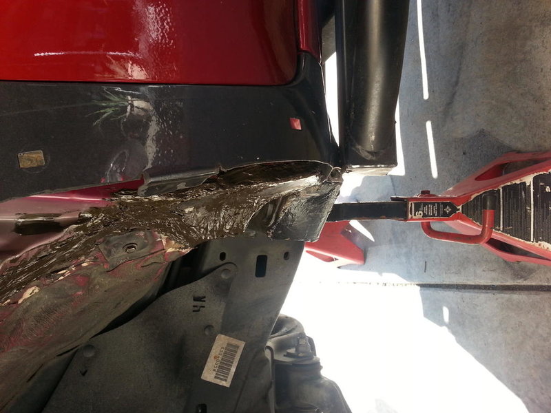

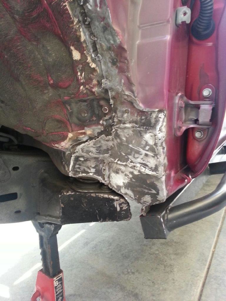

    Yup, from the botom I took off 3" including the pinch weld and gradually toward the top of the pinch weld took off 1" came out great. The only think I still need to work on is a little more off the boddy mount! Once I work on it some more off the inside edge ill post some pictures. I got a great way to chop the factory body mount to clear 37's. It includes rotating the rubber mount to get the bolt out of the way
