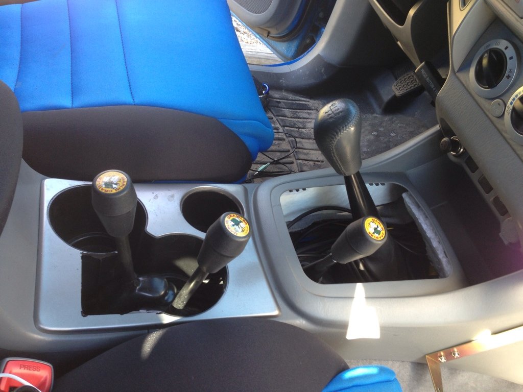

    I picked up a bunch of front OEM shafts from various wrecked tacomas for around $100 each. As for the rear axles, they are even cheaper, there's a guy by me selling a whole axle assembly with both shafts and the elocker diff for 250. Anybody who upgrades to bigger axles sells these wimpy 8" ring gears for cheap since that's what they are. Only problem with the rear is if it's got alot of miles you should change the rear bearing which is a pain in the ass and you need a press and a "SST" aka various scrap metal adapters on a 20 ton press.
    Just keep an eye out on your local craigs list ads
    http://cnj.craigslist.org/pts/4869865971.html
    How do you need a rear axle shaft? I've been pretty rough on my truck over the years and never once had trouble with a rear axle shaft. If anything the R&P will go before the shaft. The key is hitting trails slow, having double low in the transfer case really helps to control the throttle with larger tires :)
    EB69C01D-61E8-4C04-A89F-15DF66C25FE5-695_b6775d1c740bd4bf51c114e722256997f51b81a1.jpg

    Looking good!!

    Oh and also, that picture has so much sex in it :drool: What's your opinion on me just swapping to an FJ Transfer case for now? Like not going twin stick yet...

    Yeah that may work but the press is much easier and you don't run the risk of damaging the splines.
    If your stock transfer case is working fine there isn't much benefit to swapping in a stock FJ case. If you install the twin stick you could get a true 2-lo gear though. If you plan on doing it might as well do it once while everything is apart, twin sticking the case isn't too hard.
