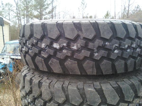

    I ran the goodyears for almost 50K miles without a single flat. To put it in perspective, I destroyed 9 KM2's in the one year before I got them and destroyed several rims. Military tires are tough, and built on the same carcass as race tires. They did have a pretty hard rubber compound and not much traction on icy roads. I just got a replacement set of BFG baja's and had them grooved from TWF. They do very well, and feel like a similar compound and performance to KM2's traction wise, but with a heavier carcass. Did I mention they are heavy? 150lbs per corner heavy. ARP wheel studs are required. They were almost brand new, for $200 a tire. I bought a lightbar from him and also got free shipping. The cool thing is I swapped the tires myself. No tire machine needed!
    579C120C-7AEC-4911-A91B-1968C4A2081B_zps_7e45b19143472783e5add08169b28a67cfa46118.jpg

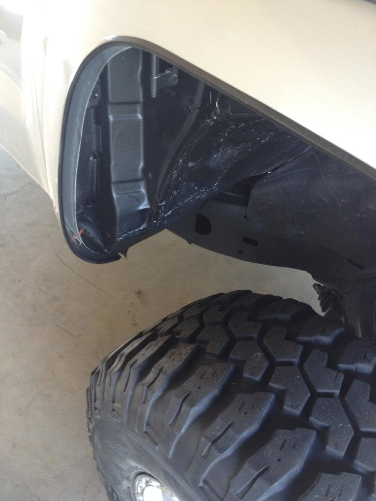

    Anythings possible... Just depends on how much you want to spend, and the balls to start cutting. I have 36" Iroks, and could easily fit 37's. I did a 2" body lift with my 3" camburg coil overs. I also moved my body mount back about 4", and cut the firewall a bit. I also took about 3" out of my fenders.
    If done all over again the only thing Id consider doing different would be the body lift. I think I could fit what I have with only 1-1.5" body lift.
    EnumclawTaco likes this.

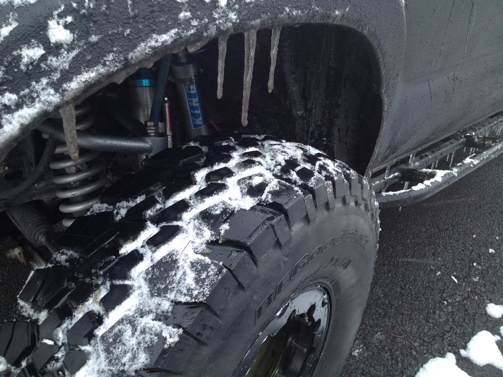

    I don't think anything works on ice other than chains or studs. The Goodyears were a little sketchy on ice, but the BFG's have a softer compound and are less frightening.
    BFG baja's actually have a couple of different patterns. They all do fantastic in the desert, but you are right. The Military pattern is more mud oriented.
    Baja T/A's
    Baja KR2
    And of course the military pattern, hand grooved (icy and not aired down)-
    8879A974-60EA-4001-B208-778B91889DD7_zps_4e7ce64a3d99432d70c36d2d953bbaf4b35e2996.jpg
