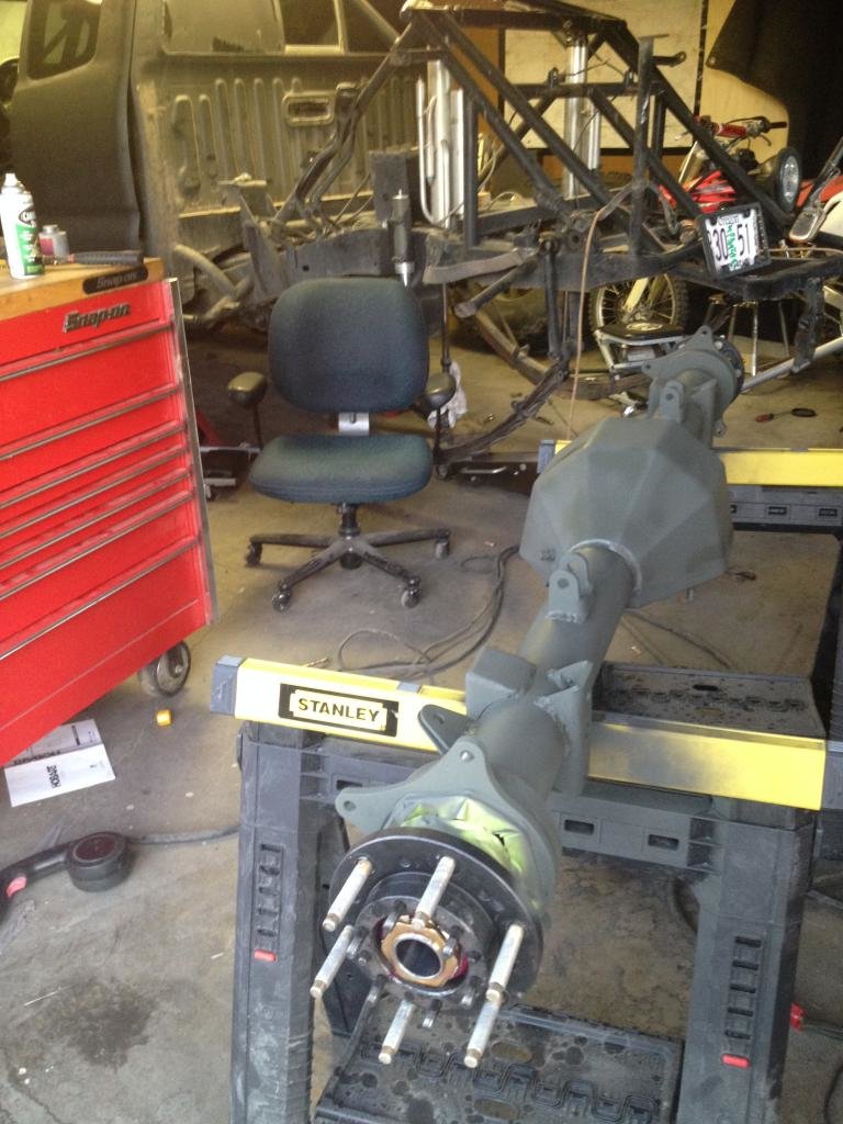

    The axle? Nah, it took a few hours but a lot of it was sitting around watching paint dry. I bet I could have the whole axle out and in pieces in half an hour, full floaters are much easier to work on than the stock axle.

    They studs are easy to install too. Just knock the old ones out with a hammer, and use a lug nut to seat the splines of the new one.
  17. Mar 20, 2015 at 6:49 AM
    #657
    SGTCap
    SGTCap [OP] Well-Known Member
    Oct 30, 2013
    #115529
    3,834
    Cap
    Summerville, SC
    4x4 6-spd,
    37s, 4x4 6-spd, OME 886s, Allpro Expos, SOS sliders and front/rear bumpers,Rack,Skids, 4.56s, Lockers,Recon Winch, TJM RTT, Lots of tools, boxes and gear. Shaggy mutt behind the seat
    You have to press the hub apart first though don't you?
  18. Mar 20, 2015 at 6:53 AM
    #658
    username
    username Fluffer
    Oct 15, 2010
    #44704
    6,064
    Pendleton, Or
    05 Taco with some crap welded to it
    mostly stock
    No. Just jack up the truck, take the tire off, take the brake caliper off (two bolts) and slide the rotor off. Then knock the old ones out. There is room at 3 and 6 o'clock to slide the old ones out and new ones in. Then use a nut to force the splines of the lug bolt into the hub. I suppose you are supposed to use a hydraulic press, but that way works. In the rear on a stock axle the backing plate gets in the way. You can get the old ones out, but the longer new ones won't fit. I used a step bit to drill a 1/2" hole (or so) in the backing plate directly behind the stud.

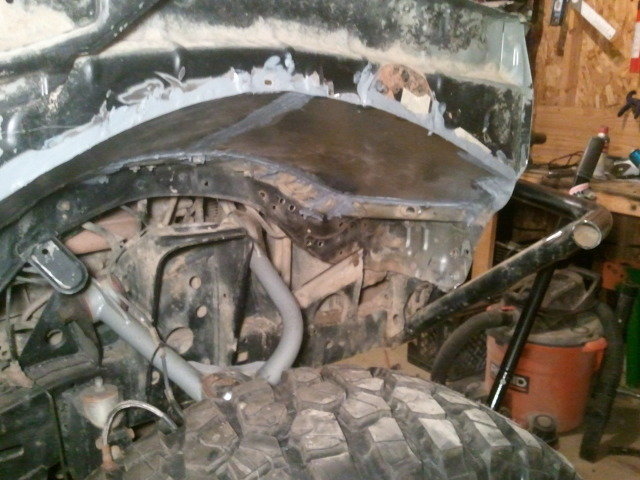

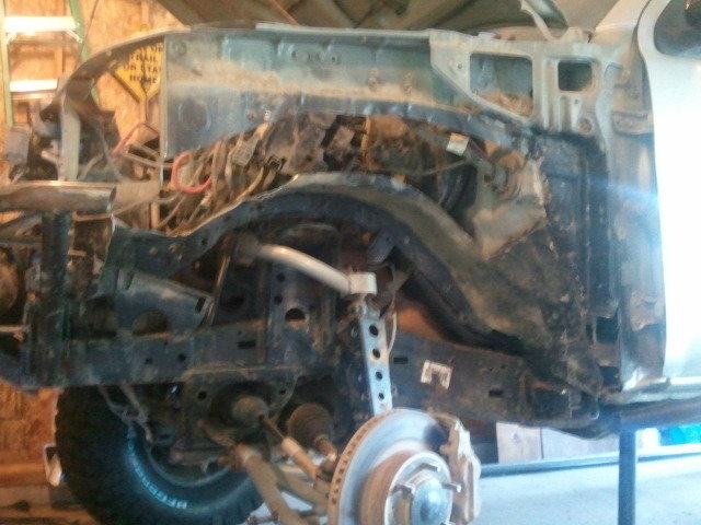

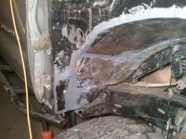

    6" BDS DB, 37", Dirt King, Total chaos UCA's w/ Heims, Fox c/o's, 4-banger fenders, 37" Nittos, 4.88 w/ rear ARB, AP Expos, 17x9 Method beadlocks, cab mount relocation, "Insain fab" tub, 5% tint, 10" Rockford Fosgates, Magnaflow 18" custom catback exhaust, AFE intake, Trail Gear bumper, Crown brake lines F/R
    Oh I gotta have my lift!
    Yea doesn't help much when flexing. Was hoping for some pics for comparison b4 I go into phase 2 of clearancing
  20. Mar 20, 2015 at 9:09 AM
    #660
    Supra TT
    Supra TT Supercharged Lifter
    Jan 3, 2011
    #48645
    7,226
    Eric
    Indiana
    2000 SAS D60 F/R Supercharged
    Supercharged on One Tons
    Heres how you clearance for 4wd 2" LT, which requires alot of cutting.
