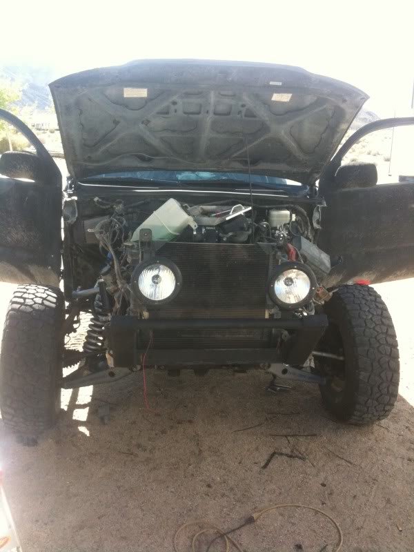

    I just cut all that crap off at once. Only two cuts with a sawzall.

    A 6" drop bracket lift sure helps though ;) Not that I would run that nor recommend it.

    That looks like a mix of an old Volkswagen dune buggy and a model T. Haha

    What about the firewall area? It kind of looks like you might have tubbed it there, but I can't see it that well in that pic...

    I just cut the fender aprons off of the firewall. After that I built an engine cage to support the radiator and fenders. I didn't tub it, but I did beat on it with a sledge hammer.
