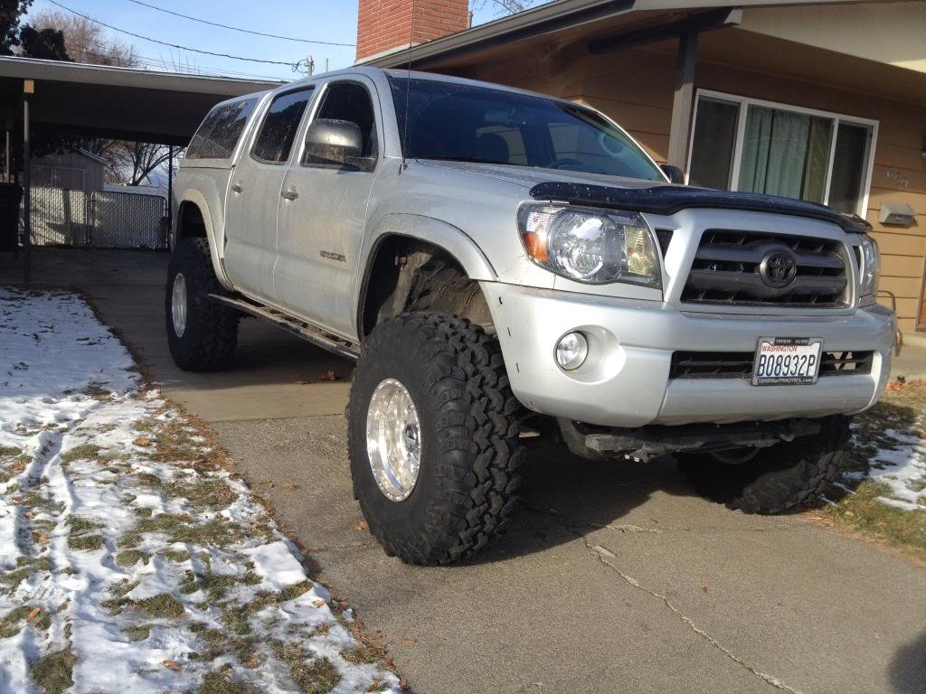

    Just started running 37s on a 6 inch, I'm really happy with how it turned out! :D [​IMG]

    Looks good! Except that front tire there, looks too clean :D

    Thanks!
    Yea drove through fresh powder up in the mtns kinda weird the back tire is dirty

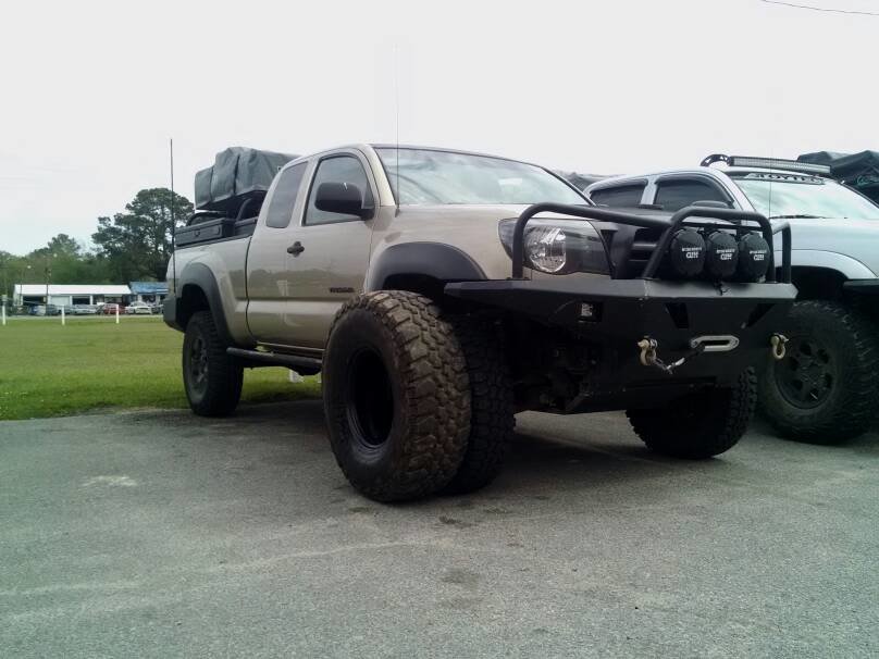

    efd96e3087335c760a06b09f8d9a67a4_91abb0d226421d692ab851b68030343513a62b33.jpg98f8e16967da18f2725f318f5f6ea0b8_be9cdaf86ebb7fbdc74c2d53fbba95bdce35d8b1.jpg
    I don't see what could go wrong

    You're going to have to chop chop on that plate bumper...

    Yup. Its okay...I know a guy. :cool:

    I've got a crawler 1" body lift on order, going to cut the corner of the firewall and relocate the body mount. I have no idea how much I should take out of the fenders though

    Start with 1"... Can't really add more to the fender but you can certainly take more out!! :D

    I went a little overboard on mine, but if I did it again id do 2-2.5" on the front and back of the fenders and transition to 1"-1.5" across the top. You can always come back and cut more later when your fitting tires. Also think about leaving your flares about 1/4" longer so you see less of your cut in the sheet metal.
    Im running 36" Irok's (36.8 actual OAD) and My tires look small in comparison to my fenders now.
