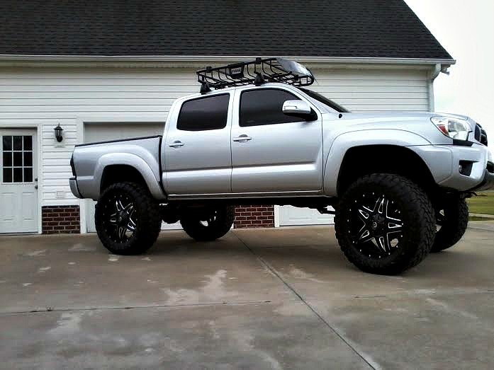

    I don't but 2 pictures on my computer at the moment.. but I'm running 37s on my taco and haven't trimmed an inch. I'm running a 6in pro comp lift with es9000 rear shocks. My bilsteins are set at .86" right now. I have full turning capabilities. The only time I scrub is in reverse at a certain angle.. and on deep holes. Obviously I didn't build mine to off road (learned my lesson by putting my z71 in a pond) just to show off. Stock gears at the moment, but hoping to have 4.56s within the next 3 months.

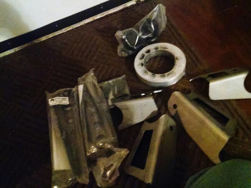

    Got some parts from Wheelers today
