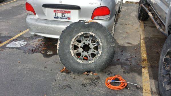

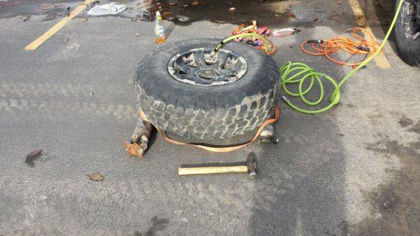

    This is going to sound weird. Aquanet hair spray produces massive flame balls. Also spray paint works in a pinch, but then you end up with paint all over. The trick to using any propellent is getting the right air/fuel ratio. It takes less than you think, like spray one lap around the rim then flick the match and have the air hose ready, as the air in the tire cools it will pull itself back off the bead.

    lol - I've done that a few times but with carb cleaner. :D
    Lost a bead this past weekend @ Rausch but the wheel was too bent to get it to seat back in. Steelies are the way to go. :eek:

    ^^^This. I've used this trick a few times now. My mid grade ARB seats beads easy enough.

    I think it's the 16.5 not having the safety bead that makes it more difficult. Normally that's the first thing that seals, then it pops over when you get up to a decent pressure.
    I tried a dinky little 1.5" ratchet strap and failed. Gonna get a 3" and try again just for the learning experience.

    Yeah the strap works every time. Def a great tip to know. The either is for when for some reason you can't use a strap or you just wanna do something cool. Haha which the times I've done it, I just wanted to use fire
    You may be right about the 16.5s. But still, the tire seats to something. A strap should push the tire out until it hits something to seal against.
