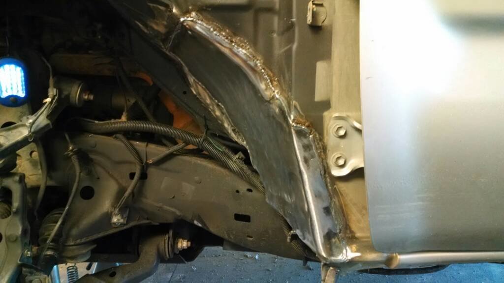

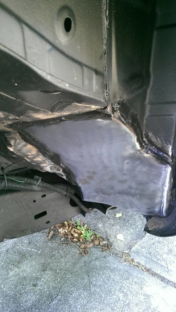

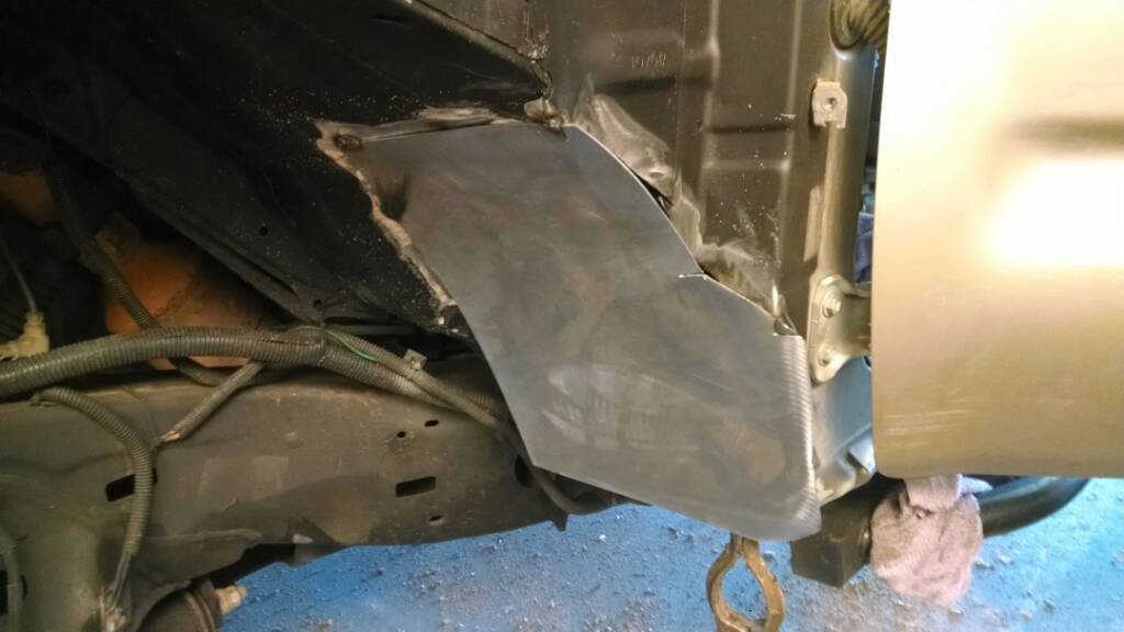

    Good job man! See, that wasn't so hard.
    Pro tip: Lay wet towels on the backside of the sheetmetal you are welding. It helps distribute the heat a little and resists blowing through, and as an added bonus keeps your cab from igniting.

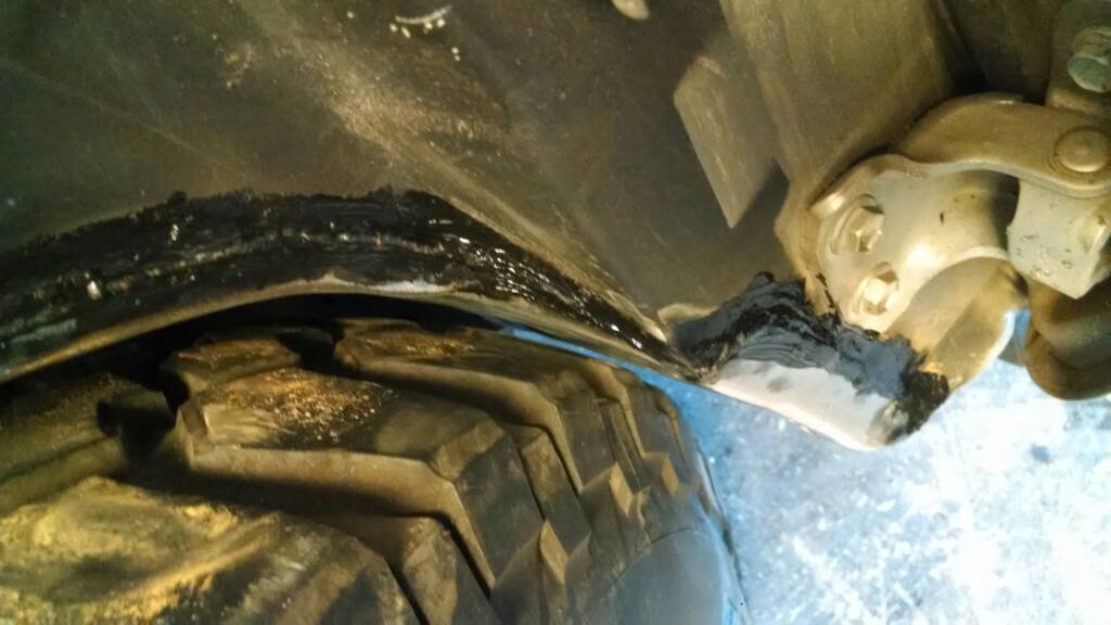

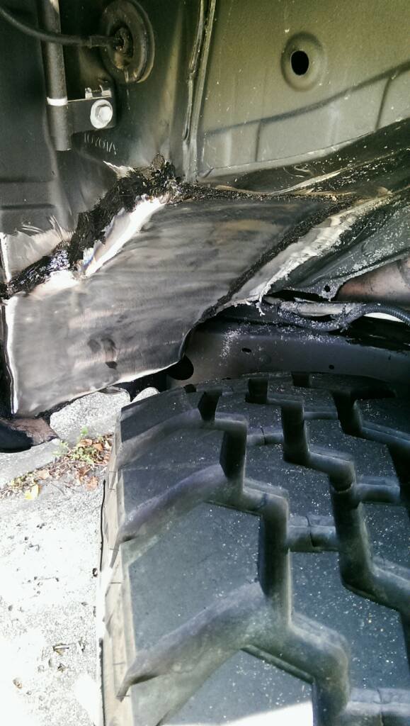

    At ride height. Just sprayed it down with some rubberized undercoating

    We did that but I guess I slacked on my duties and I let the welding get beyond my heat soaking. Thankfully I had Eddy to help with this process or it never would have happened. Especially with as thin and Shitty to weld on the factory sheet metal was. You look at it funny and it'll blow a hole through it. I never could have welded it. Fortunately Eddy can.
    Hell I saw him weld two pine trees together on a bet. No shit.

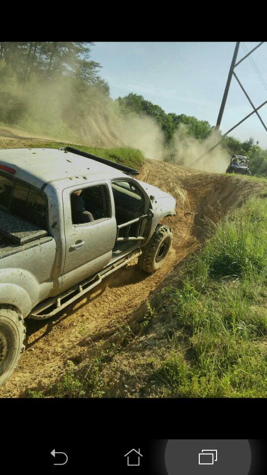

    No rubbing on the front today, the rear though was a different story haha. love the tsl!

    If Eddy cut the patch pannel would anyone be interested in buying it? Might take some of the guess work out of how much to cut. Just an idea.
