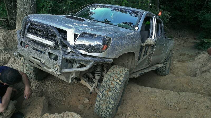

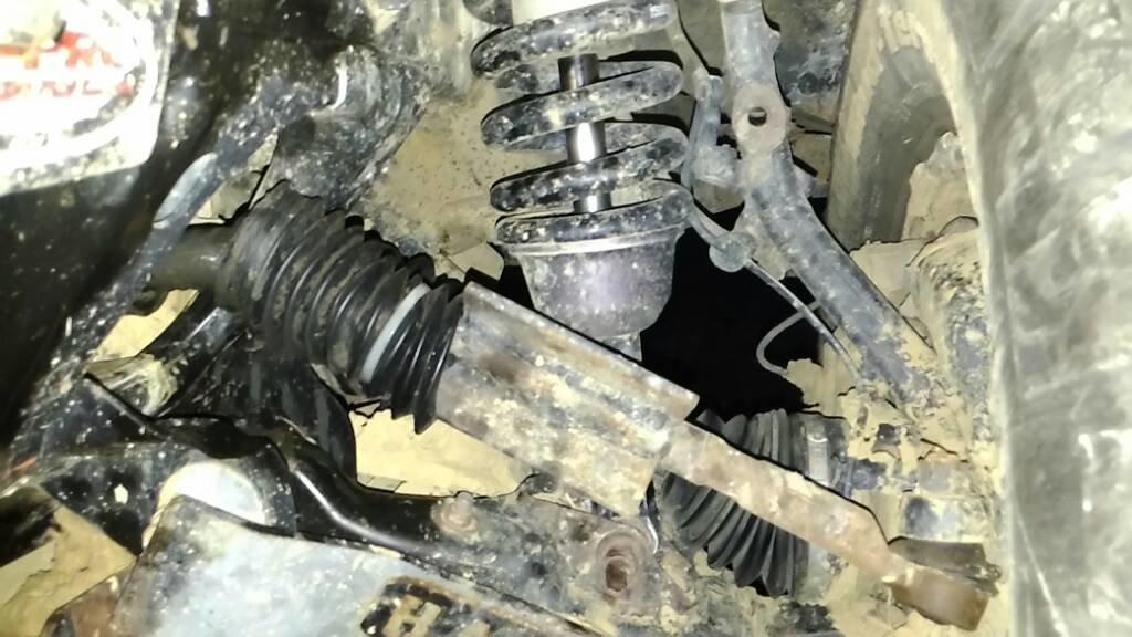

    1b1eea7cc3b8ce8d2cb7a86ff73a06d8_25f26259d447f9a791bc0e2a72718ecc11eb7fc8.jpg40ac993246ac3c30507459f04336f2f7_0753ce0fd0358a46c2e189efb36911a054fff467.jpg
    How I drove home after I broke the tie rod and bent the rack haha

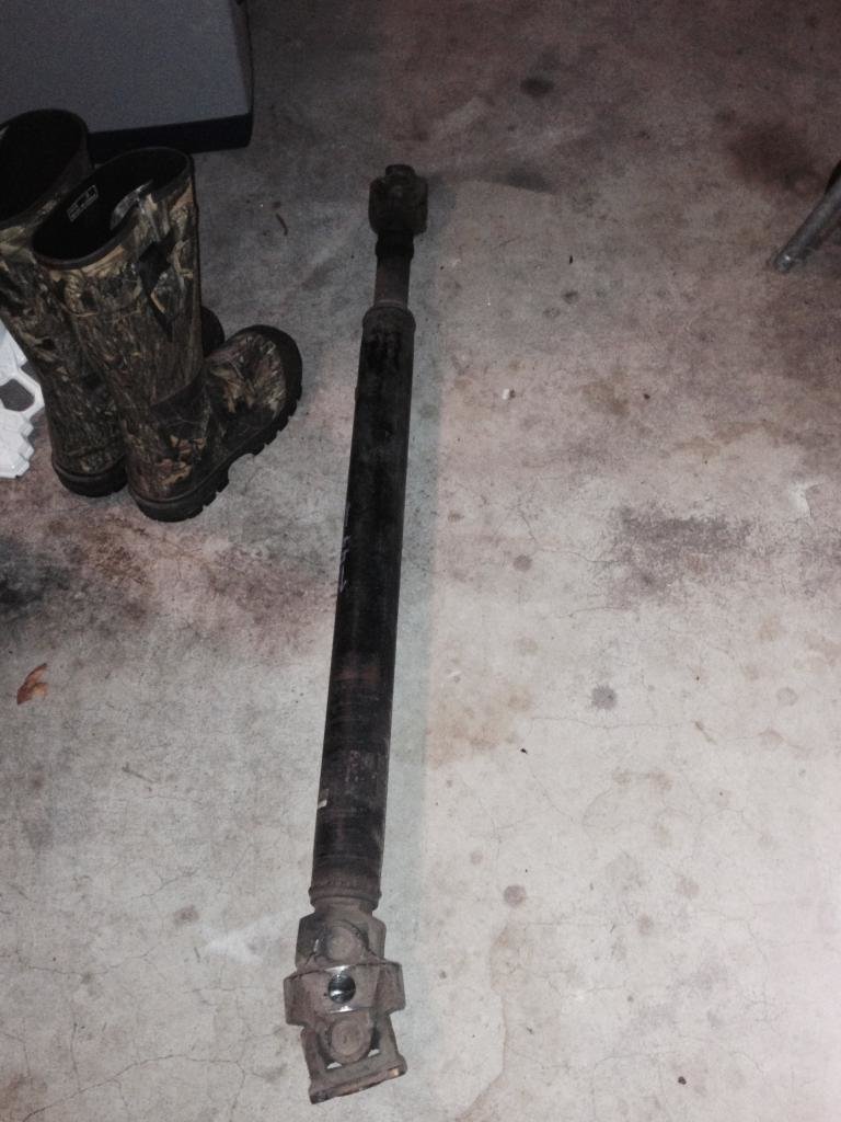

    What I ended up doing for driveshafts is have the shop take 8.5" out of the "short section" ahead of the carrier bearing on my stock driveshaft, this is the shaft I use for a spare. Normally I run a .120 wall one piece driveshaft with a double cardan joint, I get those shafts from the junkyard for $50 and have the shop retube them. Think I've got 3 or 4 of them now haha. They come in the rear of the 96-02 4runners or the front of the 86-89 IFS 4runners and pickups.
    9D9DC774-F49B-4D81-801D-D58365D0DB03_zps_a42385a144621103f56df4965c264c25206bfdcd.jpg
