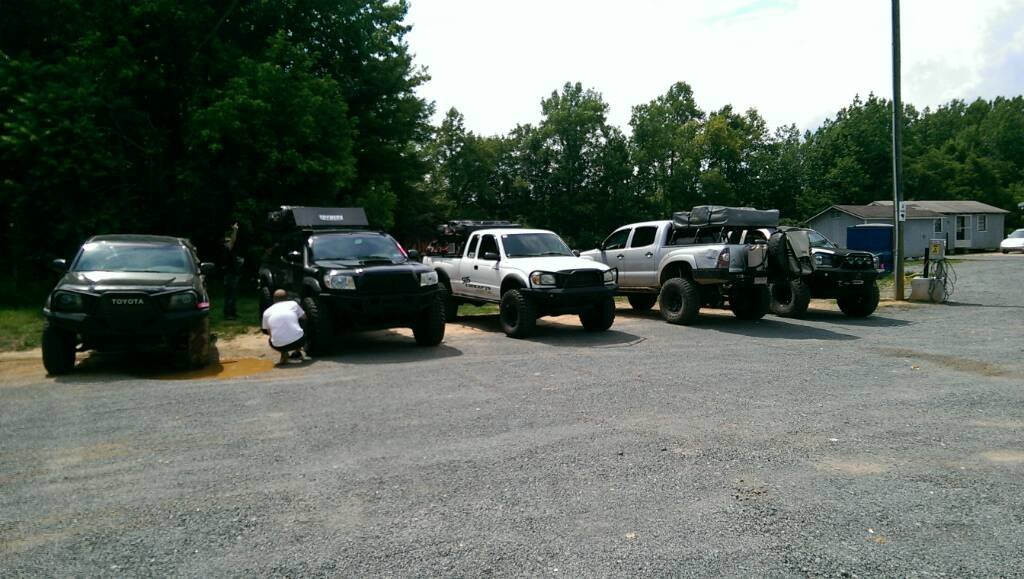

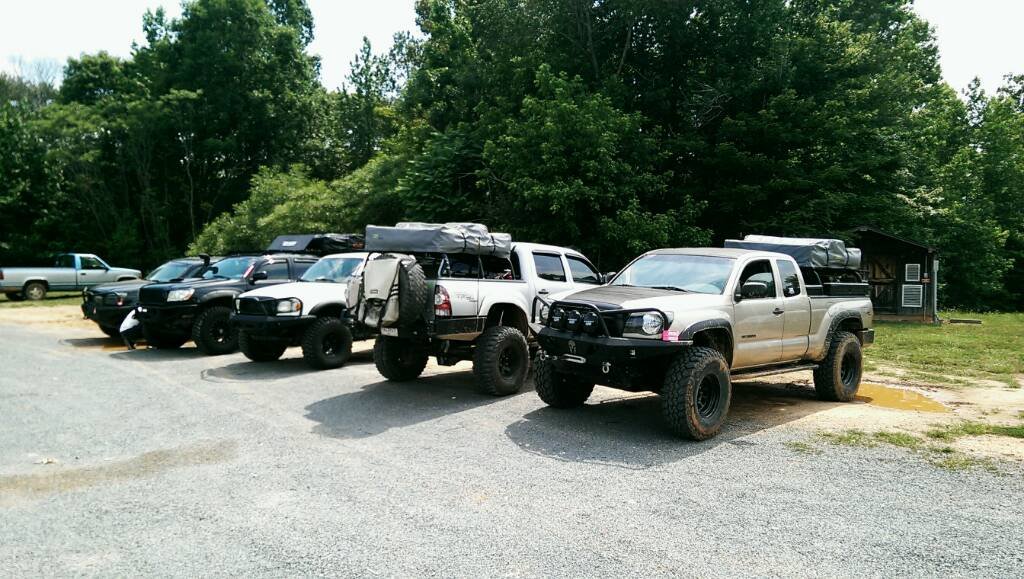

    That's all I got. HomerTaco was airing down at the time

    Damn my rake

    :woot: only 1st gen

    @EddyRRT you must have parked in a hole.. I don't think it's that bad in person :notsure:

    I'd like to see the tires around 10 psi

    Watch out for that glare from the back of my head... :anonymous:

    Eddy was the true rebel.. pulled in.
    Dat ass tho ;)

    Eddy always parks in the opposite direction of everyone else. I don't think it's even a conscious decision
