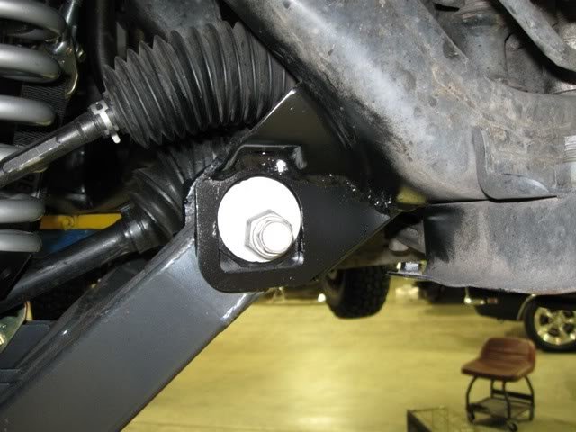

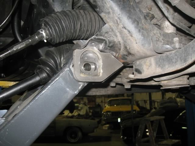

    Max out the caster (even on both sides). On the driver side when facing the headlight, turn the front cam fully counter-clockwise, and the rear cam opposite. Get the two front LCA cam bolt heads closest to each other, and the rear cams furthest apart. Passenger side reverse of that. This pushes the lower end of the spindle forward an inch. It also rakes out the front end like a dirt bike, allowing for better high speed dirt handling at the cost of a slightly twitchy feel on pavement. I also do zero degrees of toe in for better turn in on dirt, but on crowned roads you have to correct slightly.

    Can you post a pic too? That's an excellent description. :thumbsup:

    I rode my bike to work today, but I can steal pics from the webz.
    See the slot? You want the center of the hole as inboard as possible. (front cam)
    Kinda like this. The rear cam is opposite, pushed out as far as possible in the slot. If you loosen both cams and pull forward hard on the end of the LCA, they kind of slide into place. (pro tip: once you get your alignment figured out and are happy with how it handles, tack weld the cams in place at the 6 oclock position! Otherwise they'll flatten your alignment tabs if you whoop on it much.)
