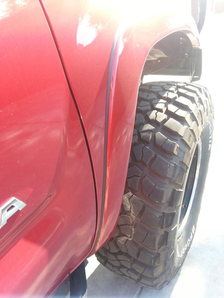

    Imagine this but bigger by 2.5" :)20150818_091432.jpg

    I don't see where that 1.25" on each side will fit but looking forward on seeing how it turns out

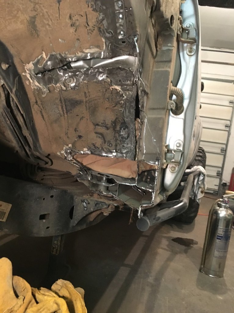

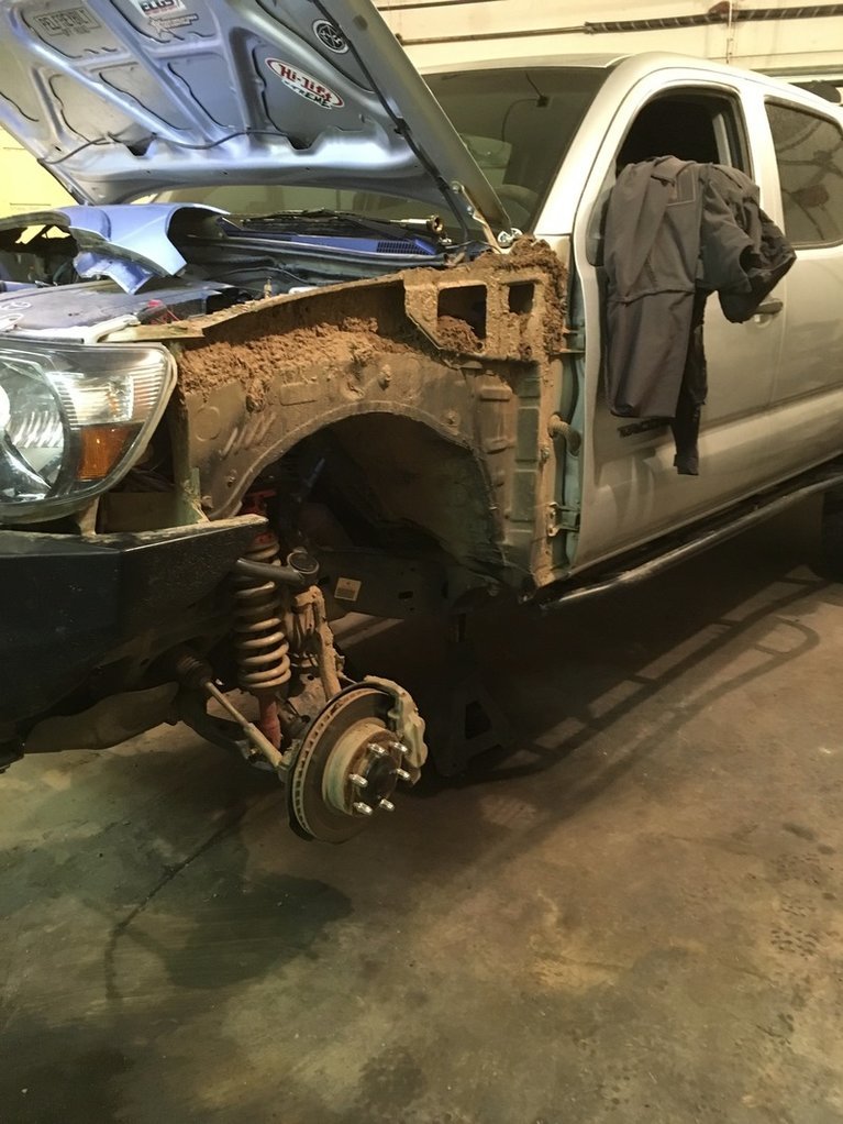

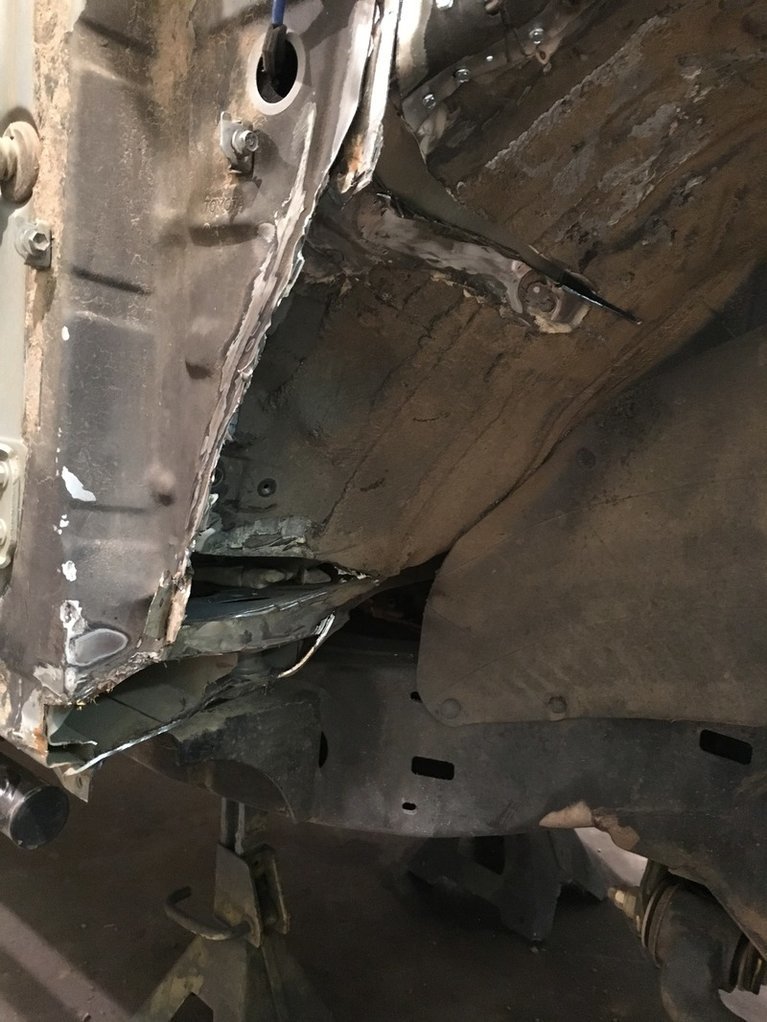

    Well sorry for the long wait on this... I will say this right up front that this was not easy. It took me a week to do, and I was stressed nearly the whole time.

    removing the fenders made getting to everything easier. Though remembering where all the bolts go was fun. After that I had to expose the pinch welds that I had already beaten down. as you can see I've already relocated the body mount, and cut once before.

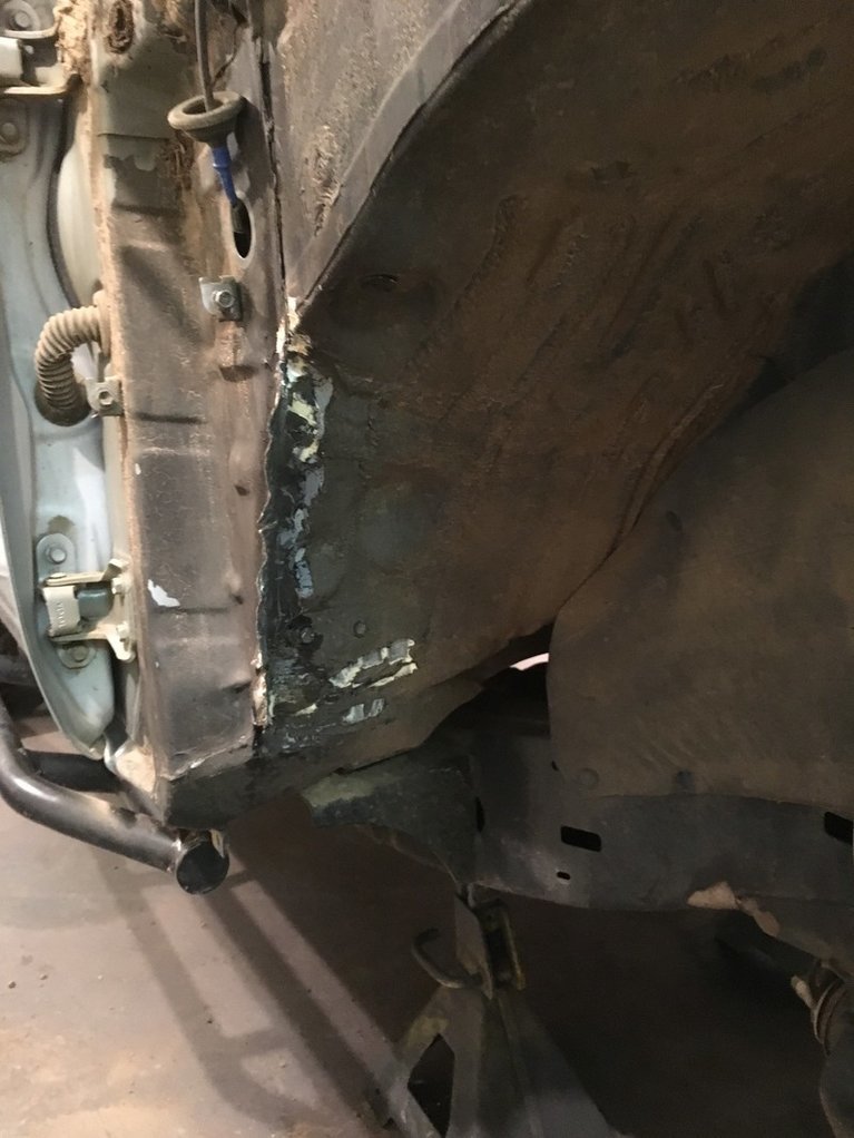

    I tried the best I could to open everything up by drilling out the pinch welds before i cut.

    I used small self tappers to hold things in place until I was ready to start weldingIMG_2141_zps1ypxd1sr_b2b5adf641e165b7037f8e71c0d08a34d80215ec.jpg

    Heres a picture from the other side. My coat shielding the sparks from entering my cab.

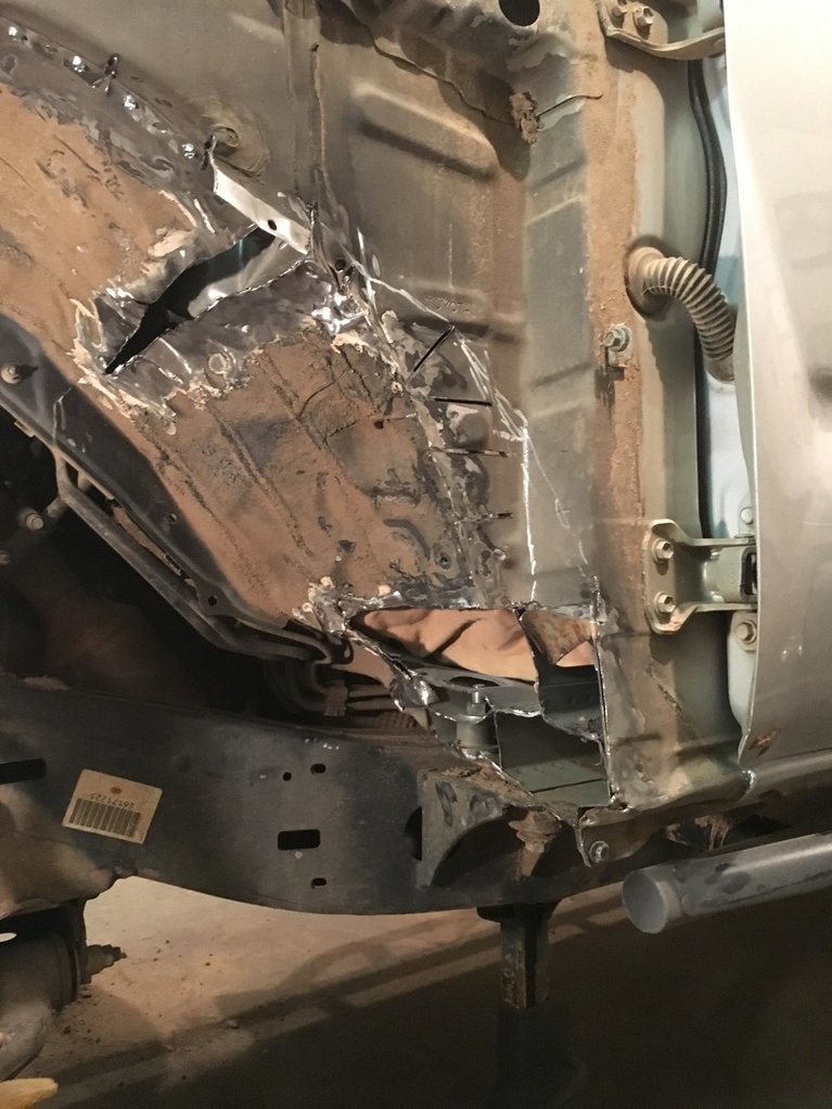

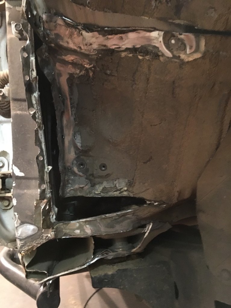

    I did a lot of relief cuts and folded the sheetmetal back. I tried using as much of the original metal as I could before filling back in with 16g metal

    Slow and steady... The welding of this stuff flat sucks!! Not to mention the fire hazard in the cab. I didn't take any pictures of the inside but removing the carpet, lower dash and and as much wiring as possible is key. Even then I had two fire extinguishers ready for the worst. I had one small fire and after that I hated every minute of welding. I had a guy watching in the cab the whole time. Lots of wet towels on the floor made all the difference. Also having a air nozzle to help cool the welds kept things from getting to hot.

    #130897
    827
    Sacramento Ca
    07 taco 4x4
    Looks good, one area I didn't go enough into is right at the body mount bold location for my 37's. This picture is with the factory mount chopped before the relocation so I couldn't go any deeper in at the bolt location area! At full lock I rub a little. I like how you tubbed at the top as well
