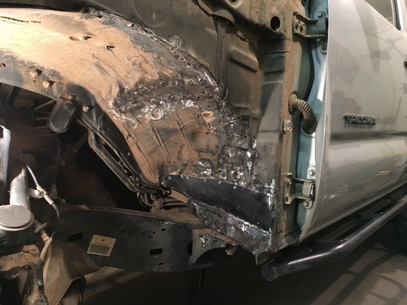

    So after hours, and hours of work it ended up working out.

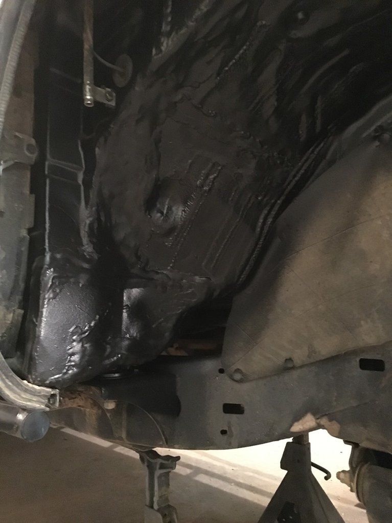

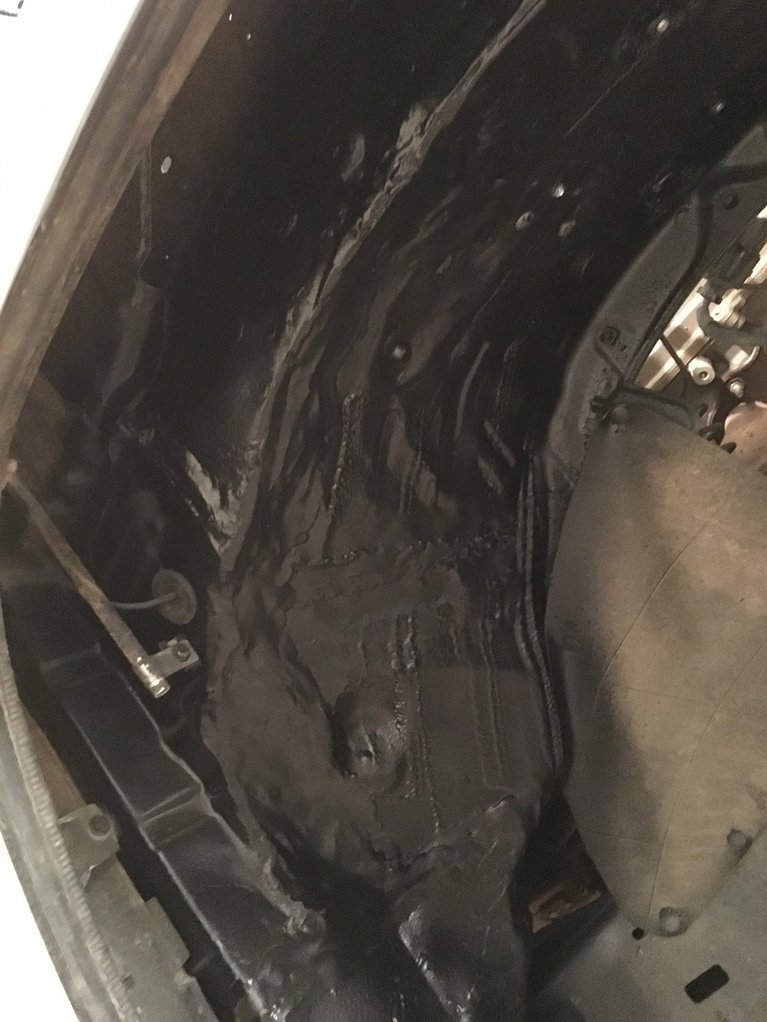

    Seam sealed and undercoated

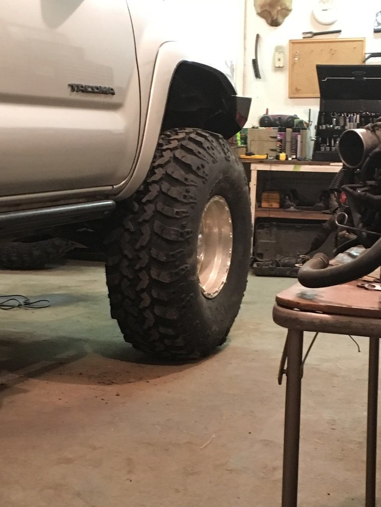

    I still rub the frame at full turn, but Ill live with that over putting wheel spacers in. Remember this is only a mid travel kit so my up travel isn't as much. Ill know more once I get it in the hills though. So far I haven't rubbed anywhere else. Either way I don't mind a little rubbing when Im bound up.

    Yes on 16x10 with 4.5 backspacing

    Wheel offset helps too. Mine are 3.5" backspacing, with a 1/2" spacer making the wheels 3" BS. The drawback is with LT, I'm 91" wide outside tire to outside tire.
