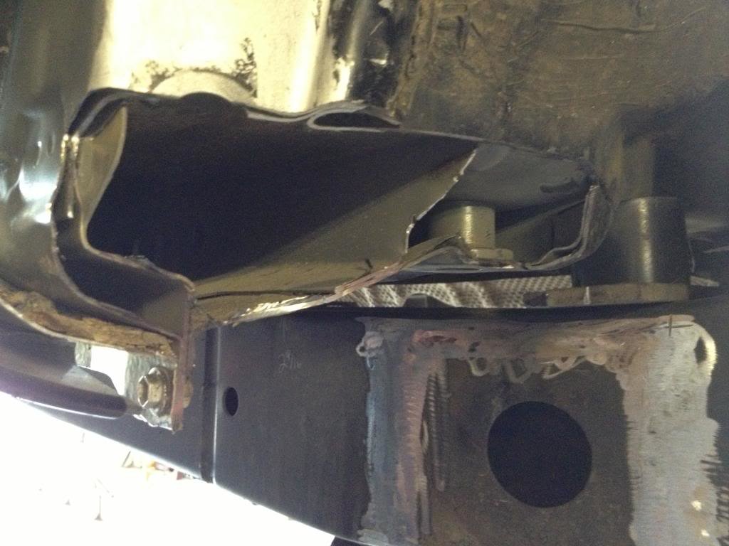

    Wow!! Something like this right? I think you took it a bit farther though :D

    This is mine welded back up. I used seam sealer and then painted it. Bad picture though

    It looks like you went a little further back right next to where the rubber mount was since you got rid of yours... i went about 10" up the floor board (basically cut the whole pinch weld off) which made it esay to overlap it, (it was alot of work though!)too to push it in about an inch. I had to take my electrical out of both kicks, fuse box and unplug all harnesses to get it all out of the way so there is no gamble with starting a fire. I dont have my tires yet so I figured chop as much and as high as possible and then find out if its gonna be 35" with lots of room to spare or 37" (I hope) :)

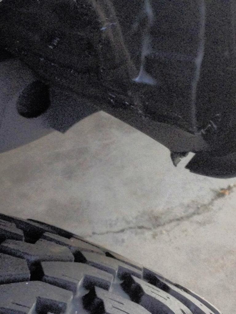

    Do any of you guys have any GOOD pictures of a set of 37" turned to or close to lock see how far the outer corner of the wheel goes in to the firewall and wheel backspace/ spacer info?? Does the wheel outer corner get close to where the sleeved hole is in the floorboard for the body mount?

    This is with a 38x15.50R16 Toyo MT that I test fitted

    I seen this pic before.. thanks :) wow 15.50??? So you were probably rubbing the inside of the frame and wasnt steared to lock.. huh? anything more realistig? :) like what youre running now or some 37's by 12.5ish?

    Im running 36x13.50 16" Iroks, but they measure out to the same as a 37 on their site. Yes they do rub the frame from time to time at full lock. I would run 38's if they had them. Im just not a fan of the heavy Toyo's
