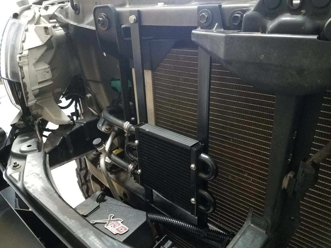

    I am still on my original rack. (Knock on wood) I do get steering fade, on occasion, when wheeling. Especially if I forget my front locker on and driving in a rut fighting the slope. I did install an aftermarket steering fluid cooler in front of my radiator and it helped a bunch.

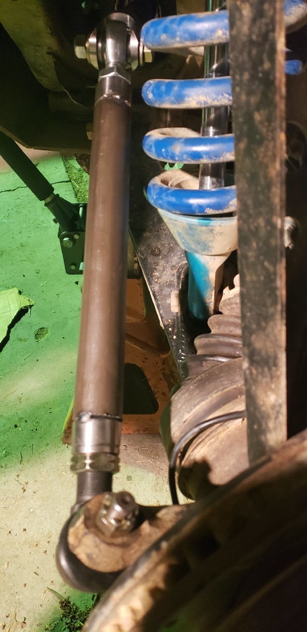

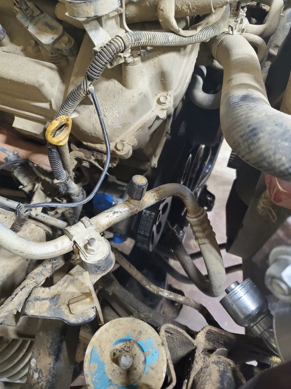

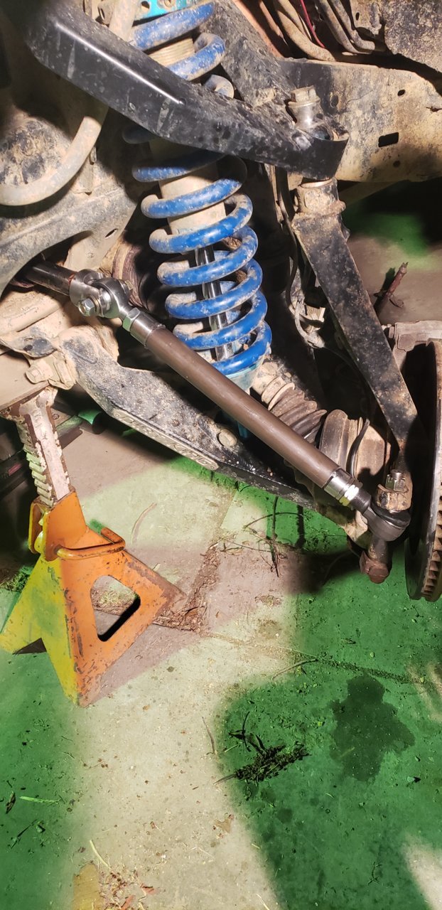

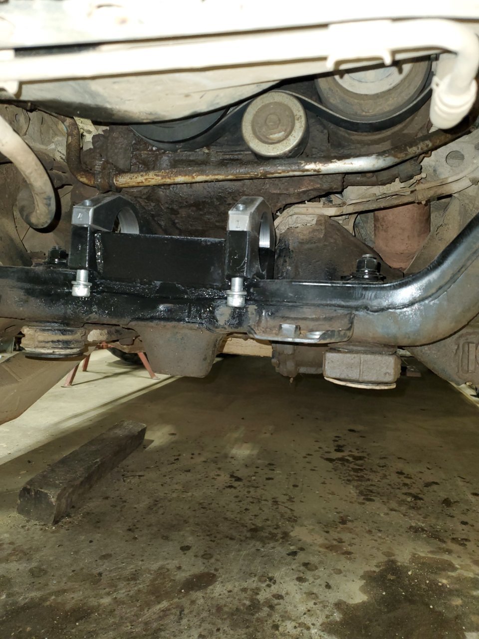

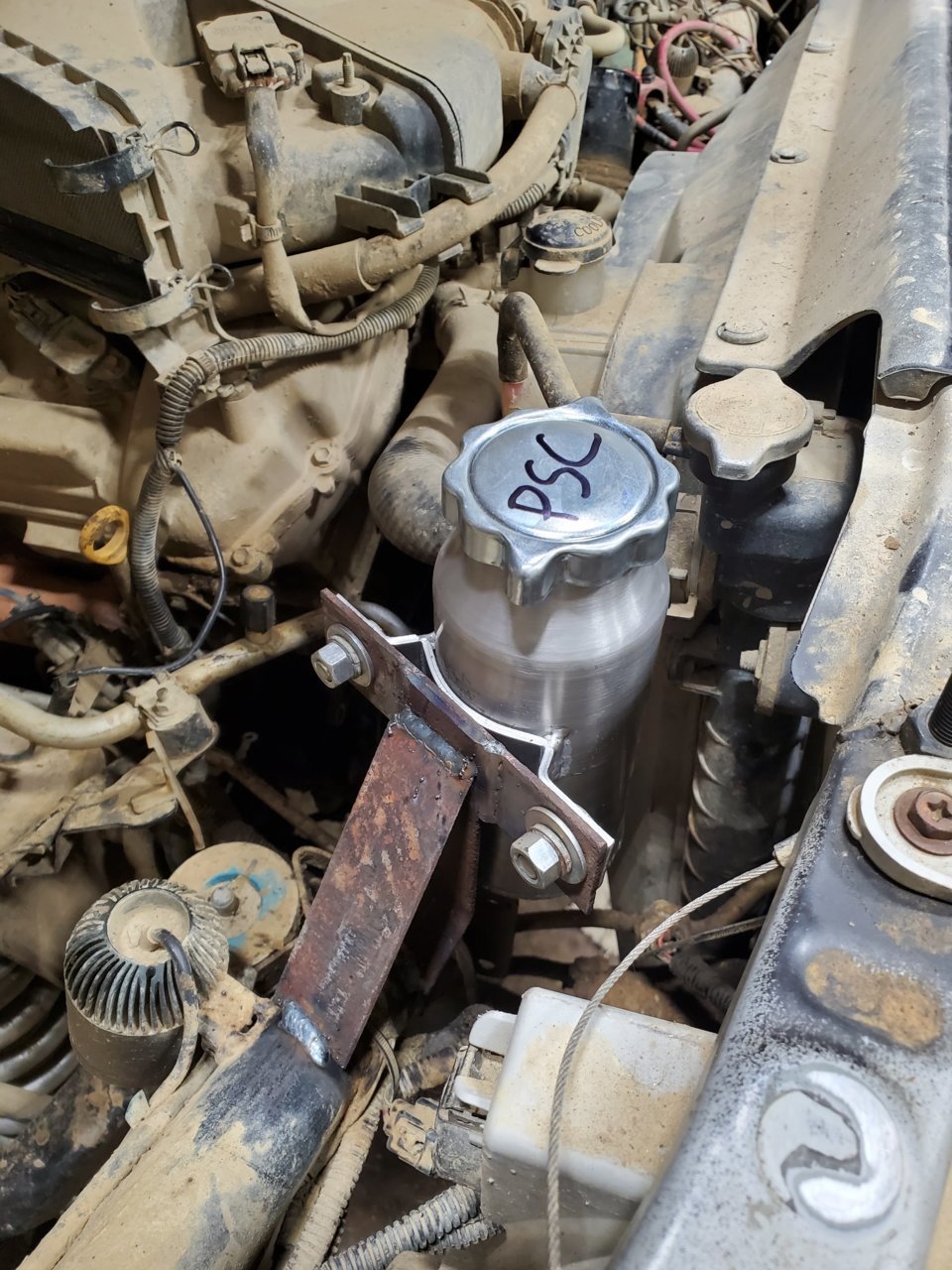

    As far as the full hydro not many just the mounts, pump, reservoir are finished up right now.
    But the tie rod I used a fj80 tierod because I didnt like the single sheer idea of a heim. (Had to drill out my knuckle and make a tapered sleeve to match the fj80 tie rod). But I have since found out a gm 1ton tie rod can be used and they make a reemer for it so it's much more user friendly. (These tienrods help kill the rack but I dont ever think about breaking them on the trail like I used to)

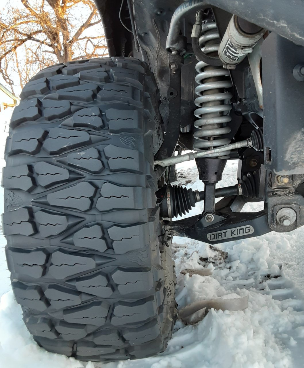

  13. Feb 18, 2020 at 3:48 AM
    #1833
    Blacktacoma23
    Blacktacoma23 If your tires don't rub you can fit bigger tires
    Jan 16, 2011
    #49366
    5,001
    2011 Mall Crawler
    6" BDS DB, 37", Dirt King, Total chaos UCA's w/ Heims, Fox c/o's, 4-banger fenders, 37" Nittos, 4.88 w/ rear ARB, AP Expos, 17x9 Method beadlocks, cab mount relocation, "Insain fab" tub, 5% tint, 10" Rockford Fosgates, Magnaflow 18" custom catback exhaust, AFE intake, Trail Gear bumper, Crown brake lines F/R
    17x9 3.5BS
    37x13.5R17 mud grapplers are actually 14.57" wide
