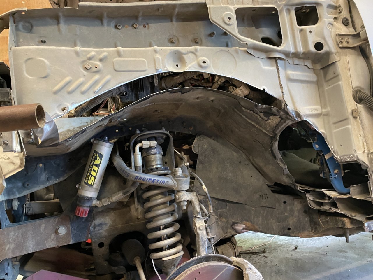

    Another update

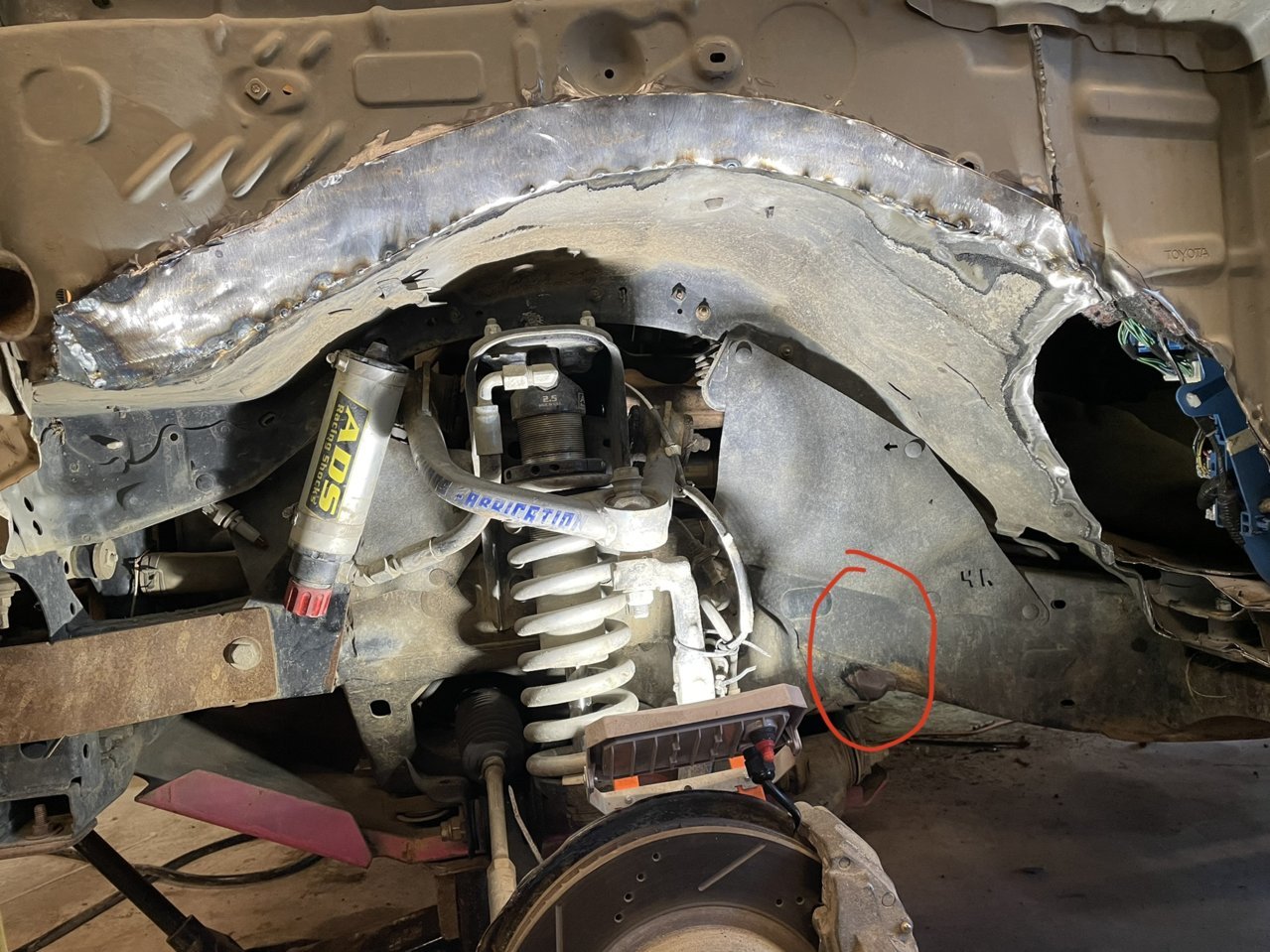

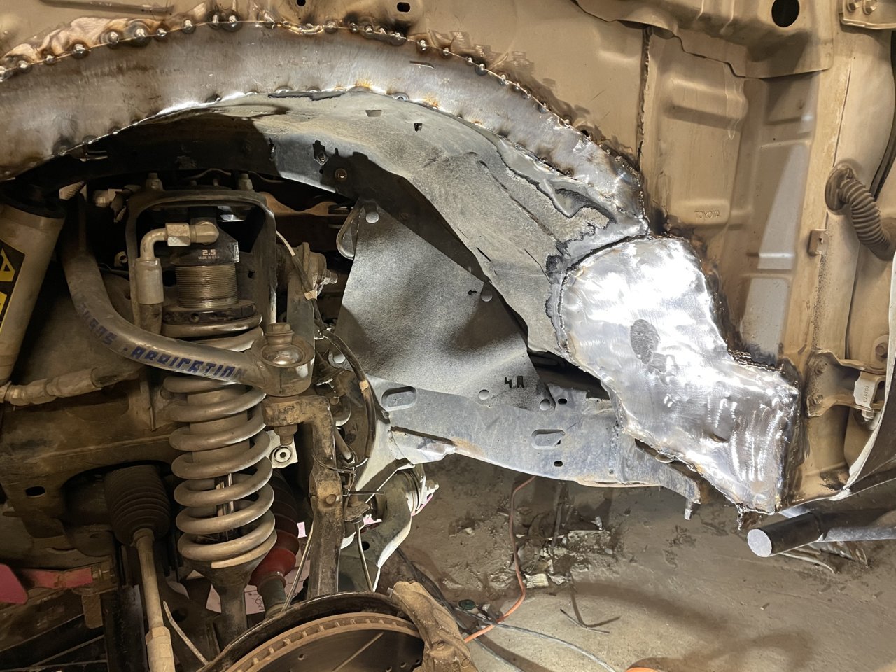

    Ok, what’s every one doing for wheels currently on 17x9 KMC addicts with 4.5 bs and -12 mm offset, looking to go to some steel wheels for durability and my current setup on 35’s rub where i circled below

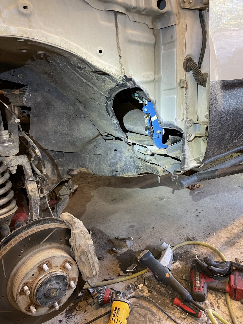

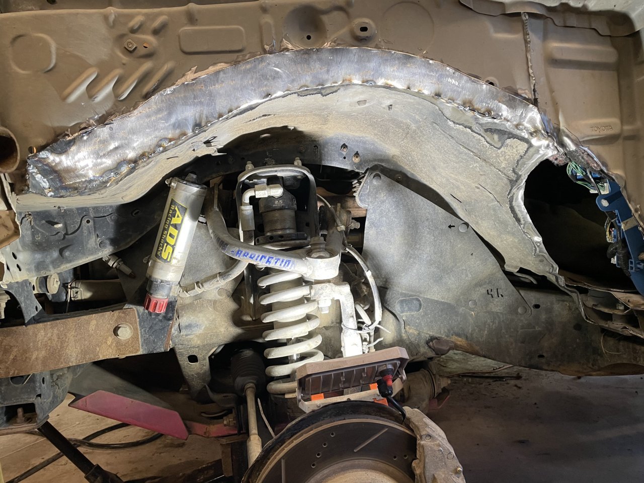

    All the welding on my driver side is done, I’d have done a few things different if i was doing it again(like not have to deploy a fire extinguisher :anonymous:)

    Running the scs 17x9 wheels with 3.5” backspacing and -38 offset. They are wide but keeps the tire off of things I can’t cut away. I’m not long travel.

    I have cleared that spot on the frame with 3.7" (-20) 16x8 wheels. I currently have 16x8 3.5" bs wheels on.

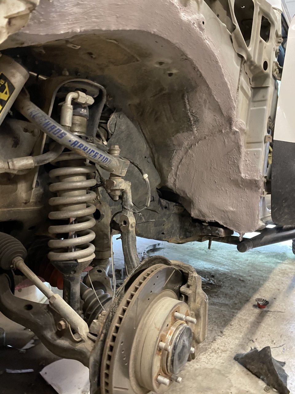

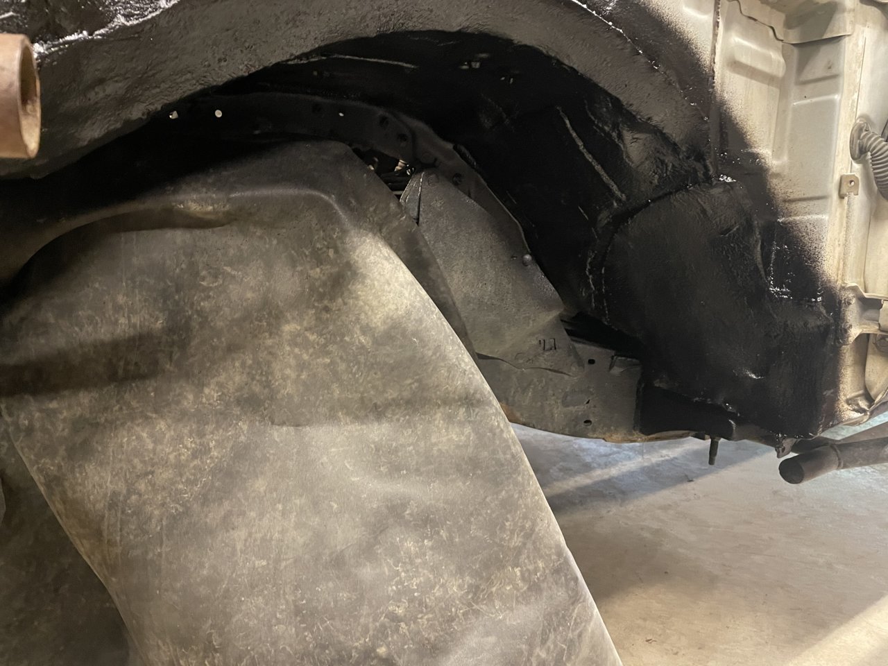

    Done with it, just waiting for my undercoating to dry
