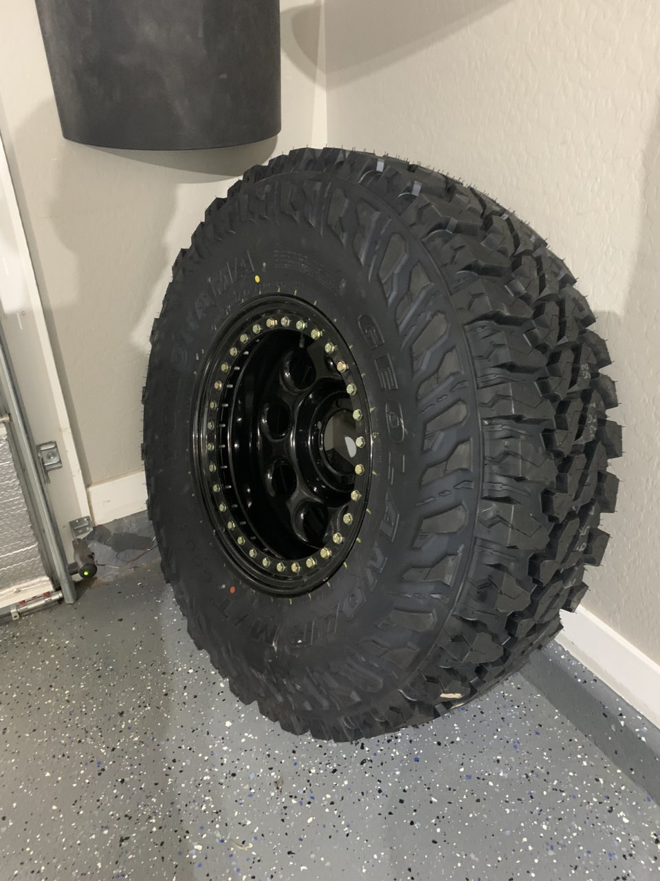

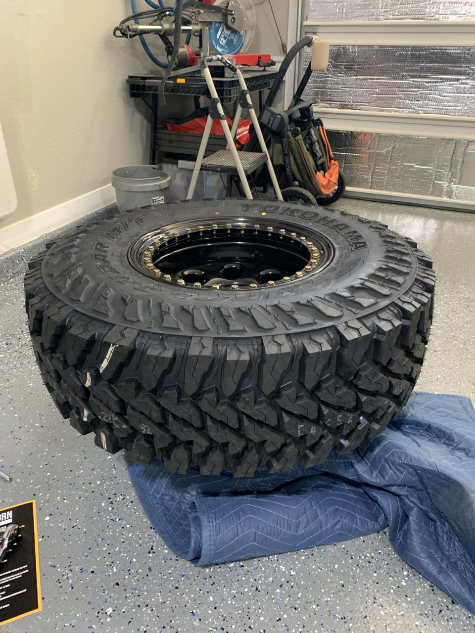

    Mounting is going down, still a lot of other work to do but this is fun. I’m pleasantly surprised these only weigh 75.2lbs. For an aggressive 37” MT that’s pretty rad. The bead/sidewall feels super thick, it’s just a hair over 3/4”

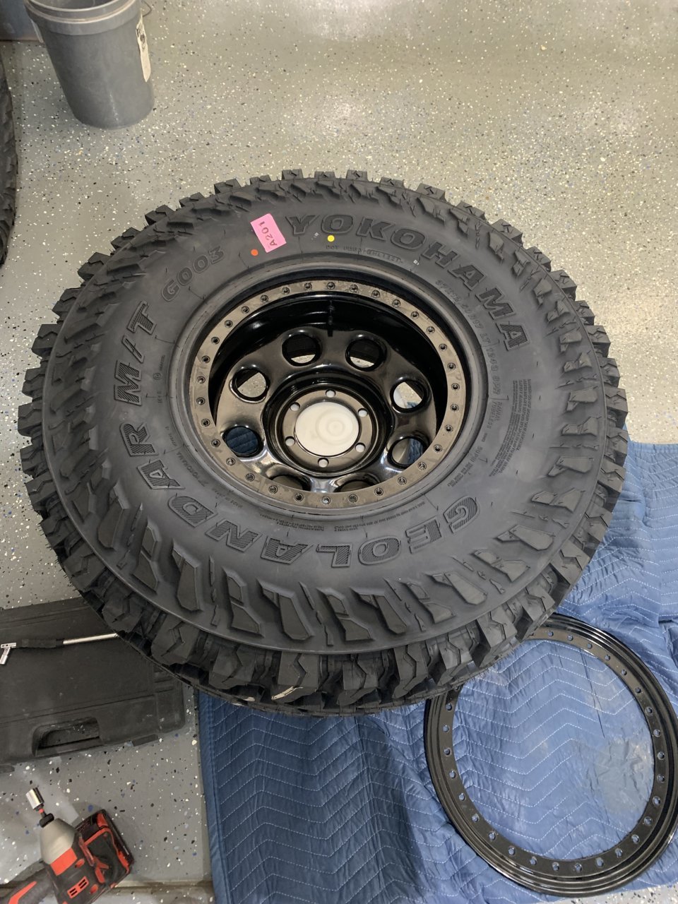

    Did you lube the back of the tire bead? I got mine to seat no prob with very little air pressure like 20psi

    EVERYTHING GOT LUBED…including my shop sealing when the bead popped:rofl:
    what size rims are those? Steel? I want a steel set of beadlocks with decent backspacking

    These are steel wheels with aggressive backspacing. 3.5 BS. 17x9 -38 battleborn beadlocks, my rear shock relocation might just barely touch this tire at full bump we’ll see. Might need like a .25” spacer back there

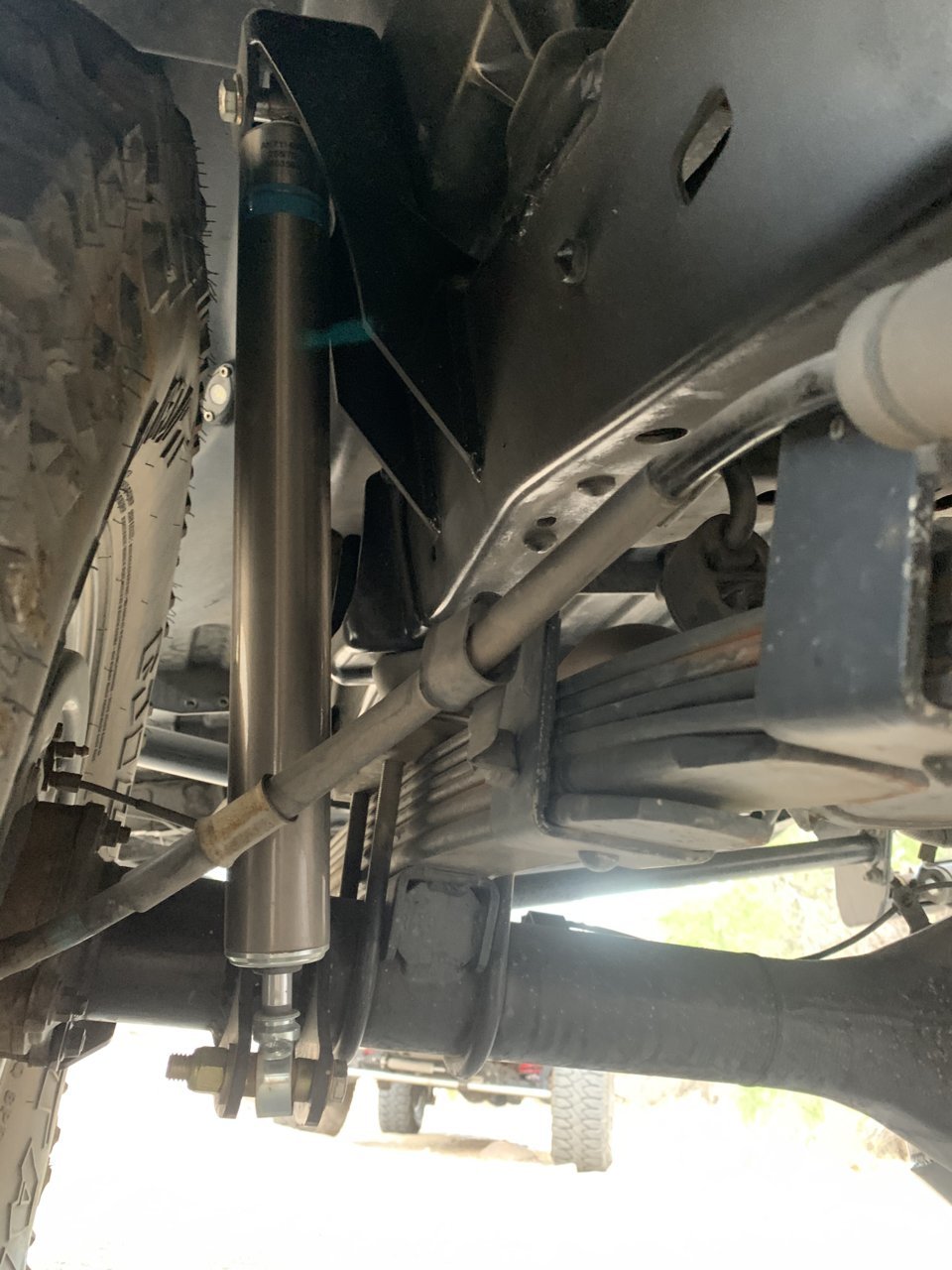

    I have 3.5 bs scs wheels, and I rubbed the shit out of one of my rear 2.5x13 ADS shocks.
    I'm running 1.25 spacers on the rear now.

    Right, that’s why I have a .75” spacer currently in the back to clear my 35’a at the shock

    I was running a .75 at first, from bora. Are you running skinny 35s or 315s? And are your shocks 2.0 or 2.5?

    315/75/16 milestars, 14x2.0 bilstein - this is at full bump w .75 spacer

    That absolutely makes sense, because mine are 2.5 inch diameter. Those look good btw

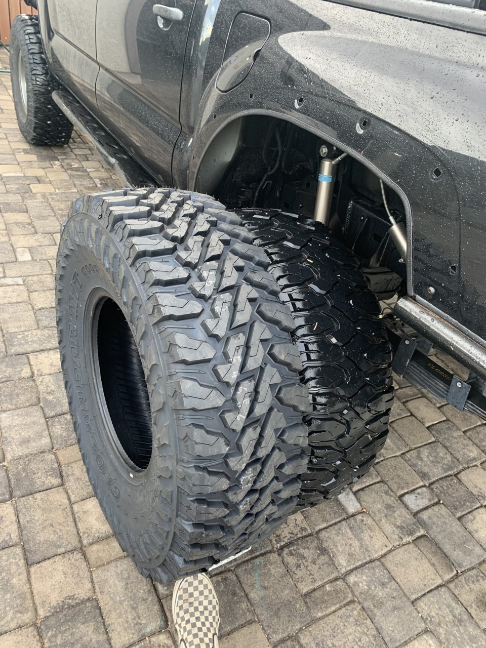

    If you go to 37s you will need most likely 1.5, Id imagine because of them getting wider when you air them down

    I’m currently getting 37’s on the truck and I’d hate to add a 1.5 spacer but I will if I have to.

    I mean at this point, if you want 37s you gotta do what you gotta do. And wheel spacers aint shit compared to upgrading the steering rack. I personally would also worry about shock fade faster with the weight (if you plan on going anywhere in a hurry)
