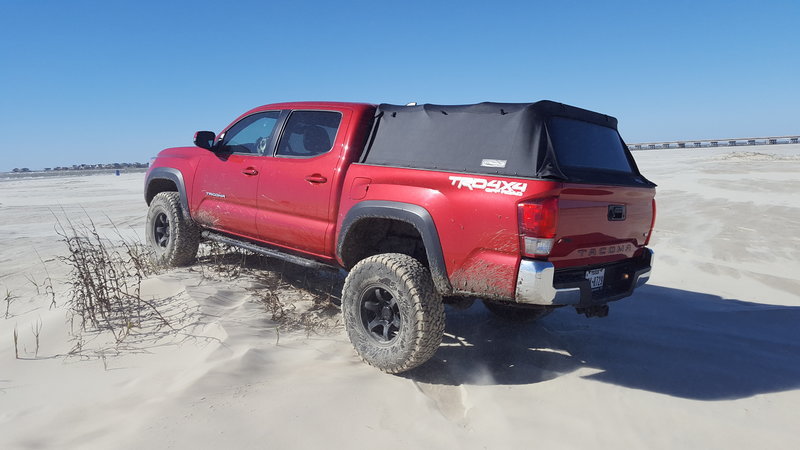

    Takes 30 secs to fold and 2 mins to pull the whole thing off. The window stays surprising cleaner to see through. Been through plenty of rain storms and the only 2% leak spots are around the front corners.

    Barcelona red! Same here, it's actually your picture that made me want to look into the soft topper.

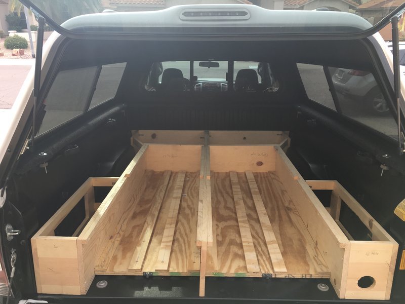

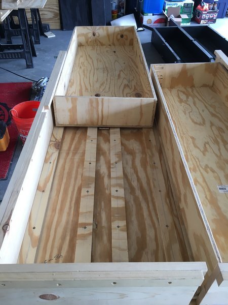

    Do you have any more details/shots of your storage solution? I like the idea of having the edges and middle seperated and would like to end up doing something similar...

    Hey sorry @sodaryl was out of town for part of the weekend. Yep, I have more pictures from the build phase which shows the breakdown of the bin system. There are two large storage bins up front and then 2 along the sides, aside from the two drawers. The drawer on the right is wider by design to fit my camp stove and Rubbermaid with cooking gear and bin for clothes. Let me see if I can dig up the pictures. I'll post them soon as I can find them.

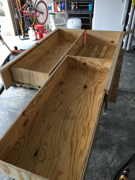

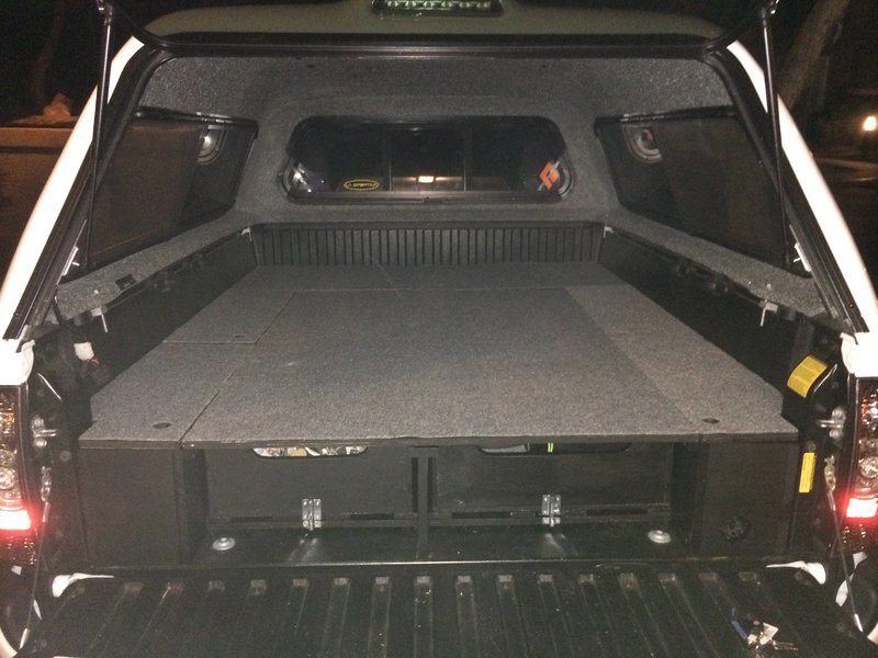

    @sodaryl Here's what I could find from the build. I engineered it to be 3 main structural pieces, so I can take it out if I need the cargo room. I made lids out of 3/4 ply for each of the compartments. They are all just friction fit and covered in carpet. I debated on hinges but with the mattress in there, it makes hinges nearly impossible. I have a memory foam mattress from Ikea that rolls up with a little bit of effort and makes getting to all of the compartments a breeze.

    Nicely done! Thanks for the pics.

    Thanks, I ended up sanding everything down and finishing it with ebony stain and a couple of poly coats. I used furniture wax for the bottom of the drawers and slides. It's cheap but it works great for the cost. You can build the whole thing for about $200. You could go more expensive with slides but it gets quite expensive and you would lose some drawer width. When I was researching it I think 4 ft slides were running around $100 a pair.
