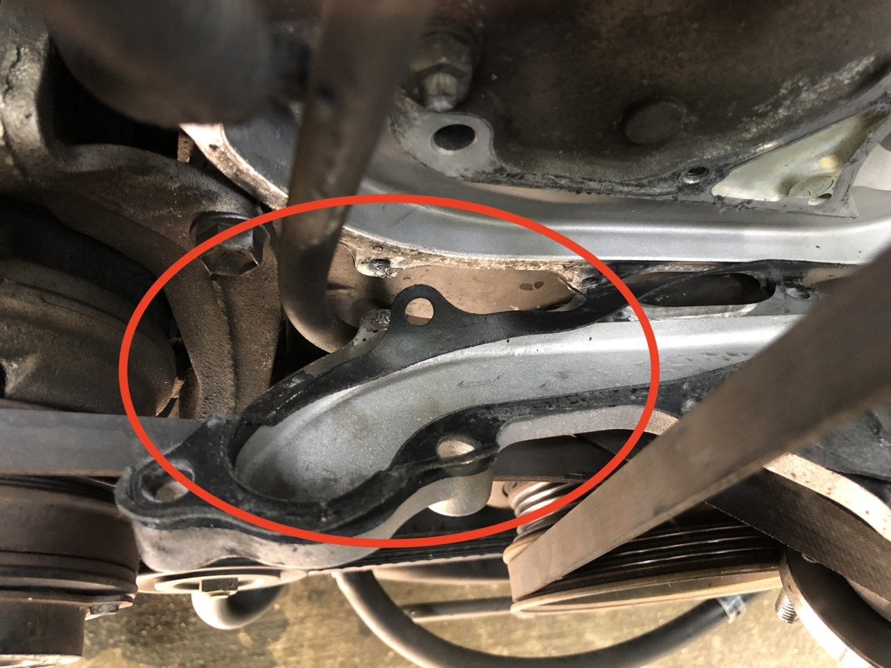

    Found one problem: the gasket didn't seat properly. Careless on my part.

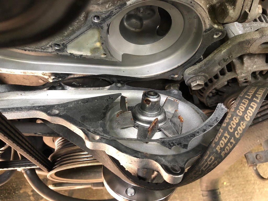

    This crud on the pump is concerning. It's not oil. Smells like rust. I've taken the radiator off 3 times over the last week and I've just been putting water in it for the sake of speed and not wanting to waste coolant.

    Thats from straight water. Put some antifreeze in it. It will be fine.
