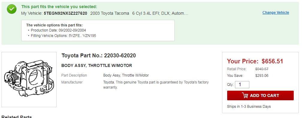

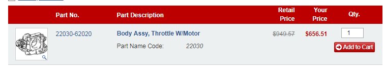

    thanks, that is a lot of good technical info! i found 89452-35030 at toyotapartsdeal.com back in March/april and they were selling the whole T.B. and TPS for $675(about), (dealer wanted about $1187)but i just checked now and didnt see it! i might have search wrong or it may no longer be available. i believe i may have temporarily cured my problem, back in april, after reading up more on what people did. i did this:
    1)pulled the + battery terminal off the battery overnight (10 + hrs). some people say only about 20-30 min. is needed to reset, but my overnighter worked better to reset everything.
    2) pulled off the TPS, phsyically semi rotated (in both directions)the arm plate with tabs(forgot the name of that component) oh so ever gently, then postioned it back onto the T.B.(make sure you note the tabs position where it lines up into the T.B.)
    3) reconnected the battery terminal, started it up, and then began to fiddle with adjusting the TPS, i found slightly moving it to give a good RPM idle a little difficult so i ended up with an initial idle RPM of 1250 RPMs(i know thats way too high), i aslo found out the computer was trying to compensate for a normal idle(RPMs were flucuating), over the next few days i worked the idle down to about 800 RPMs(yes the CEL came on and pooped the code for irratic/overclocked idle), once it was down to 800 the light did go off and everything performed very good, no lagging, no eratic behavior.
    4) so now its almost august and i noticed about a month ago the idle migrated down to about 580-620ish rpm for idle(it does have a slight rough idle, from probably being so low). upon deceleration while driving, the rpms will drop down to about 600( instead of keeping a temporary rpm of about 1000) upon re-aceleration this would cause a very slight surge or gap(very slight lagtime)
    5) but since i did what i did, its a whole lot better than before and is probably going to get worse again but thats it! if you can understand my instructions without your eyes glazing over this may be an option for you. thanks!

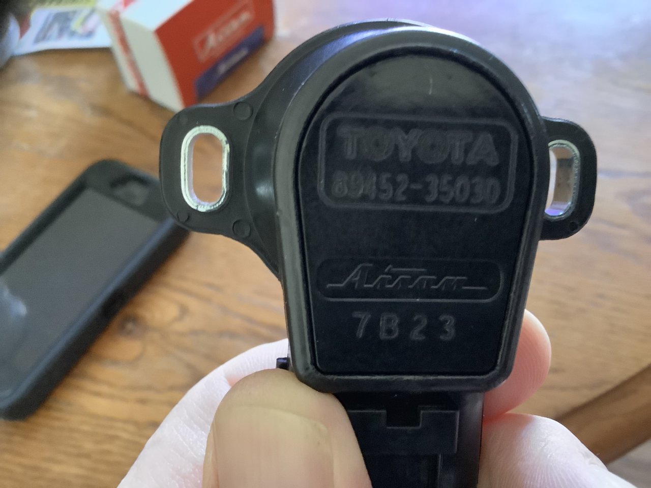

    If anyone is having difficulty finding this part, I just ordered one from091E8647-63B1-48BE-853C-CF099B5D4A5C.jpg 07159FE1-8756-4CCE-B6A7-BE1158EF9B05.jpg Parts Geek. It is manufactured by Aisin, who makes the part for Toyota. It came today and is even stamped with the Toyota part number 89452-35030. It has 4 pins.

    Been pretty darn frustrated with this issue and lurking here for a while. Was happy to find one made by Aisin. Now I Need to install and figure out how to position it correctly.
