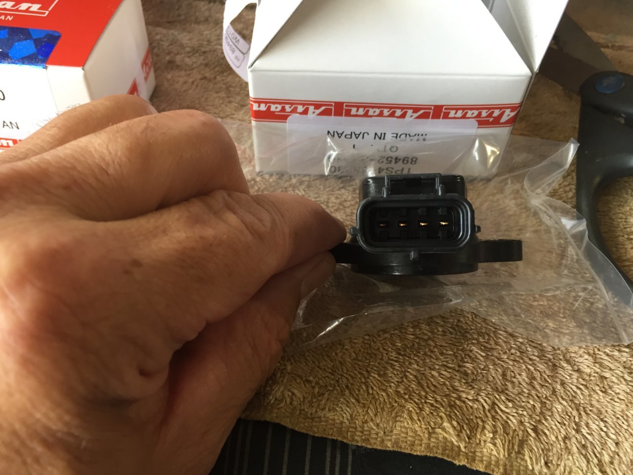

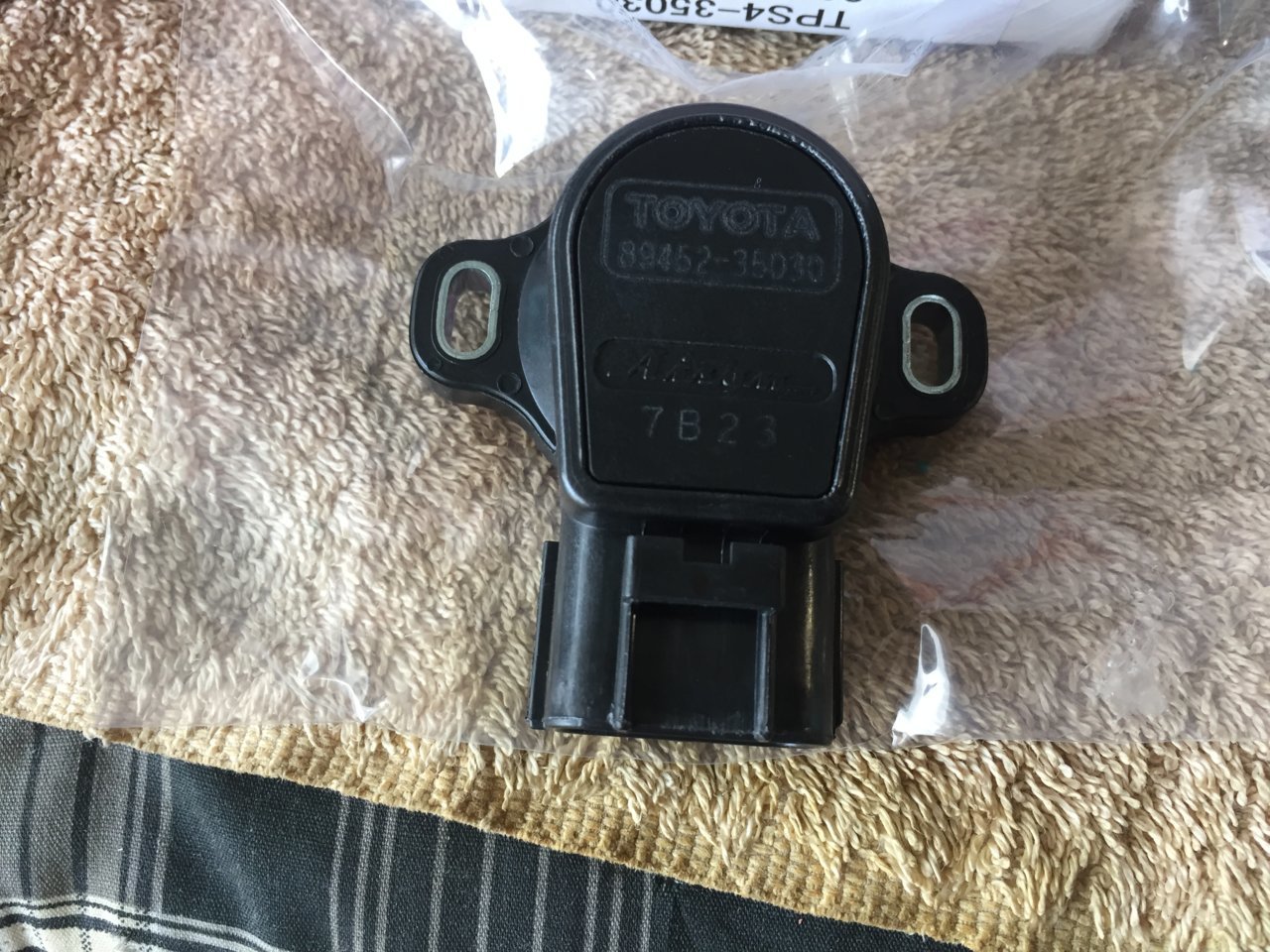

    Gasman and mechicjon - i went to parts geek from mechicjon's link and found the TPS, your TPS PN(like mine)is 89452-35030(below). i notice under the AISAN stamp yours has "7B23" mine has "2H06" does this mean anything as far as application? According to Part geeks the asian PN is W0133-2744128. Did you order that and what you got is what you are showing a pic of? Why does your box show 89452-35030 and Parts geek list it as W0133-2744128? am i missing something? I did notice it does have the 4 pins though. oh and hope this testing procedure works for someone(its under the TPS pic labled "OVI TPS TESTING,PDF FILE).

    I am going to guess that the W0133 number is the number Parts Geeks assigned for their inventory system. That is the same one I ordered. I will be installing mine sometime this weekend and will get a better look at the new part vs the old part. Had a bit of difficulty getting the bottom screw out tonight. I will certainly be replacing with an allen head. As for the 2H06 vs 7B23, I will go out on a limb and guess that this identifies the production run when Aisin made the part.

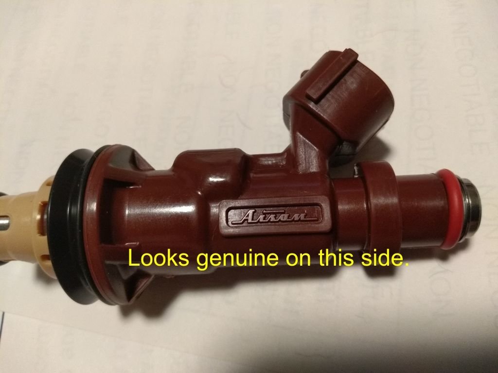

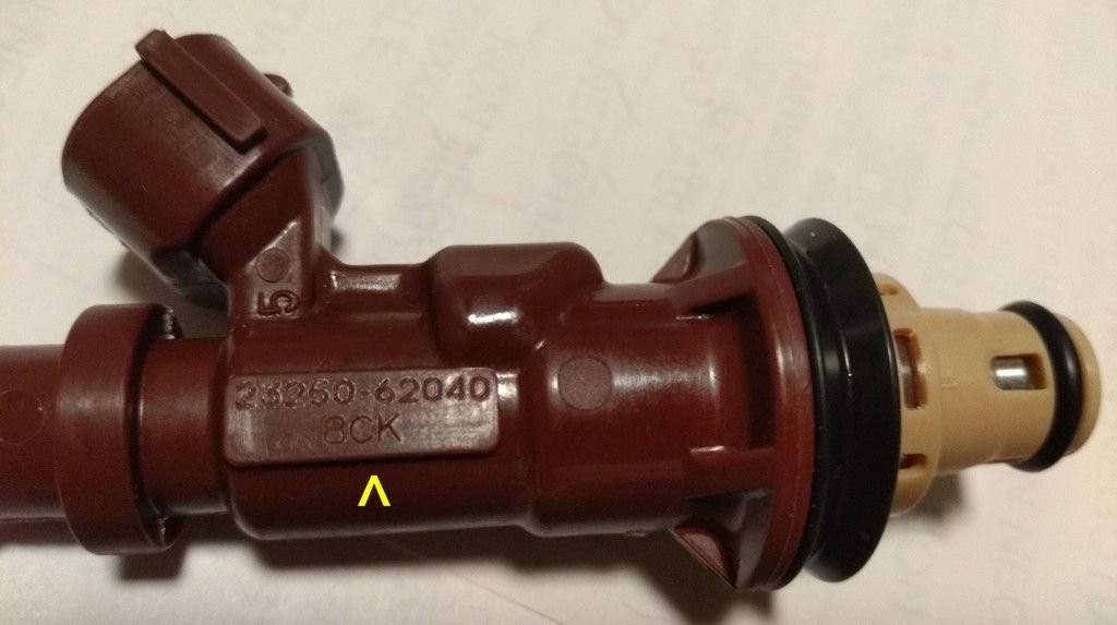

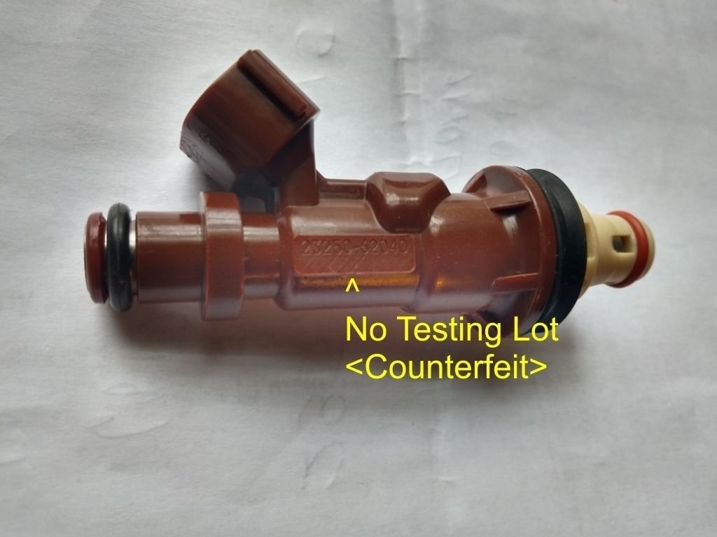

    I think you are right. Genuine injectors use numbers like those to identify testing lot numbers. If they don't have the number, some number of injectors in the lot failed and the entire lot was scrapped or they are counterfeit and untested.

    Side note: Here's an Aisan injector with the testing lot number below.
    This injector has a good testing lot number.
    The injector without the lot number is counterfeit or the lot failed to test and was scrapped.
    Beware of any Aisan labeled parts without the lot number.

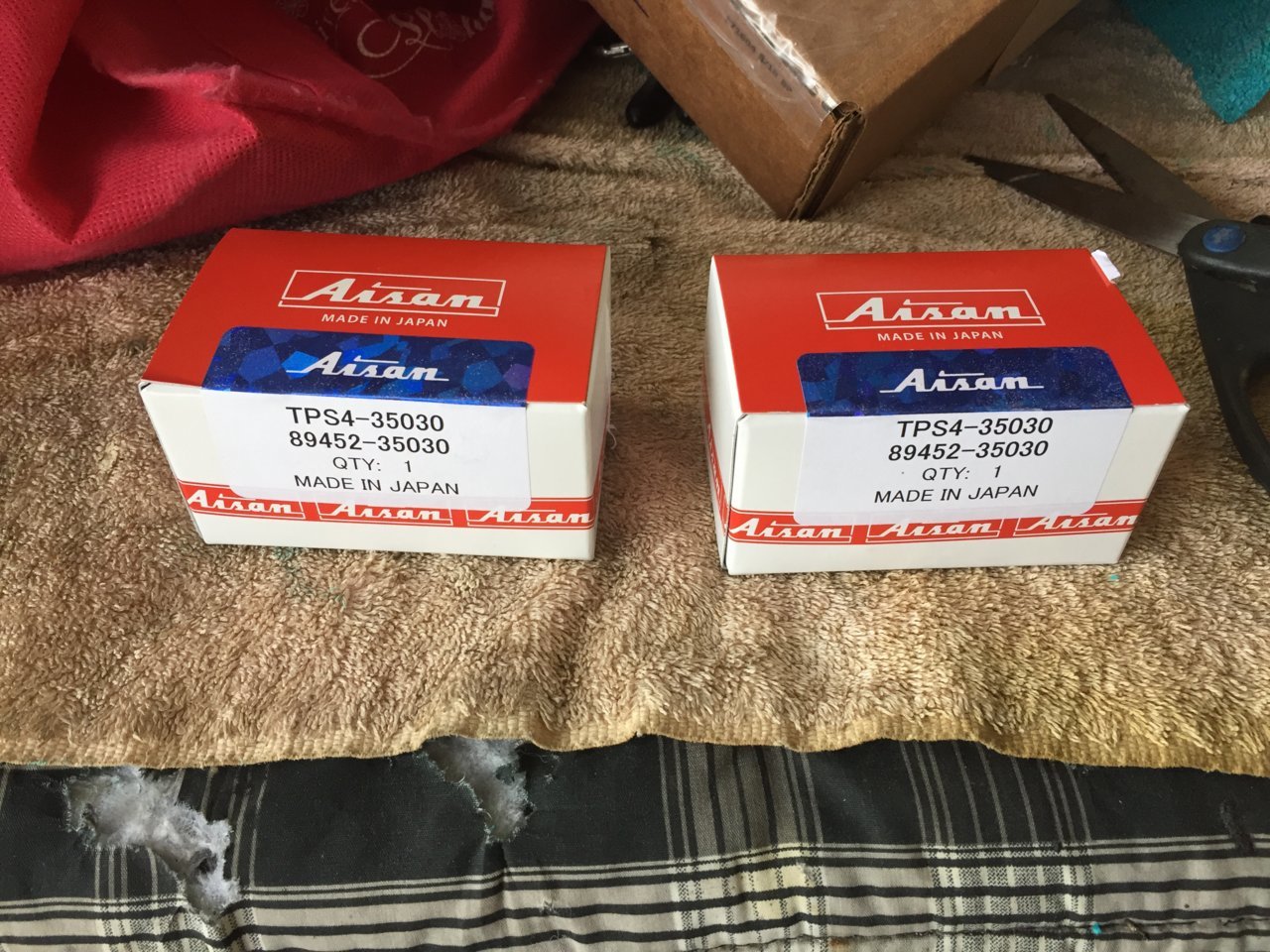

    B3F71427-9021-4C28-9A95-439E3AF4F1F3.jpg 94284A61-15D1-4F25-A5DE-CF317E285C1E.jpg 8284EE3B-C093-43DF-BDEC-F10122039AFF.jpg Alrighty then!!! Its my turn... UPS jus delivered mine. And they do have different lot #’s
