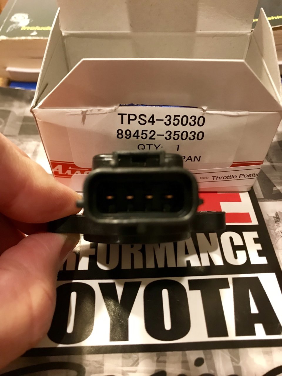

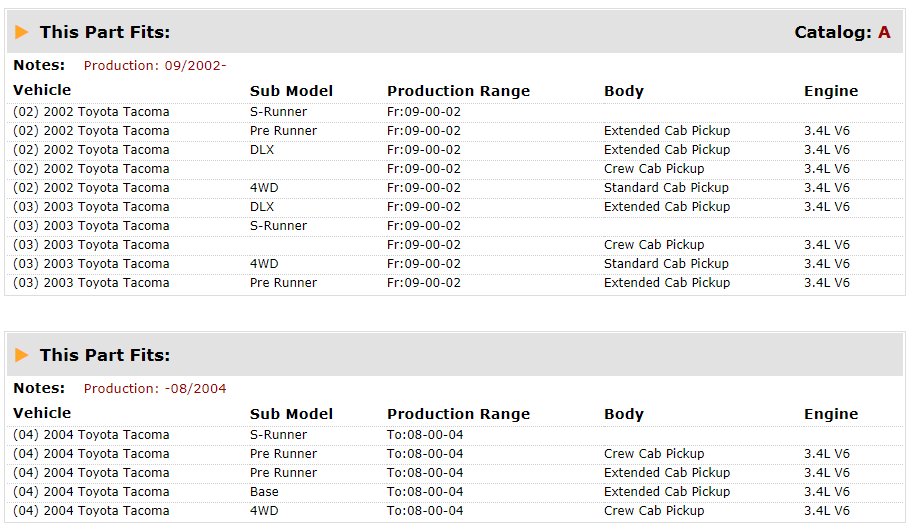

    Did anyone else here fix their problems with the new TPS?
    I just noticed something on the Partsgeek website- while checking if they had any left in stock-they do not.
    It's says "production: -08/2004"
    I'm glad some guys got their TPS. But I hope this run wasn't some left over stock found in a dusty warehouse corner after 15 years.

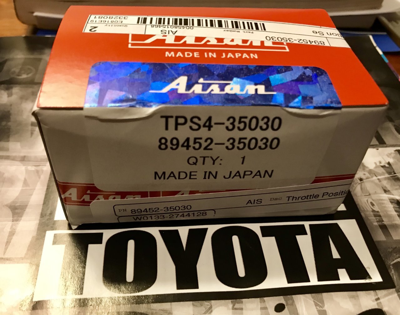

    Look what came in the mail Saturday!! Purchased from PartsGeek.
    Like ammo & prepping for Zombies.....but instead, a TPS in case you need it.

    I think what that means is that it is valid for vehicles produced through 08/2004. If you look at their site notes, it shows:
    Another way to look at it is - its better than paying full cost for the entire assembly, right? To me, it would be worth a chance at less than 50 bones. :taco:
