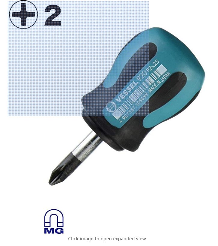

    I just ordered and in stalled this one on my 99 model 3.4L from eBay. I got rid of the P0120 code and it runs little better.
    Note this is the 89452-35020 model for a 1999.
    It will NOT work for a later model that calls for 89452-35030.
    Look for the DENSO testing lot number before you buy. This one's number is 10K01.
    I ordered a stubby JIS driver. I luckily removed the JIS screws with a Phillips without stripping it.
    Be careful if you do not have a stubby JIS like the one in this picture.

    I can honestly say I learned something new today. When I was working on cars for a living there was no JIS screwdriver offered on any proffesional tool truck. (That was over 15 years ago when I changed professions) I'd never heard of a JIS driver until today.
    #97

    After stripping a few, learned there had to be something wrong and needed a Japanese spec tool.
