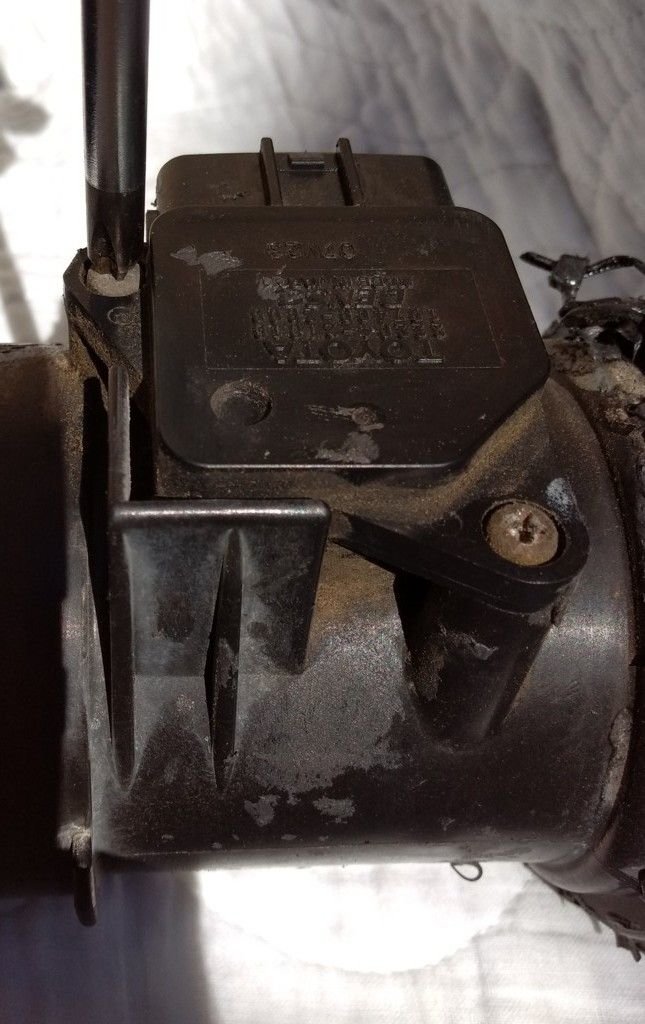

    MAF screws are JIS. Looks like one had been mangled at some point before I bought it.

    Klein makes a stubby w/ removable #1&2 flathead & Phillips that works perfectly with the maf screws. $11.00 at home derpo.

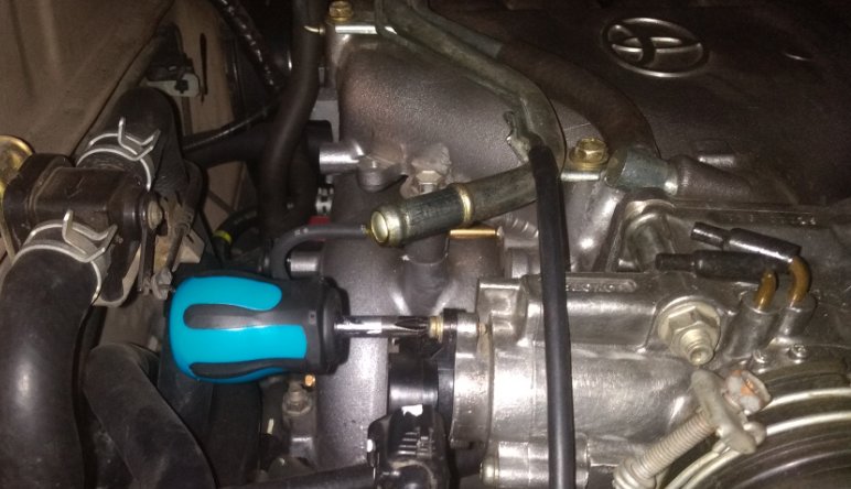

    The stubby JIS just arrived this afternoon. This one fit the TPS screws so perfectly that its like plugging into a socket.
