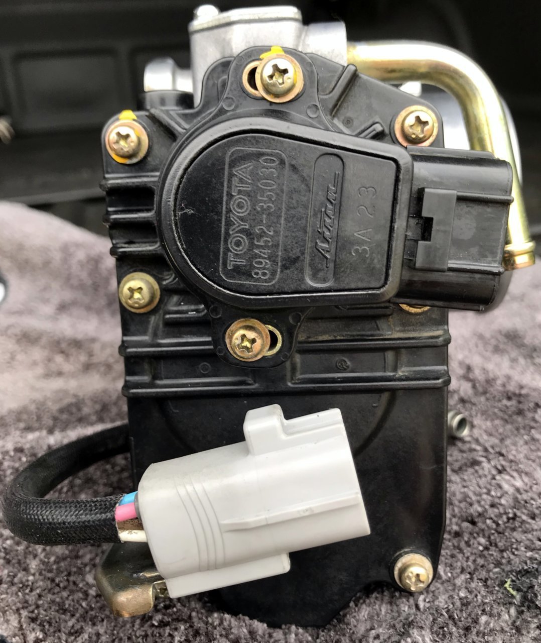

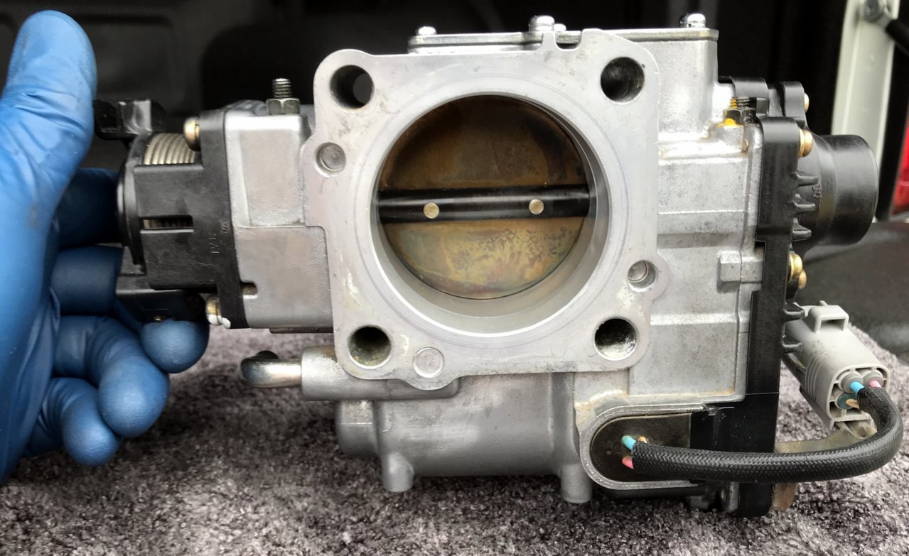

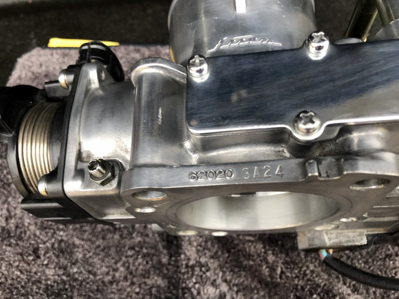

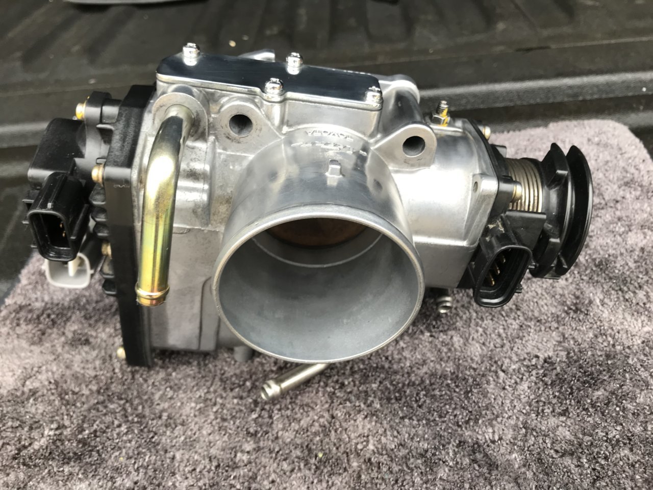

    Replaced the PVC Valve/Rubber Grommet this weekend on my '03 3.4, and wanted to provide some more pics of the Throttle Body/ECM Motor. I'm a Toyota Tacoma nerd and always like trying to figure out the numbers I see on some of the parts (Pic below).
    The TPS sensor is stock (89452-35030). Below that number is 3A23.
    What's interesting to me is that the number stamped on the throttle body is 3A24.

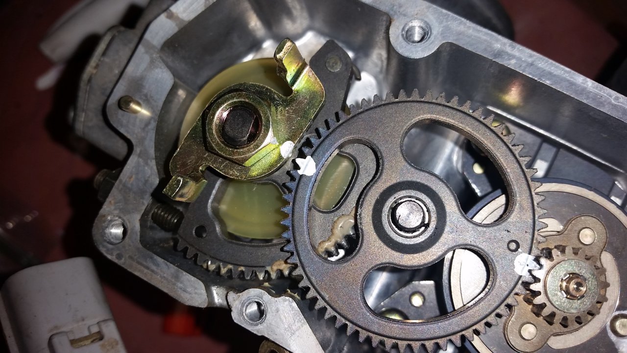

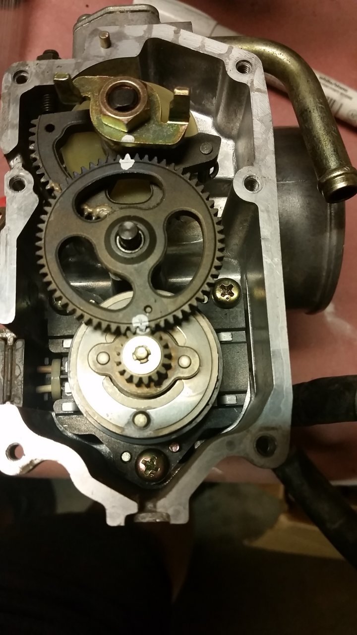

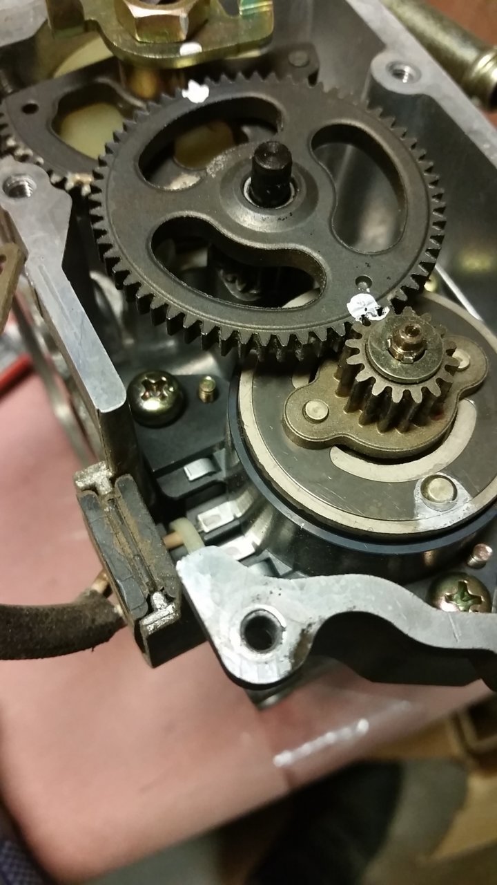

    Heres some for you.
    jammer[QUOTED] likes this.

    Very Cool. Always wondered what was behind the plastic.
    Thanks for sharing

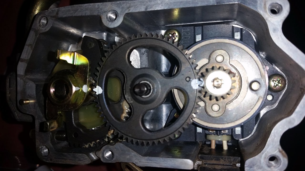

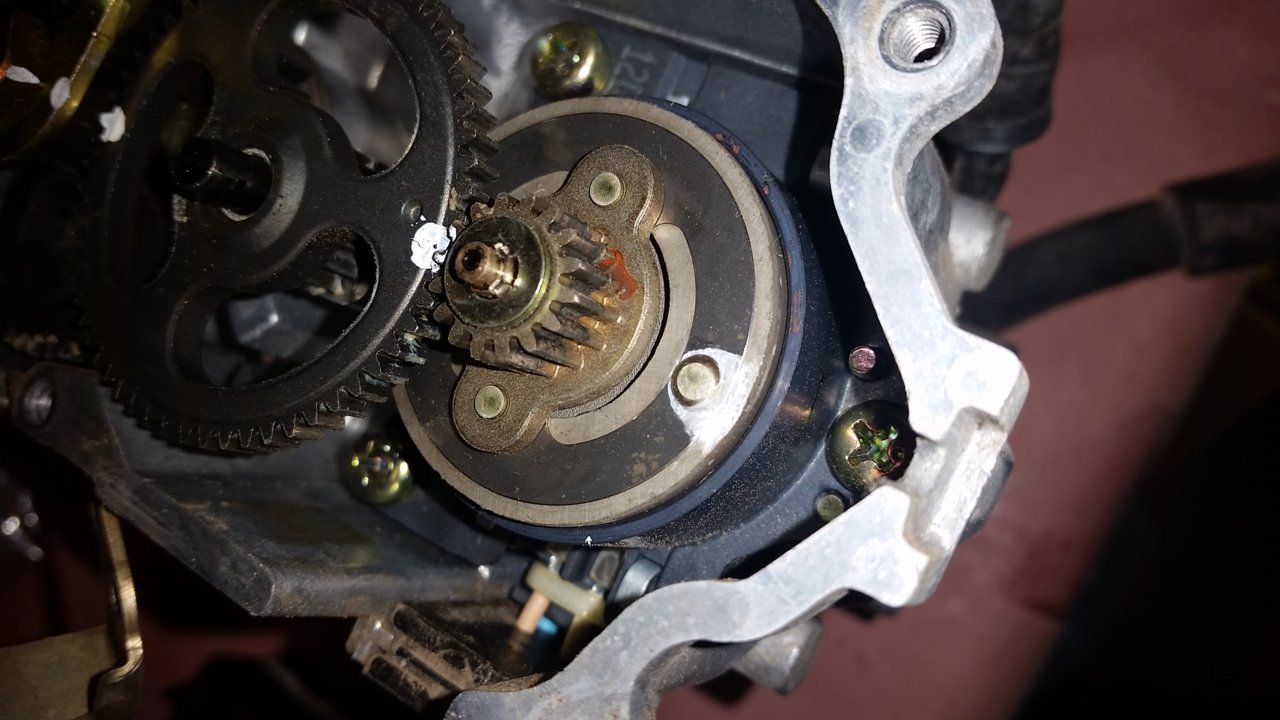

    A few more.
    jammer likes this.

    Did you put the white paint marks on the gears?
  7. Oct 28, 2019 at 6:55 PM
    #127
    mechanicjon
    mechanicjon They call me "Jonny Stubs"
    Dec 2, 2016
    #203828
    10,149
    Jon
    Scottsdale Arizona
    04 Taco SC 4dr SR5 TRD Prerunner
    Supercharged, AEM FIC/6, Meth Inj, ION Alloy's, Radio & Phone steering Wheel controls,Fabtech AAL, Billie's wrapped with 880's , Tundra big brake conversion, bully bars and Pioneer DDin Stereo/dvd with exterrnal usb ports. 290K and going strong.
    No they were there.
