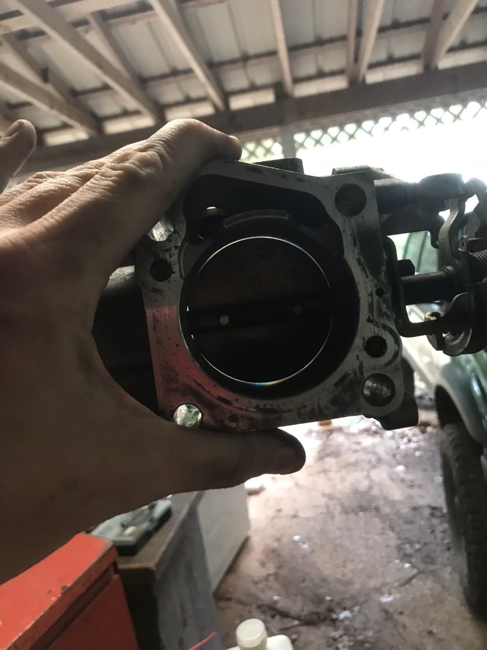

    I took this ^ pic of my throttle body. Should you be able to see that much light Around that throttle plate??
    The throttle plate is closed but if I push on it a little bit it closes that gap a bit..
    is that normal? Or does it need to be adjusted? 51159034-765D-4561-9F22-E8ABE1F08CD3.jpg

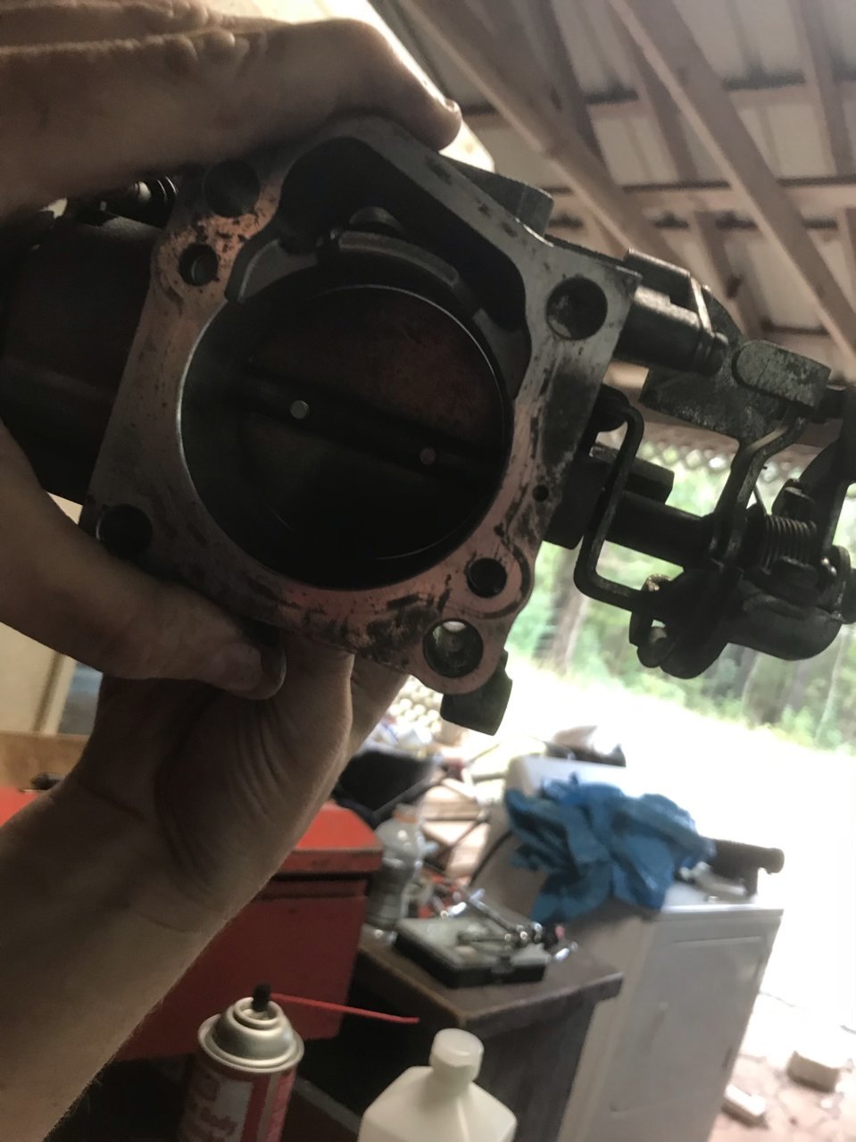

    In the 2nd pic my right hand is pushing the bottom of the throttle plate from the back closing the gap.
