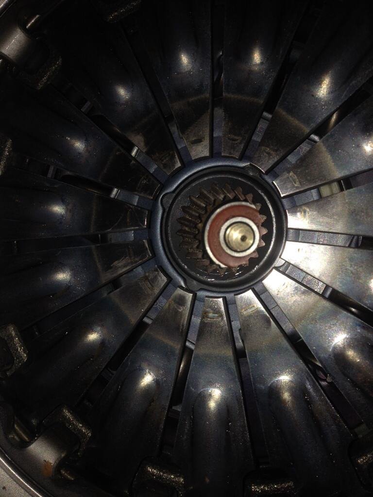

    Alright my truck is a 1996 tacoma 3.4l manual with the r150(f?) transmission
    Back story:
    Bought the truck cheap with a clutch that was at the end of it's life ( didn't shift very well at all but no noises)
    Decided to get a marlin crawler clutch installed.
    During install the shop informed me there was no pilot bearing on the input shaft.
    They installed it an told me everything went smooth
    1000 miles later I hear a chirping whenever my foots not on the clutch.
    After 2 weeks of bugging both parties I got a discounted rate on install and I got marlin crawler to cover labor and a new kit.
    Got the new kit installed and after 200 miles it had begun chirping (much quieter because I was weary of it this time)
    Well because of how hard it was to get them to cover the cost last time and the fact that I almost got stuck with the bill I decide I would do it this time, so now I have my transmission (and tcase) pulled and I'm trying to figure out what all I need to replace.
    THE PARTS:
    So the first time they replaced everything it looked like the TOB was seizing on the pressure plate(marks around the fingers) and in inspecting the TOB there were no signs of physical wear except a very small wobble between the inner and outer parts of the bearing
    The TOB I just pulled had the same wobble between the inner and outer parts, an. Also wobbled on the input shaft as well (felt like the inner part was a little too wide for the Shaft)
    And it left the same marks (but lesser) on the pressure plate:epuhu6et_f85d5233e0c897e369507cbf4ea77e8df5dc7fe6.jpg
    So what so I need to replace? Could it be I got to faulty TOBs when marlin crawler claimed they had never had a faulty TOB before? Could my input shaft be causing wear on the TOB causing early wear?
    I just need help. I hoped this clutch job would have been fine when They put it together the first time, but now I'm stuck doing the work myself, and Ive been out my new truck going on a month now

    I thought something like that might be the issue, but TOB seized up and wore groves on the pressure plate after only 200 miles, I don't think an input shaft bearing could cause that, would it?

    I've only done two clutch jobs in my lifetime so I do not profess to be an expert but, I don't think it is the TOB.
    Here's my clutch cover with about 20k miles on it:
    I've got similar scoring as you do and they make sense to me.
    1. The shiny thin band scoring is from where the TOB makes contact with the springs to release the clutch. To release the clutch springs takes a lot of pressure, hence the markings. I mean, shit, you're stepping on a pedal which is helped by hydraulics to move the fork to press the TOB against the pressure plate spring fingers. From what little I know of metallurgy, it wouldn't make many uses to get it looking that way.
    2. The outer band markings are from where the throwout bearing rubs more lightly as it engages and disengages.
    3. If the chirping happens when the clutch pedal is not depressed, it would tell me the problem lies elsewhere. The TOB is not doing anything under those circumstances. There's no pressure on it, just free spinning on the transmission input shaft. Typically, when TOBs are going out, they squeal due to hot bearings when the clutch pedal is depressed (it is under pressure).
    4. I have the same clutch kit and have had no issues. The bearings are high quality. It would seem odd to me that the same problem has occurred with two different TOB.
    I don't know where else to look except at the pilot bearing and the input bearing to the transmission.
    What exactly do you mean by the TOB was seizing on the pressure plate?

    I thought it was seizing because of the amount of scoring on the pressure plates after such little use.
    The chirping did go away for about 200 miles after the replacement clutch got put in.
    It's interesting you say it might be the pilot bearing, as it didn't chirp on the original clutch, but the shop said there was no pilot bearing in it originally, then it started tweeting after they put one in?

    The chirp wasn't bad this second clutch when I only drove it 200 miles, but the first clutch after I drove it 1500 miles it was pretty noticeable.
    In trying to find the noise I found it was much louder and cleared when I listened through the clutch fork hole.
    I was thinking that maybe the TOB was the issue, and the wobble I'm noticing between on the TOB is causing the chirping, and putting pressure on the TOB with the clutch fork is stabilizing the TOB and making it quit chirping. Is this possible? (I'm not all that familiar with transmissions)

    With 2 new clutch release bearings recently installed , I would think that the free play adjustment wasnt done properly . If you follow Toyotas FSM , they want free play at the top of the pedal to prevent the release bearing from turning all the time .
    If you are looking through the bell housing with a flashlight , is the release bearing turning while the engine is running ?
    Our Tacomas do not use a self adjusting clutch , therefore the release bearing is semi centrifical rather than fully centrifical .
    Here is the adjustment procedure http://www.customtacos.com/tech.old...6toyrm/06toypdf/06rmsrc/rm2006ta/02900510.pdf
    The duty of the pilot bearing is to support the centrifical weight of the clutch disc when you push the clutch pedal down to the floor . With this said , the only time a pilot bearing will make noise is when your clutch disc is moved away from the flywheel.
    If the pilot bearing was missing for a period of time , other components within the transmission had to take that load .
    I beleive the 6 speeds no longer use a pilot bearing and have design implementations to the input shaft , input shaft front bearing as well as the input to output shaft bearing to accomodate this extra load . I still beleive the design needs improvement . They should have kept the pilot bearing in the 6 speed .
    Getting back to your transmission , I would also be looking at the input shaft run out .

    I guess it's possible they didn't adjust the clutch, I wish I could pore that some how and get my money back, but I already have the transmission out.
    So do I need to put a new pressure plate in there do you think?
    Or just a new TOB and adjust?
    Also I looked at that link, but I still don't understand how to Check for input shaft runout

    This post gives you service specifications
    http://www.customtacos.com/tech.old...6toyrm/06toypdf/06rmsrc/rm2006ta/00302610.pdf
    This post shows you how to check the clutch and how to check the release bearing .
    Now that the transmission is out , does the release bearing feel rough ?
    http://www.customtacos.com/tech.old...6toyrm/06toypdf/06rmsrc/rm2006ta/02901310.pdf
    For checking the input shaft run out , I couldnt find anything in the manual to use as a guide to show you . How much movement does the input shaft have if you were to lift it up and down and back and forth by hand ? this is usually done with a dial indicator . Its going to be a good idea to check the input shaft since the pilot bearing was missing . Maybe the input shaft is good and its just circumstancial that two release bearings failed .
    There was no explanation in the manual for bell housing run out either . If Bell housing run out is off , it can cause the release bearing to side load on the pressure plate fingers

    So I'm pretty convinced that the shop didn't adjust my clutch, after a talk with the mechanic he said "my hydraulic clutch doesn't need adjustment because it's hydraulic" there's that. Not going back to the mechanic again.
    I'm going to replace the TOB while I've got the transmission out, then I'm going to put it all back together and adjust the clutch and hopefully that will remedy all this dumb mess.
    Thank you everyone for all your help! Is there anything I need to remember when putting the transmission back together? Do I have to realign the clutch if I never removed it? I know you're supposed to put the input shaft in without putting pressure on the clutch, but is there any other things I should be careful of? I've never done this before.
