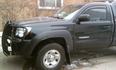

    I been noticing this dull thump from the driver side front end when going over bumps. Like something banging against something else. It's been there since day one.
    The weather cleared and got warm enough to wash and wax my truck (isn't that GREAT!) anyway, I apply wax to truck and after it's dried start to wipe it off.
    As I'm removing the wax from the drivers side fender just to the rear of the cornering lamp.... THUD, THUD, THUD! As I'm wiping back and forth removing wax the FENDER IS MOVING and making that GD THUMPING sound! I've tightened the fender and the truck is now quiet as a Cadillac.
