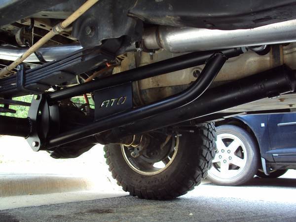

    This cured my axle wrap:
    I had axle wrap resulting in slip yoke bind on both my one-piece Tom Woods shaft and the stock Toyota shaft. The axle wraps and then has a difficult time *unwrapping* when you brake to a stop, resulting in slip-yoke bind.
    I don't think the lube is stopping the axle wrap, just the binding. Either way, it gets rid of your clunk, so I'd consider it a good-enough fix if you're staying on pavement. If you're towing a lot or getting offroad, I would still want a true fix for the wrapping issue itself.

    ^^^^^^That is a nice setup but is not in budget and overkill for most of us who see limited off roading.
    I think it depends if you truly have axle wrap or if you have slip yoke bind.
    I clamped my springs and the problem was still there so it eliminated axle wrap out of the equation. This is why I ventured into greasing the slip yoke.
    I know axle wrap can occur and does on a number of vehicles with age/towing/ and wheeling since toyota sucks at setting up a real suspension in these trucks.
    I am just hear to spread the word to grease the slip yoke for us mall rats to see if it solves the problem before dropping cash on a AAL or a leaf pack to only have the same problem still.

    I would agree.
    Not necessarily. Spring clamps only stiffen the spring rate. If it's floppy weak to begin with, it may not have enough force to stop axle wrap even when clamped.
    This is why moving to aftermarket leaf packs sometimes cures axle wrap by itself. Stiffer spring = enough resistance to keep the axle in check.
    It's not a bad setup, it's just a compromise between clearance, load carrying, safe handling....trucks are asked to do a lot of things. As they say, you can be okay at many things or excellent at a few....
    No problem with that. What I'm saying is your axle is probably still wrapping, it's just that now the slip yoke doesn't bind...it slides back into position without thumping when you brake to a stop. Which is fine - that's one of the purposes of the slip yoke in the first place. ToMoCo expects the axles on these trucks to wrap a little bit (it's impossible to prevent completely without a traction bar or links on a SOA leaf spring suspension) so they built it such that there are tolerances (slip yoke, u-joints) that can absorb the minor shift and keep things in spec enough to prevent damage.
