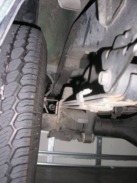

    So here goes, ... Look and you shall find. Chris4x4 and Tacomaman06 pointed me in the right direction. I posted a question B-4 I used the search option here on TW. Now I know to search this awsome Forum for information. Axle Wrap is caused by this photo on my 1999 4x4. The springs are gone, worn slap out as Tacomaman06 would say. Have a look and see, they actually bend in the WRONG Direction. I don't have the ca$h to do a complete lift at the moment, and I just bought new tires, so I will get the wheelers 4 leaf to fix this problem.

    4.10 gears, sliders, and lots of buttons.
    Your springs look about normal. Tacomas have a "reverse arch" to their rear leaves, for better off road flex. The side effext is axel wrap. Fixed with an AAL, or replacement leaf packs. You will know when your springs are shot, as the ride will become harsh.
