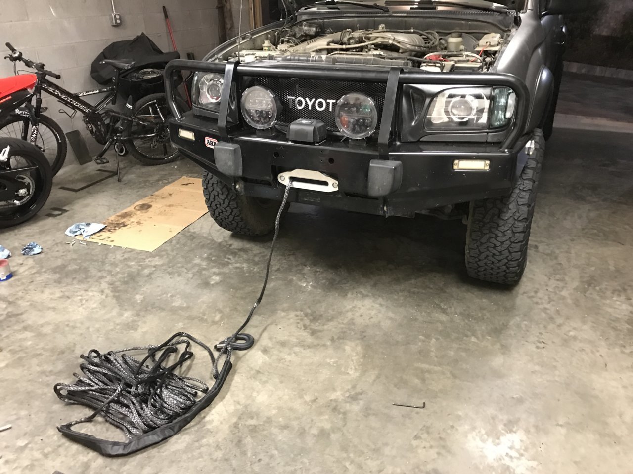

    In the process of installing this Shittybilt X20, the control box will not work in any of the "factory" locations so I'm going to have to make a bracket so I can mount it to the top of the bumper, either that or use some industrial velcro or 3M double sided tape. I'll try the bracket first, but I may just go the lazy route and slap it on there with some sticky.

    Seems more like a shitty bumper design that doesn't have room for the solenoid control box for any winch model.

    There's a super small list of Warn winches that it fits with. There's also a couple of brackets and stuff that I either tossed many years ago or they are in the garage at my mom's house.

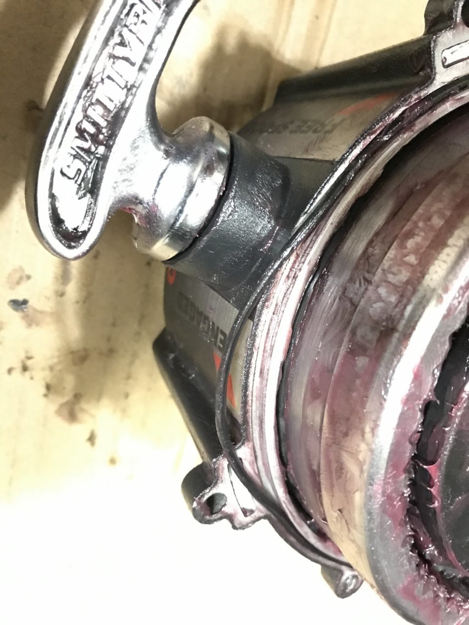

    Welp, not finishing this project this week.

    What are we looking at? Gasket break?
    if so, I’d have more confidence in a bead of silicone than that rubber band.

    Yeah, it's a giant o-ring that goes around the gear cover. I had just regreased the planetary gears with good quality grease and went to put it back on, it requires a little jimmying for everything to fall into place... then I went to clock it and that O ring started poking out from two directions haha.
    The other side is a flat rubber gasket, Idk why they didn't do that on this side.
