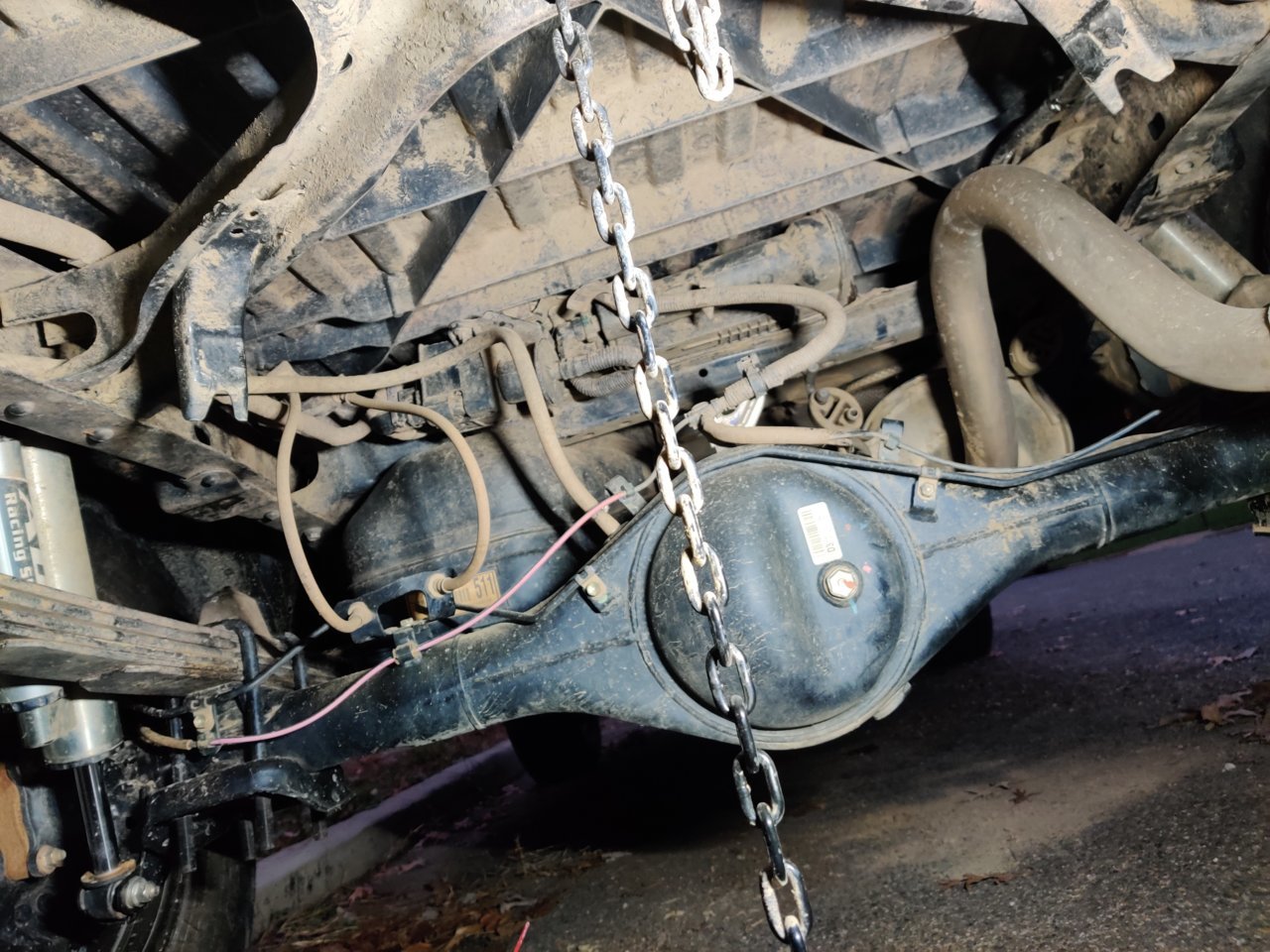

    Ok, so there has been a thunk coming from the back of my truck and it seems to be getting louder.
    Just to preface, I haven't brought this to the dealer yet because each time I bring in the truck I seem to get resistance due to the mods I've done.
    My Truck: 2020 OR with Icon 3aal and ADS shocks = 2-inch lift.
    The Symptom: When driving over potholes or bumpy roads there seems to be a thunk coming from the back passenger side of my truck. Honestly, it sounds like something big is loose. This sound does not appear from simply flexing the suspension, such as driving over something, but instead from rapid movement of the rear. Moving the truck side to side doesn't make the sound come out, but if I jump up and down on the bumper the sound is very much apparent as if someone is banging on it.
    What I've done so far: Re-torqued U-bolts to 120ftlb (per-Icon). Checked leaf bolts torque. Tightened bed bolts. Tightened spare tire. Generally grabbing of things to see if they're loose.
    I've attached two videos of me jumping up on down on the bumper, please ignore the leaf springs squeaking.
    This is the truck on the ground:
    This one is only the rear passenger tire on a ramp. It almost seems like the sound moved from the passenger side to the driver:
    Picture, figured I'd throw it in.
    Thanks for the help everyone, I'm genuinely stumped

    Thanks for the help everyone. I ended up removing the shocks and the sound went away. However, when I inspected them they appeared to be in good working order.
    So I reinstalled and poof, the sound went away. Gonna cough it up to poor initial installation.
