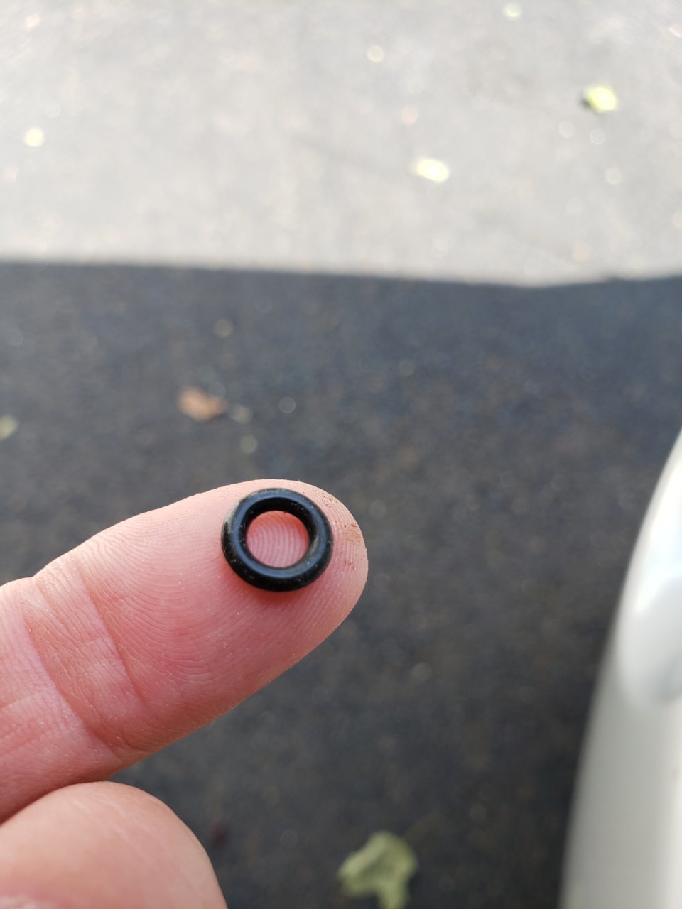

    Trying to pick up some washers on my way home tonight so what’s the inner diameter needed for the washers?

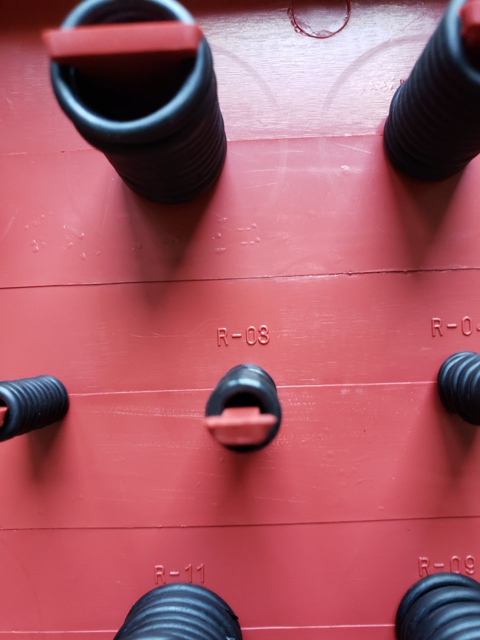

    I had constant ticking noise. Used three20200828_143240.jpg 20200828_142003.jpg 20200828_142141.jpg R-03 washers, two between the bolt head and the VSV and one on the other side of the VSV and the mount. Also included a zip tie between a flange that was a contact point between the valve and the mount. 99% of the ticking noise is gone. Most likely the fuel injector ticking is what's left.
    TireFire and Rick's 2012 like this.
