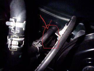

    Toyota is fixing my ticking at the moment. Way too loud to be normal engine ticking so i mentioned it when i went in to have a new radio ordered... they looked around and found that i am missing a large grommet. I think it is where the lines for the heat come through the firewall... not 100% on that (2 hoses atop one another going through the firewall on the drivers side). They ordered the part and will put it in when the radio gets there...
    If ya find that the ticking seems abnormally loud in the cab check and see that your truck came w/ all of your grommets. Maybe i'm not the only one with this issue...:D

    could you take a picture of the exact gromet you are talking about?

    Will do. I'll post it tomorrow after work.

    Ran out and took a pic w/ the cellphone and a flashlight. The missing grommet is to the left of the brake booster. Has 2 lines running through the firewall, probably a 1.5"x3" oval. Hope this helps, I'll take a better picture tomorrow.
