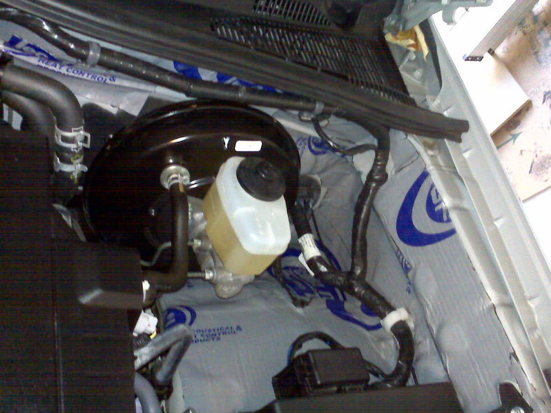

    Trying to neutralize ticking sound. I am becoming obsessed with this and need someone to tell me to relax. I just spent half day putting sound damper all over engine bay and adding wheel well reinforcement to block sound.
    Im i getting ridiculous with this, and does engine bay look shitty(see pic)
    By the way, all damper pads do is redirect noise to under the truck instead of just the driver side.

    I plan on blocking the extra openings in the wheel well too but the dampener might have been a little much, I think the noise is echoing through your manifolds so its going to be hard to stop.

    Im going to pack the entire engine bay with foam peanuts. that'll stop the noise:)

    I would like to see that swise, send some pics when completed.
