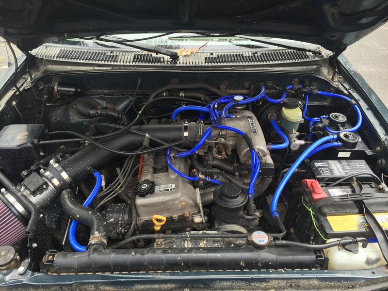

    Hey y'all have a 1996 Taco question. When my truck is running there is a ticking sound. Now this seems to only be in the cab, and under what i think in the steering column. When I am accelerating, even just a slight bit this sound goes away. Any ideas? By the way it is a 3rz motor if it matters.

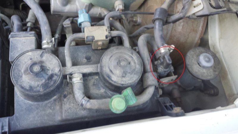

    regarding the possible evap issue. you can easily hear where the noise is coming from if it were either the valves or the VSV @nickj604 was talking about. when you get home from a drive, the noise should be happening. so just open the hood and stick your ear next to the cannister and around the top of the engine. it should be pretty distinct.
    here's the evap setup on my truck with the vsv circled. its rigth above the front driver tire. its more or less the same design. another thing about the VSV valve is it sometimes makes a bad clicking noise that travels throughout the cab. i think there was a recall on it. you can probably also stick a piece of rubber between it and where it mounts to try and dampen any noise coming from it. but thats only if this is the issue.

    I know what part you all are talking about i just replaced my whole vacuum line. So if i already replaced the lines could it need replacement? does this happen? But also i dont seem to see what you are talking about unless it is the part i am holding in the second photo. Also side note, is my motor supposed to be slightly tilted?

    Yup. This is my first truck, but i was replacing the lines anyways, it was this or candy apple red.

    yes, the part you are holding is the VSV. if, when the truck is warmed up, the switch is clicking, then the switch is good. its supposed to pulsate. sometimes they just pulsate really loudly. and if yours is mounted on the firewall, it will be noisier! try stuffing some slivers of rubber from a bicycle tube between any metal to metal surfaces around the switch.
    yes your motor should look slightly slanted. think of it this way. the power steering reservoir is mounted according to the tilt of the motor. is the reservoir sitting straight? yep
