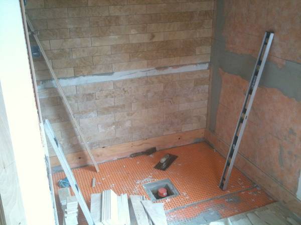

    This is a shower we are doing right now that will use the hybrid system .
    We have Ditra under the floor pan to isolate the future mud base from the heated slab below , there is Kerdi on the walls and we will pour a sloped mud base using the Schluter drain and Kerdi on top of the mud base .
