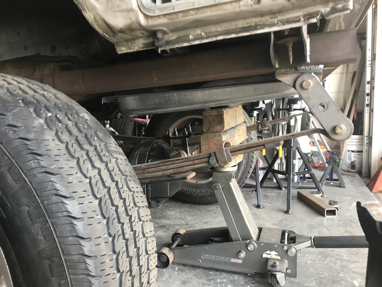

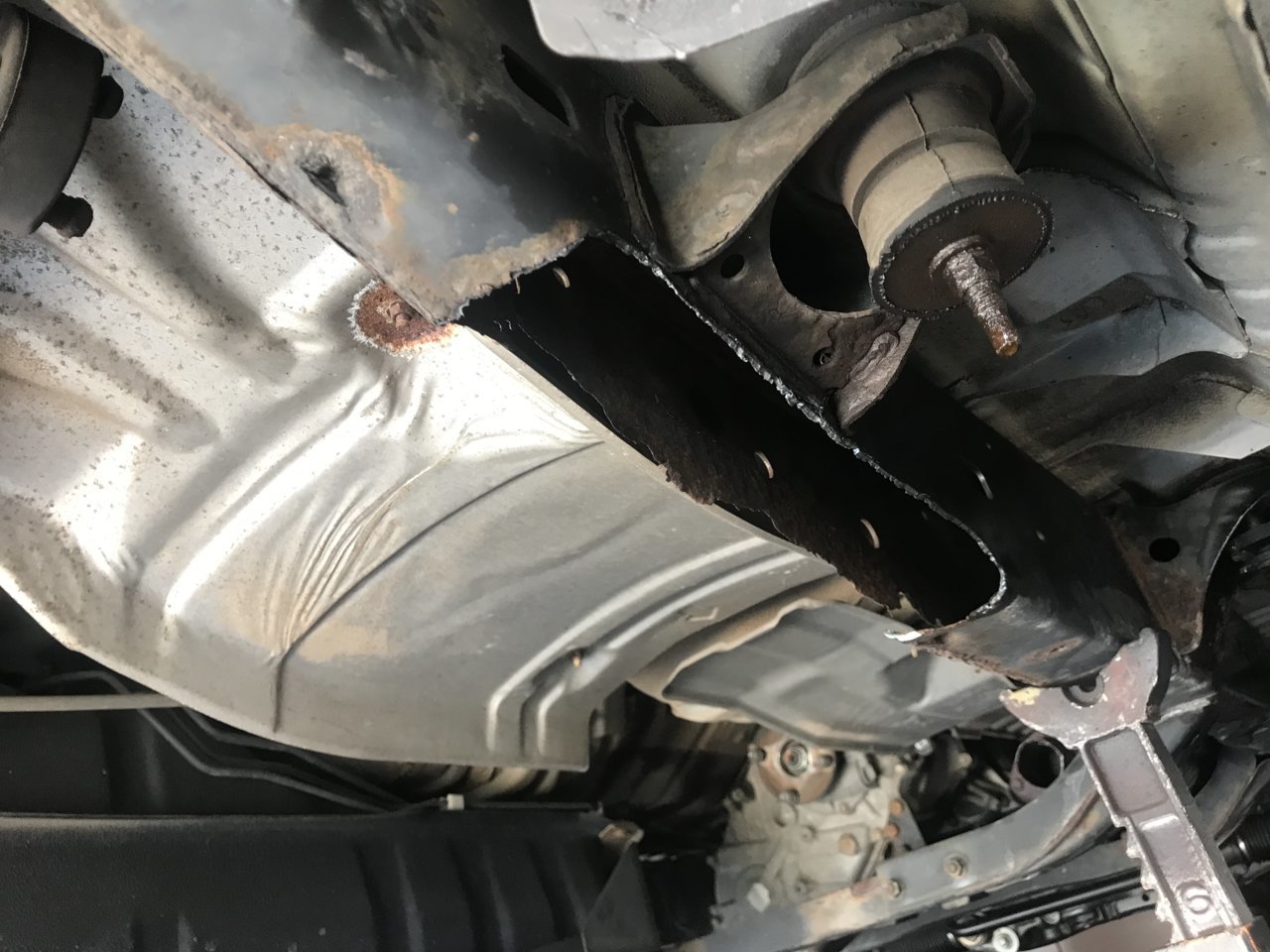

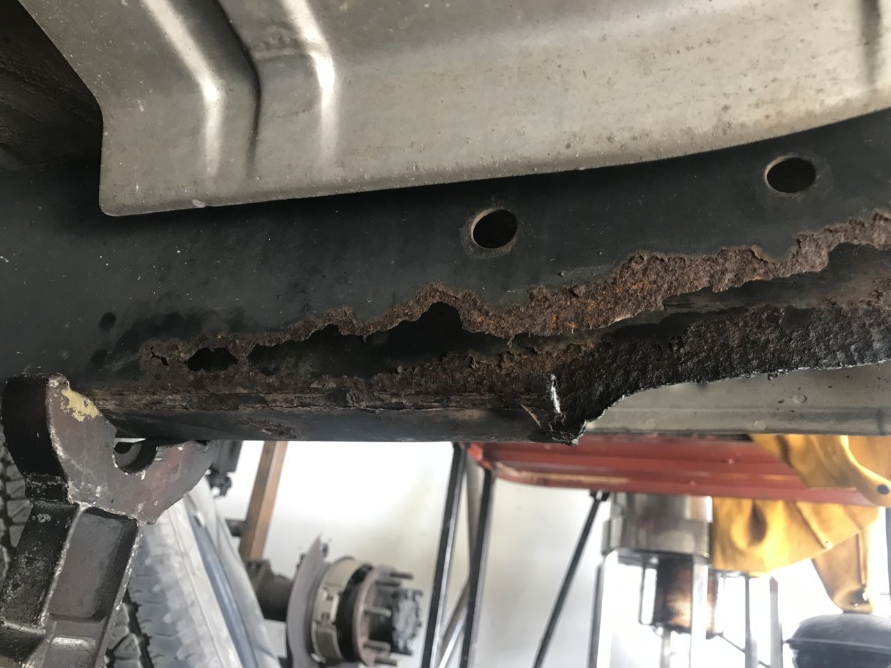

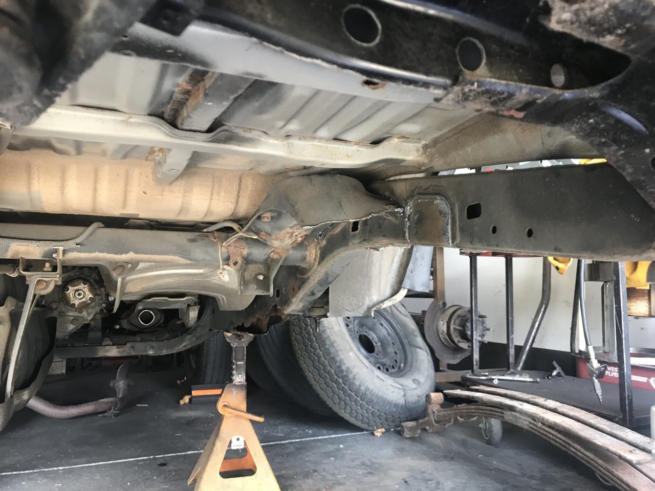

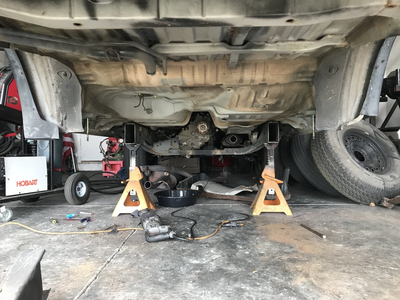

    Started to clear the brackets to plate the rear frame. But the rust god already touched its soul. Rear frame from under the rear seats back will be rebuilt with 2x3 square tube. Inside the frame was much worse then what I found outside the frame. Bunch of flakes/chunks of frame came out.

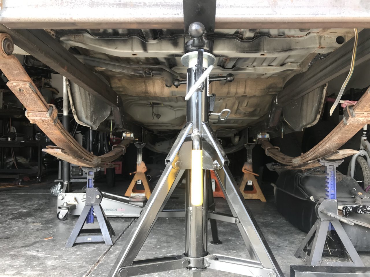

    So much room now for activities

    That is one way to get rid of some rust :thumbsup:

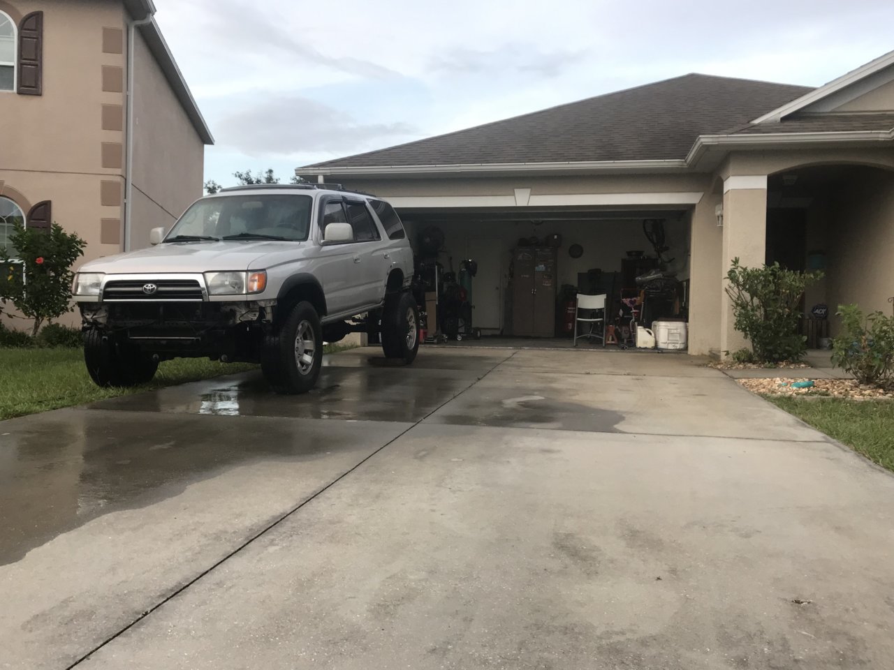

    Progress
    What a 40 looks like In a stock wheel well

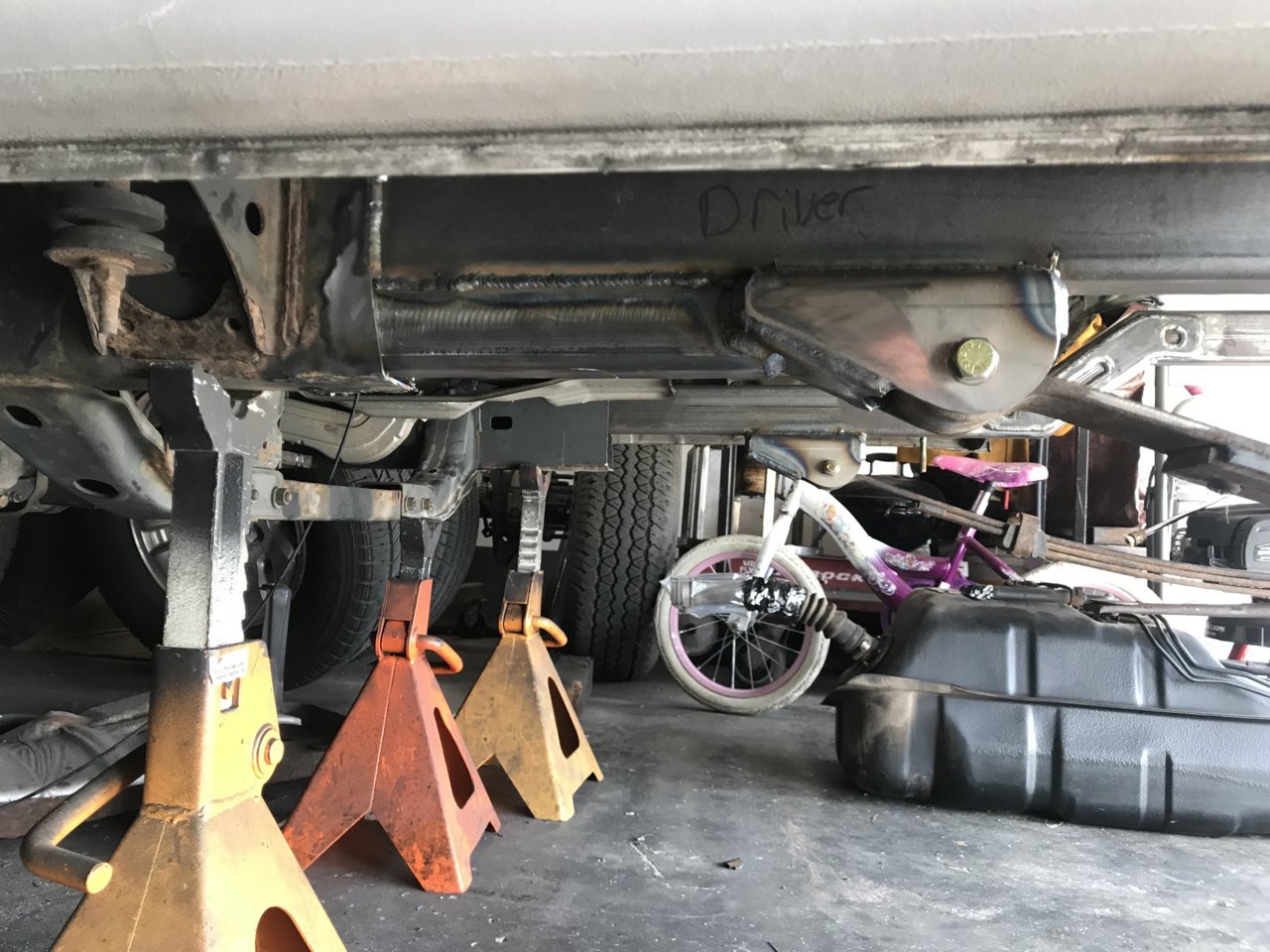

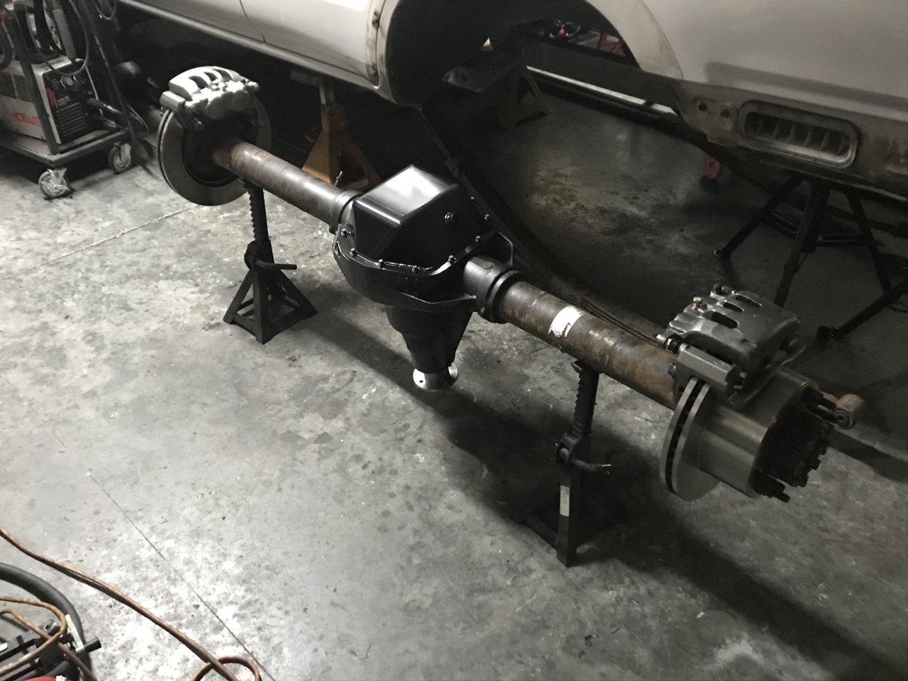

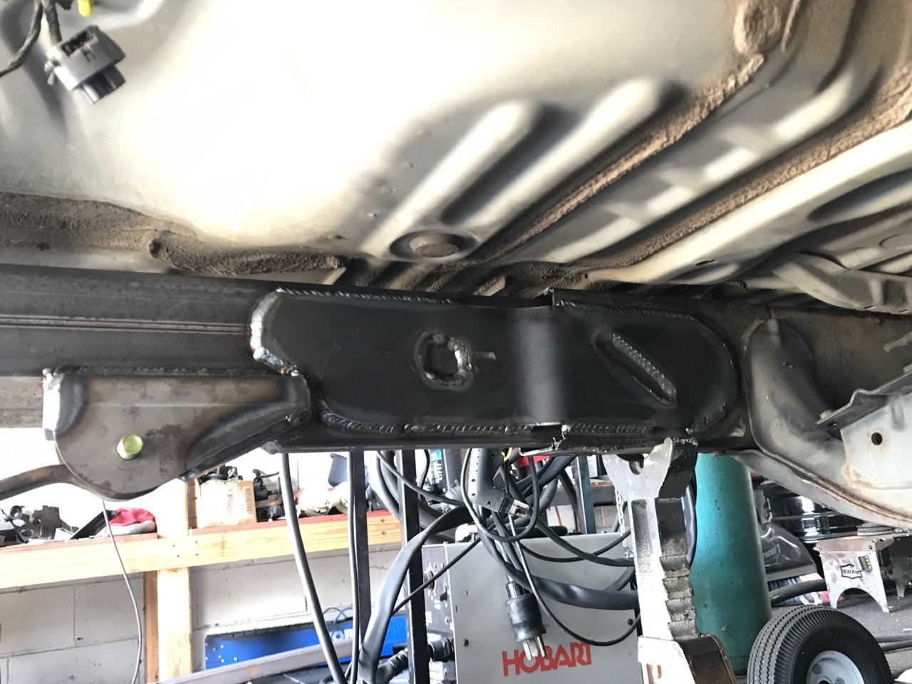

    Little update. Not much time has been spent on it. Got 2 frame plates welded on one inner almost before I ran out of wire.

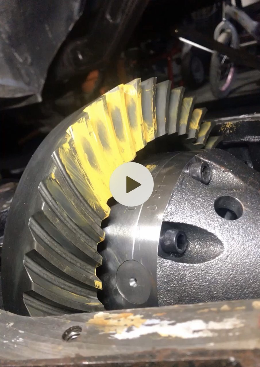

    Started to rebuild the rear axle and currently waiting on a drive flange to go to the stock driveshaft for the sterling axle. Should be quick since the guy said he just got a few done and stocked the shelf today.
    Have the rest of the frame plates to do and then I can get the rear axle under it enough to push it out and start on the front.
    Here’s what everyone likes

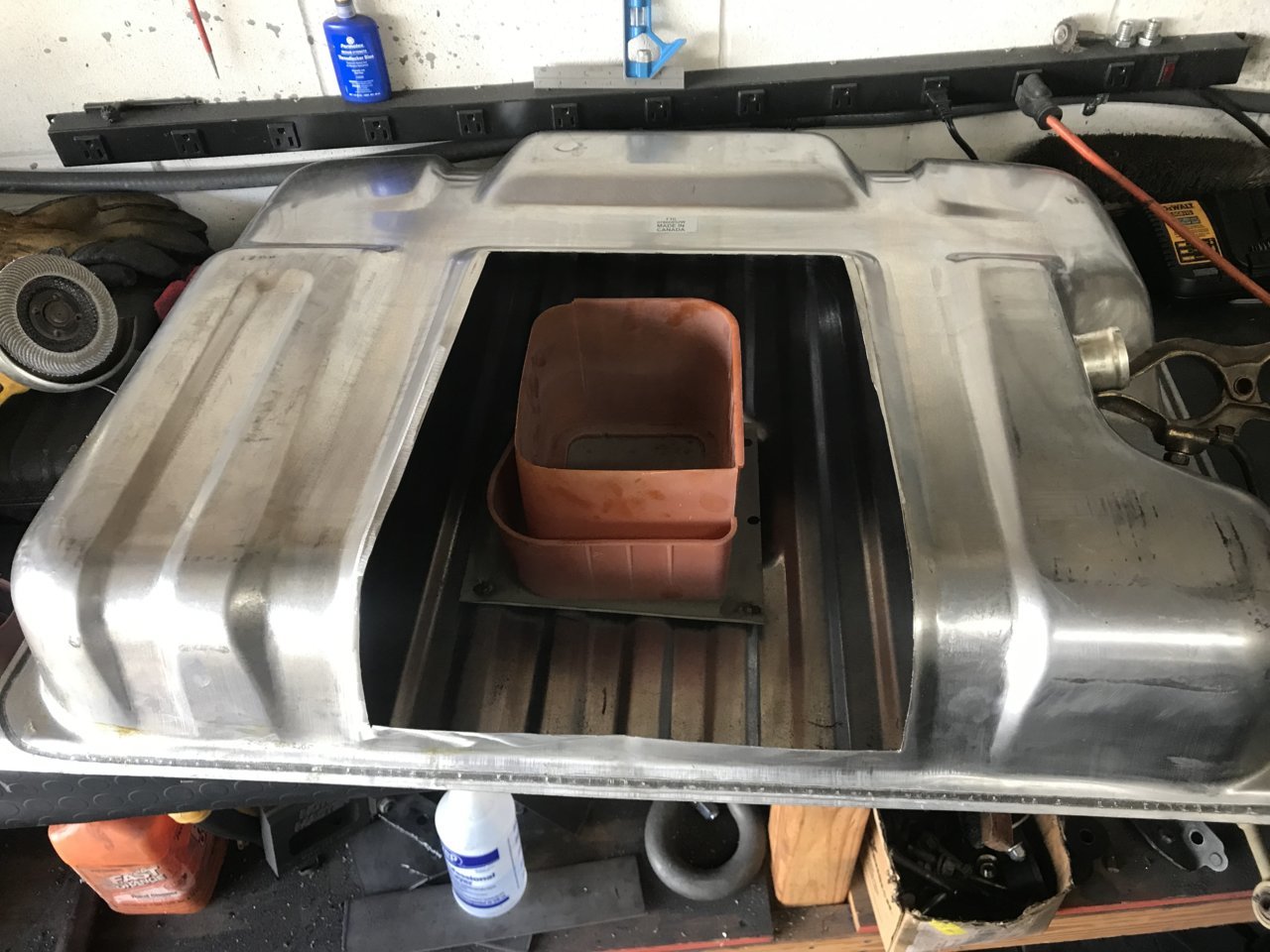

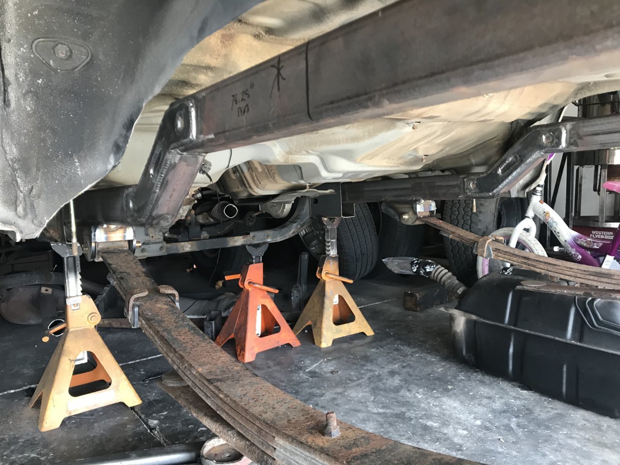

    1997 t4r has super duty axles, 5.13s locked front and rear. 3 link front with 14" kings. Rear 63s.

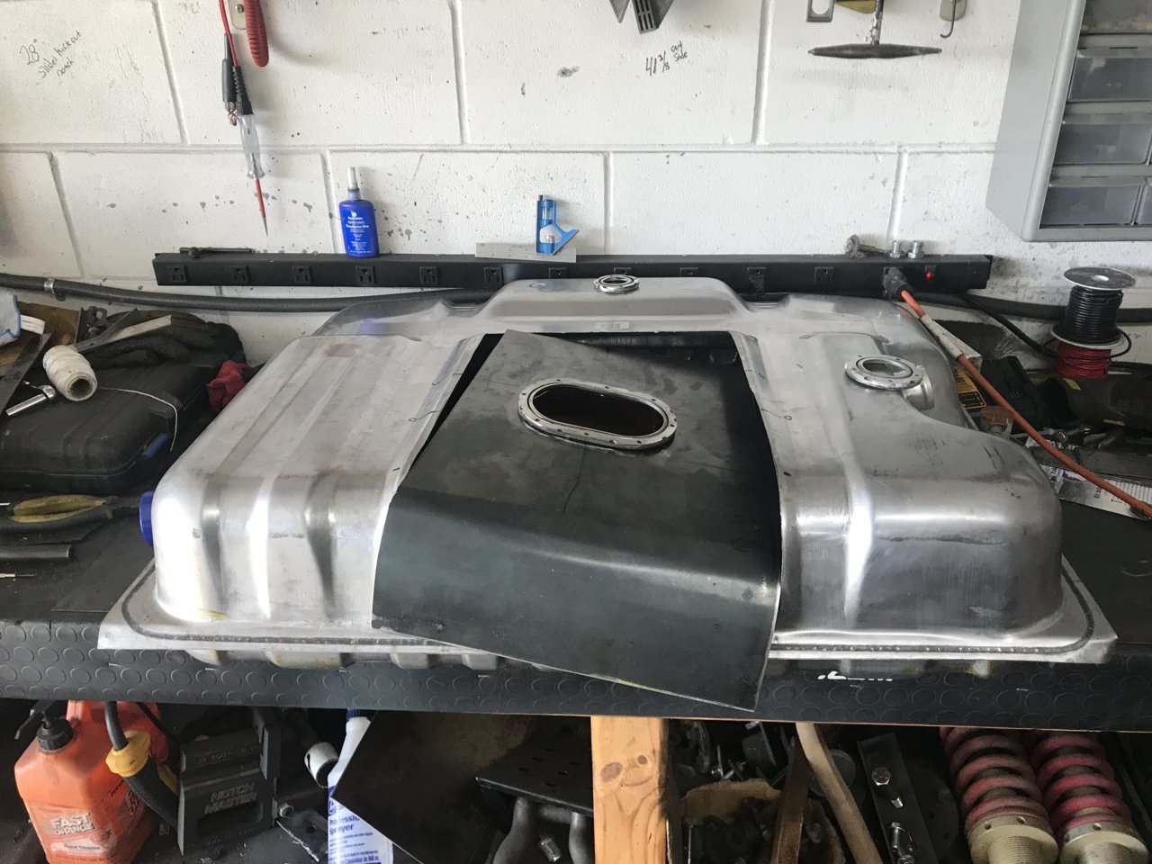

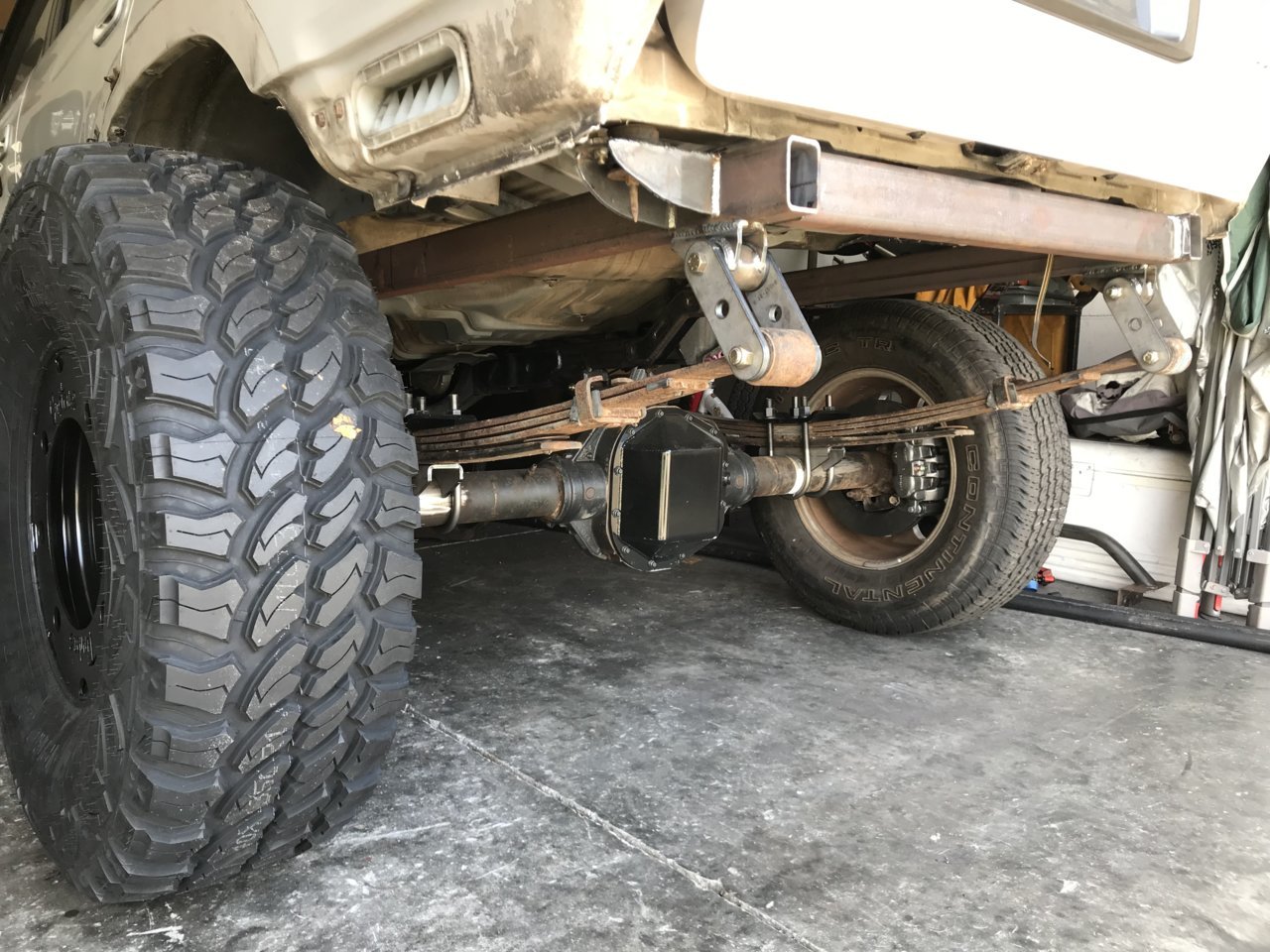

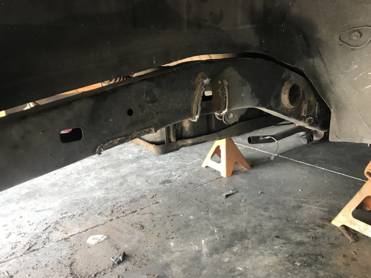

    Rear suspension is burned in. Need to set pinion angel and weld the perches still
    Started the f150 fuel tank mod, no pictures of the fuel sending unit modification but have everything but had to cut off the low level fuel sensor.

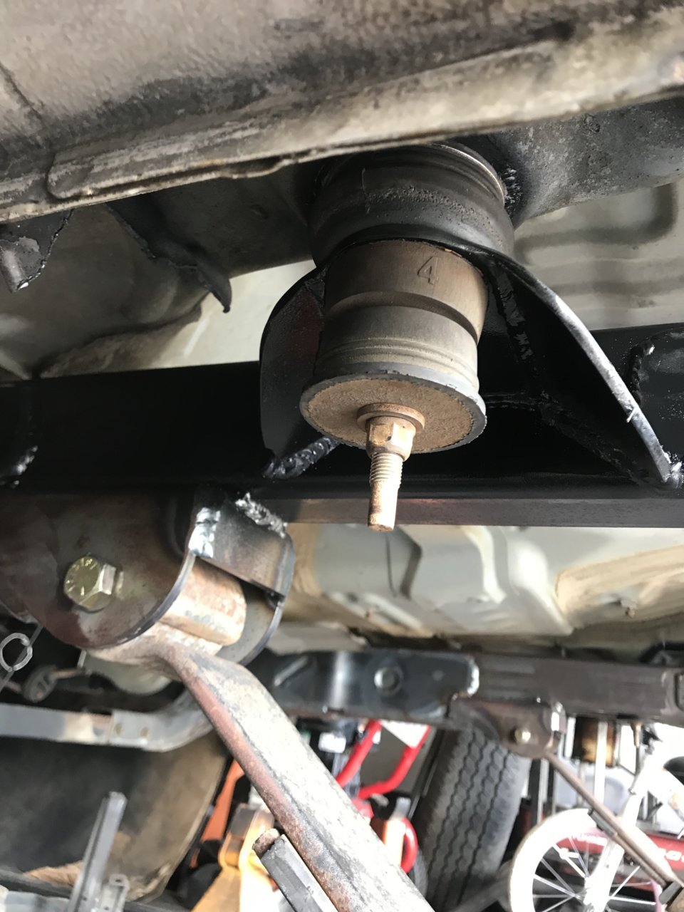

    Looks a little odd o_O

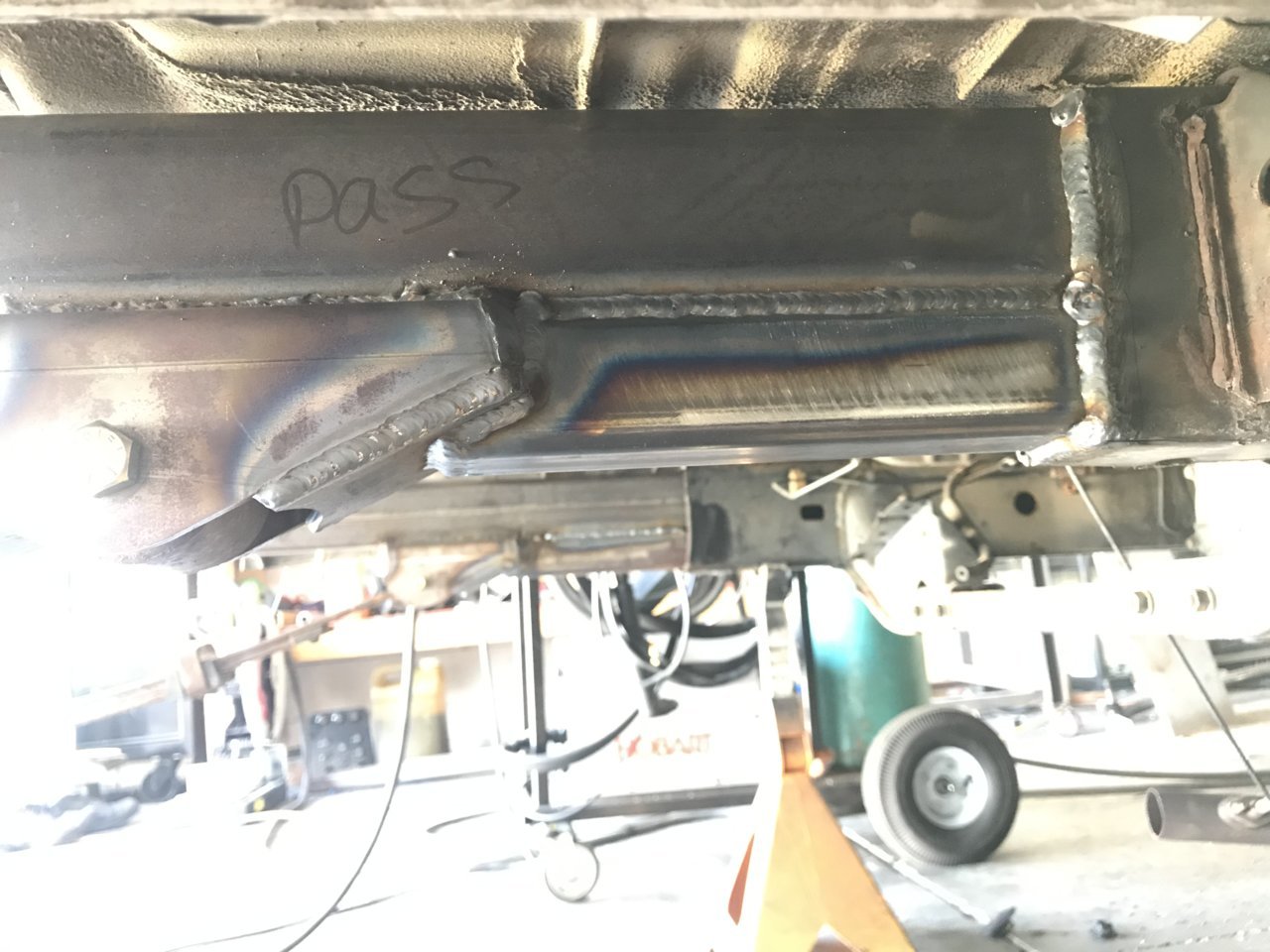

    I hope the frame splice isn't staying like that. Jesus christ that looks like a hack job :eek:
  18. Sep 14, 2019 at 12:07 PM
    #78
    TacoTRD78
    TacoTRD78 Well-Known Member
    Jul 27, 2015
    #160390
    6,749
    John
    Stuart,fl
    15 tacoma trd off road
    4X Innovations Sliders Tech deck Bilstein 5100's OME 885 CB radio install Rear diff breather mod After market front bumper lights Redline hood struts Shorty antenna door seal protectors Glove box/ Center console motion light Trailer harness plug relocation mod/Edit SOS HC rear bumper Ditch mount Lights with CBI brackets morimoto fog lights
    What about it looks like a hack job?
  19. Sep 14, 2019 at 1:50 PM
    #79
    Yetimetchkangmi
    Yetimetchkangmi Well-Known Member
    Jun 19, 2013
    #106605
    3,534
    Benjamin
    Newcastle, WA
    03 Tacoma 4x4 The Yeti
    ARB front locker, Custom high clearance rear bumper, Custom plate front bumper, mile marker winch PE8, safari snorkel, Deck Plate Mod Fox 2.5 rr DSC, Camburg UCA, squeaky Dakar leafs, 5125 10" and custom 7.5" shackles, thee finest PNW pinstripes, MT-R, Nissan crew cab roof rack??? wtf is that about??? Allpro skids, Rigid duallys President McKinley CB with PA Recaro SRD with Wedge Engineering Morimoto retrofits Champion Rad - Failed Tundra brakes
    the smaller part of the frame inserted into the larger opening of the frame...
    I cringed looking at that...
  20. Sep 14, 2019 at 3:03 PM
    #80
    Timbo's Customs
    Timbo's Customs [OP] Well-Known Member
    Aug 8, 2013
    #110078
    7,266
    Timothy
    Lakeland FL
    2019 f250 6”lift 37s deleted 1997 T4r, tons and 4ds
    Tell me what what you would have done differently then. It’s not doing being capped, still need to fill the openings you see. And I guess a few guys in pirate did a hack also
