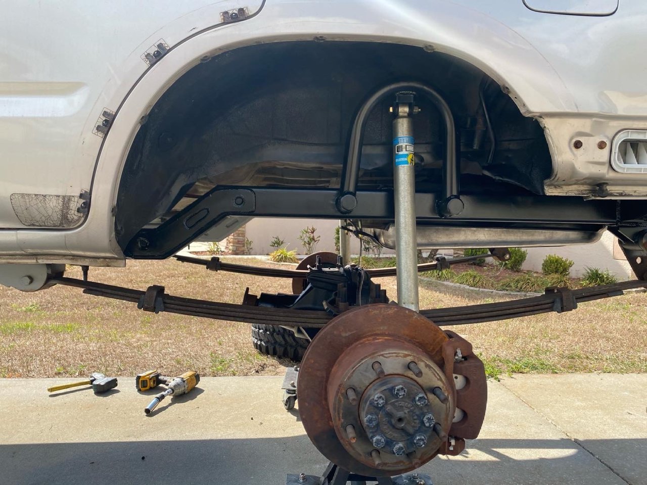

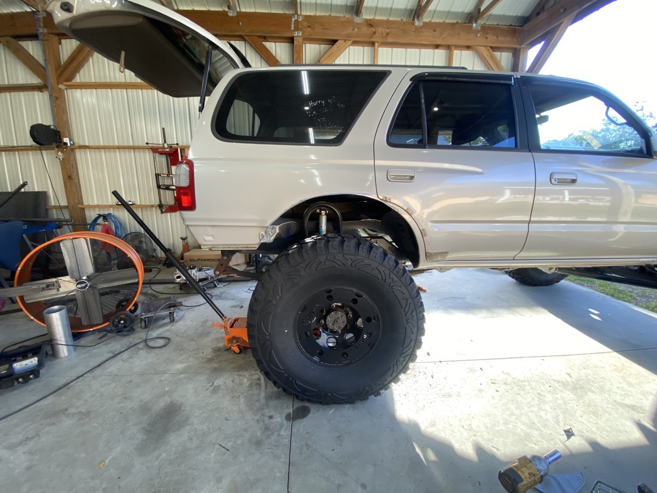

    Painted the back half. Got shocks on and got the fuel filler neck connected. Brake lines ran and fuel pump wired. Need to run the fuel lines to the pump, fill everything with fluids, go through everything and tighten bolts, hook up the hydro assist and bumpers

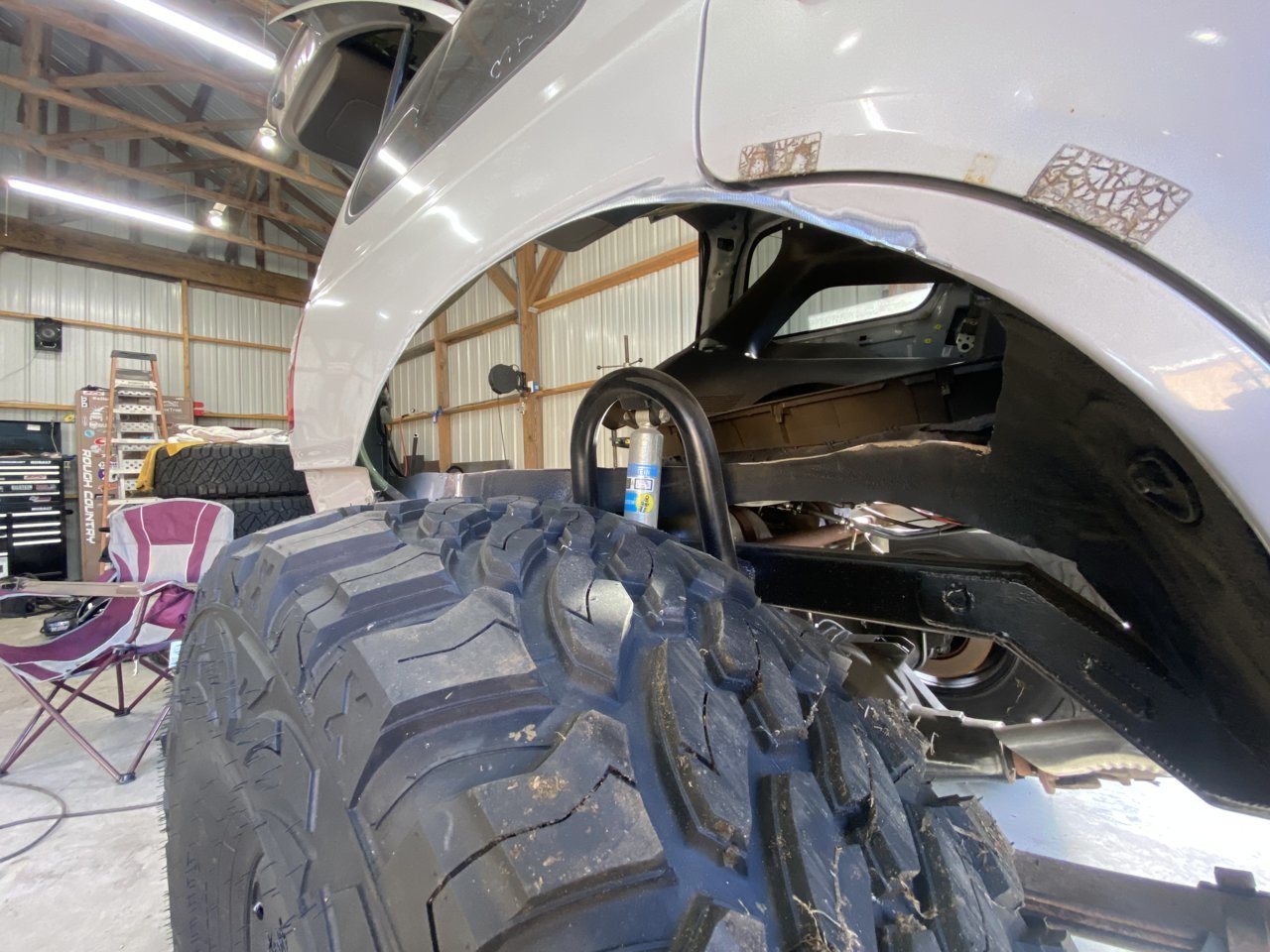

    Anyone want to come and do the tubs. I sure don’t

    Got any pictures of what that rear tub looks like all buttoned up?

    Just gussets... everywhere
    No prob! I will keep it though.

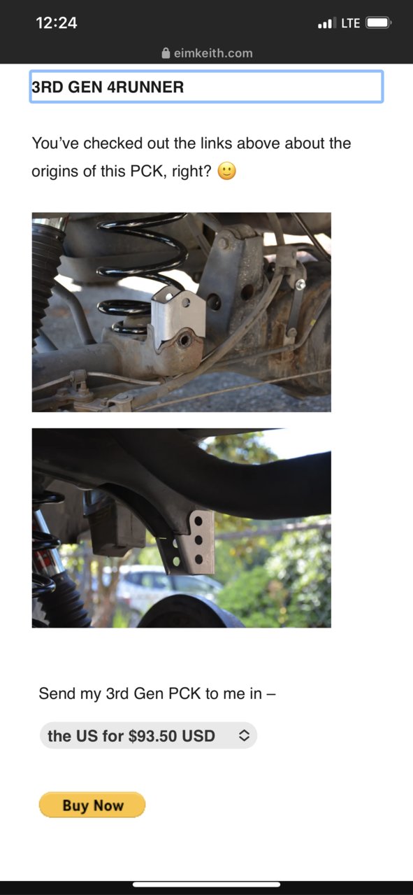

    also so it doesn’t clutter up Todd’s build and mine is useless at this point. Look at this company.

    This is why I’m planning on smaller axles. Trying to find a set of JK / JL D44’s because I only care to run 37’s, MAYBE 40’s down the road. Going to check out a 3rd gen runner Thursday that may be my sas candidate.
    I’m also planning to relocate the gas tank and go to a double triangulated 4 link on coilovers in the rear, which is why I was asking about your rear tub. But I’m also going to do a 1” or 1.5” body lift on it, which will help me to not have to tub as much.
