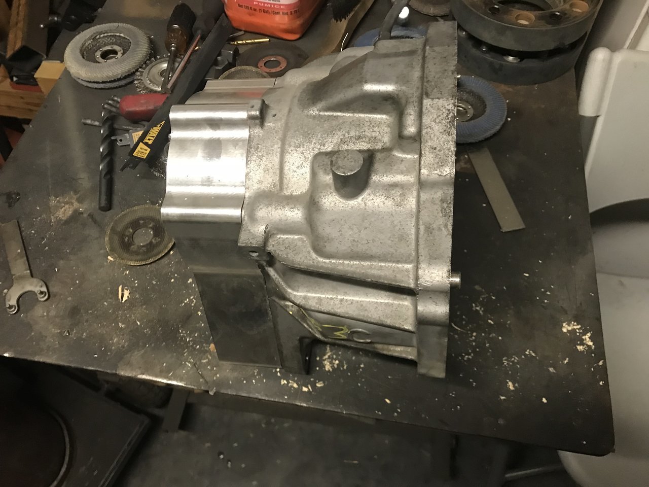

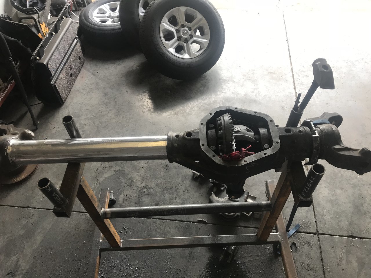

    I’ve been slacking. Axle tube cleaned up need to finish the driver side.
    One very important part came in today. A750f extension housing for the case to bolt to.

    Newb here what’s the extended housing exactly do?

    It bolts to the transmission. It allows the transfercase to bolt to the transmission. The 4x4 has a a750f transmission and the prerunner has the a750e which is a standard 2wd trans. The inchworm adapter allow me to bolt the 4x4 tail housing to my 2wd trans

    Ah gotcha. Makes sense now

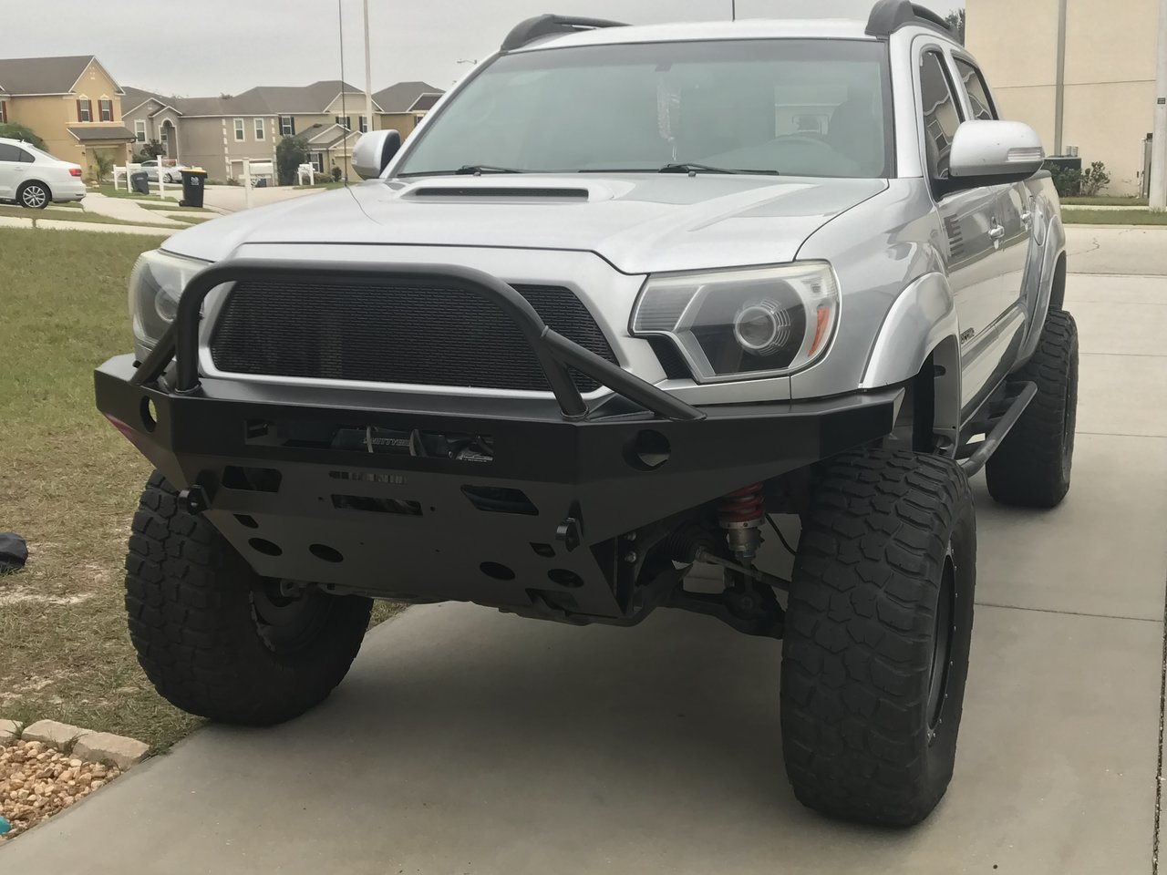

    Not much as happened to the truck. Think I have a u joint that’s going out but other then that I stripped the bumper down and re painted it. Never costing anything with spray bends liner again.
    Have to wire the winch mount lights and fair lead still
