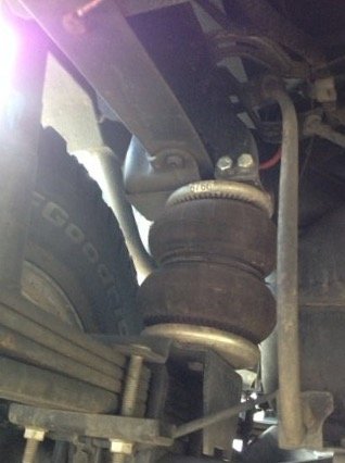

    Ideally I would like my bags to be inflated more without having like 50 psi in them !image.jpg

    I think the aal is going to be like putting a band aid over a bullet hole. It sounds like you rear leafs are extremely worn... For example I have stock leafs as well and at 15 psi in my bags I tow about 2500 pounds and the truck still has a lot of rack. 50 psi is waaayy too much...
